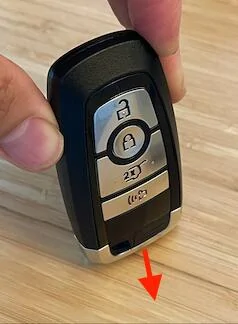

Tried everything and finally figured out that the owner's manual is more correct than it sounds: "Place the remote control in the slot as shown with the buttons facing upward." It's misleading but that means you have to disconnect the keys from your keyring so you can stick the keyring side in. Not sure if it matters, but we chose to put it in so the buttons were facing the rear of the car. Went through the process of putting both fobs in, and then it worked! The factory code was displayed on the dash.
