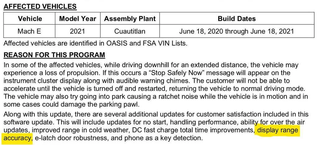

This happened on my Route 1 as well after the update, I took a trip Phoenix to Tucson right afterward, and used 49% of my battery to go 153 miles at 75 mph. So actual range was over 300, but GOM still read low when I arrived in Tucson (~120 miles remaining). The time constant Ford uses to compute estimated range is way too long, it does not compensate for current driving conditions at all.
My other EV is a Bolt and the GOM is much smarter than the Mach E. It changes immediately when turning the HVAC on or off and adjusts during a trip to current conditions, thus if you start driving at 70 mph on a highway, it adjusts fairly quickly to provide and accurate number for what is left in the battery. The filtering time constant on the Bolt is much shorter, thus making it more accurate.
In general, I only care about the GOM for the current trip, whether it is around town or a highway drive. That is why I prefer the Bolt GOM over the Mach E GOM. The Mach E takes weeks to adjust, whereas the Bolt adjusts in 15-30 minutes of driving. But in the end I have enough experience with both cars to know how far I can go.

"Whatever software update they did removed ~40% of my range capability."
No. It removed 40% of the indicated range. The distance the car actually drives is unchanged. Go try it. Charge to 100%, pick a location 85 miles from your car, drive to it, and drive back. You battery % will not be 0%.
