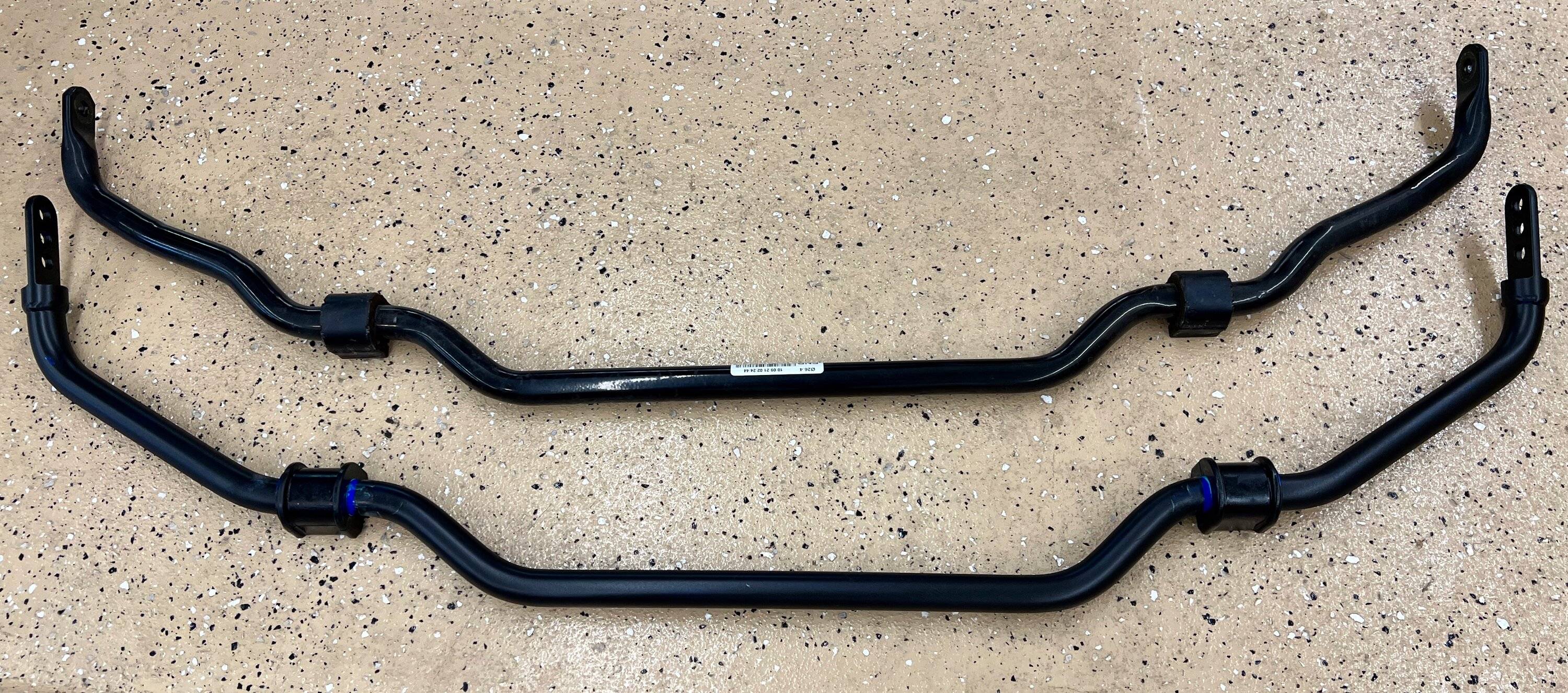

I saw this today, and have not seen anyone else post about it. I guess that means nobody on the forum has tried it yet?
https://www.steeda.com/steeda-555-1033-mach-e-adjustable-front-sway-bar
This seems like a @markboris project!
I am seriously considering doing this. I have the Steeda rear sway bar, still not installed. Maybe I will get the front and have them both put on at the same time. Or do them myself. The front looks a lot harder than the rear, though.
According to Steeda, the hole 1 rate is just slightly more stiff than the GTPE.

FRONT SWAY BAR | SPECIFICATIONS | HOLE 1 RATE | HOLE 2 RATE | HOLE 3 RATE |
GT | HOLLOW STEEL | 240 | - | - |
GT PE | HOLLOW STEEL | 288 | - | - |
STEEDA | 1" SOLID STEEL | 17% INCREASE OVER GT | 29% INCREASE OVER GT | 39% INCREASE OVER GT |

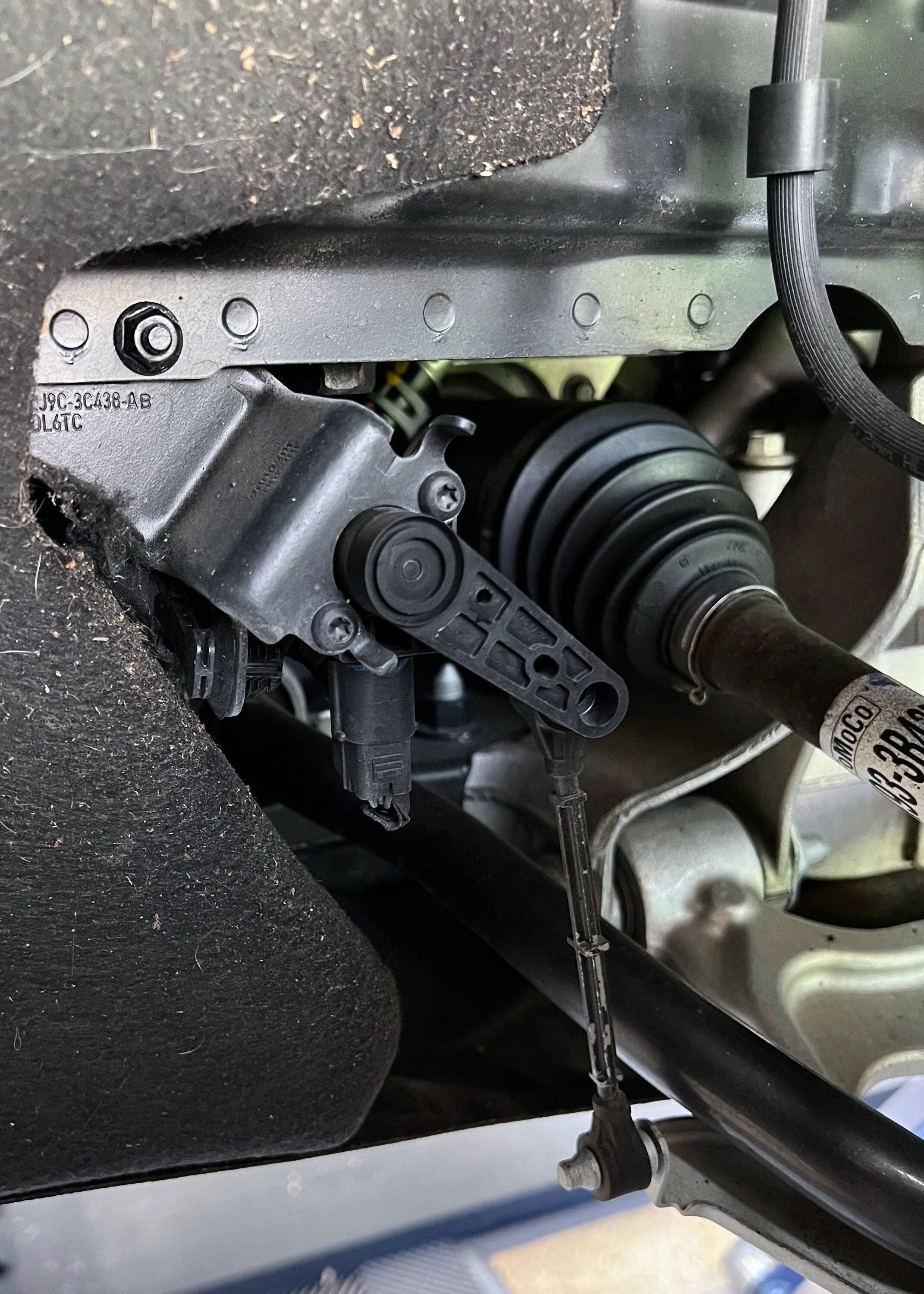

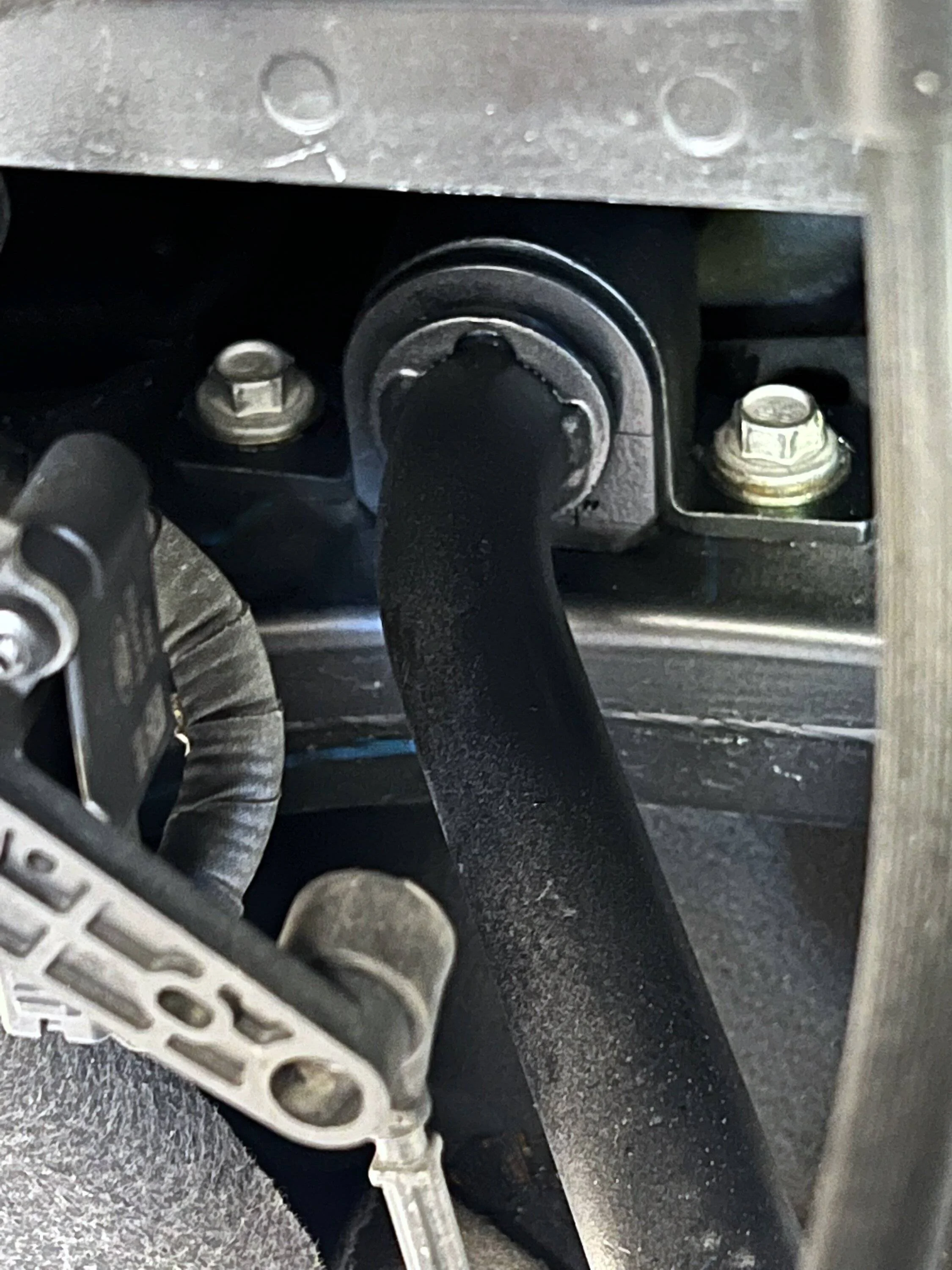

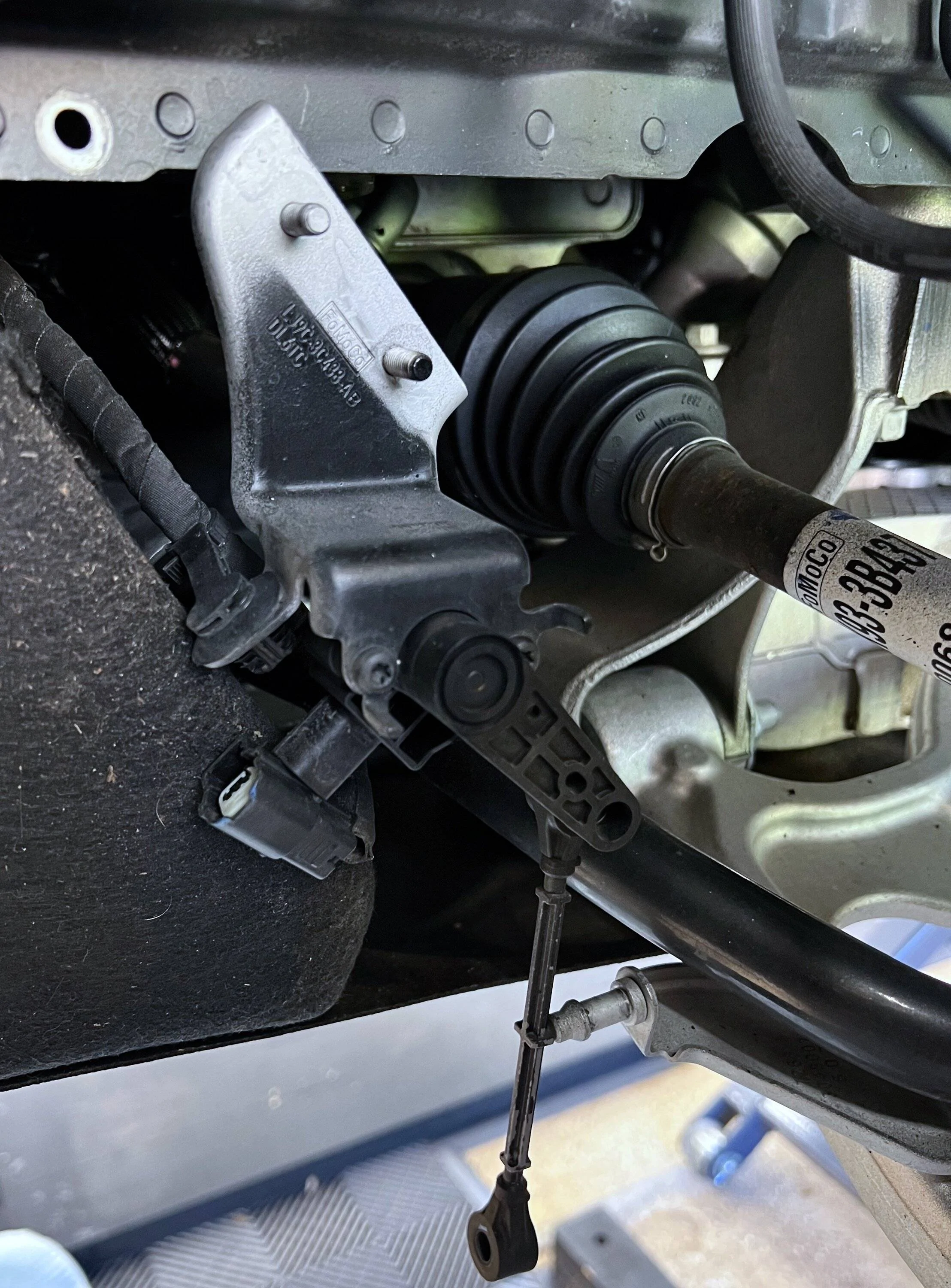

- The front sway bar can hit parts of the car due to lack of clearance. This was first discovered by Anton as he was the first non-GT installation reported on the forum. Tanner also recently found another area that lacks clearance, which he fixed by moving the position of the bar biased to the rear of the car instead of the front.
Antonās installation post (first attempted, and failed, Premium AWD ER installation):
https://www.macheforum.com/site/thr...-car-into-what-it-should-be.20263/post-496357
https://www.macheforum.com/site/thr...-car-into-what-it-should-be.20263/post-496418
https://www.macheforum.com/site/thr...-car-into-what-it-should-be.20263/post-497122
https://www.macheforum.com/site/thr...-car-into-what-it-should-be.20263/post-500662
Tannerās easy interference fix:
https://www.macheforum.com/site/thr...-car-into-what-it-should-be.20263/post-512015
Tanner found another area of potential interference:
https://www.macheforum.com/site/thr...-car-into-what-it-should-be.20263/post-562105
