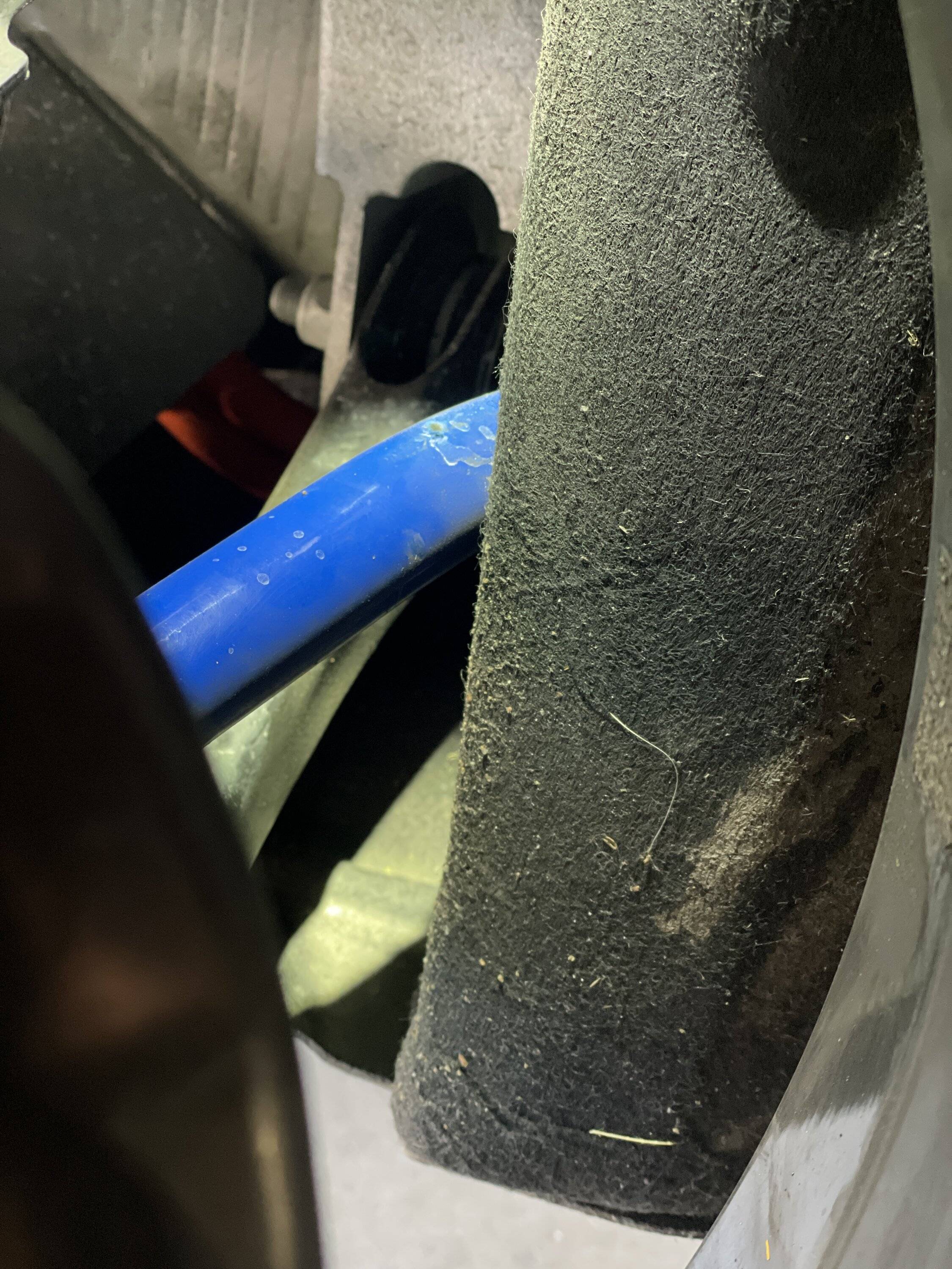

I just looked at my rear sway bar and didn't see any damage. Never heard any clanging either. My wife and kid always ride in the back.
See that little light spot furthest NE on the bar? Close to the black piece? Take a look again. I just got off the phone with Mark. Mine hits both sides.
NOTE: This is only when loaded and hitting something hard. I have purposely tried to sky this car to put the Koni's through some rough testing.
Here's mine, same notch on both sides. Bar set to softest, so it moves the furthest up. (I'm also 1 inch short on the bump stops for the rear shocks. I'm going to pull them and put my factory premium cut bump on them.)
Ford Mustang Mach-E Steeda Mach-E Adjustable Rear Sway Bar 70318679858__64B22D50-C810-4878-8197-757A44AA6BAB.JPG
Reality is I might tap these spots daily pulling out of the driveway with people in the back.

Well, this sucks. I threw away all the stock parts. I hope that wasn't a big mistake.
I plan to inspect both bars this weekend when I put the Konis on the rear. I hear noises sometimes from the front but I have not noticed rear noise. My bars are on the stiffest setting.

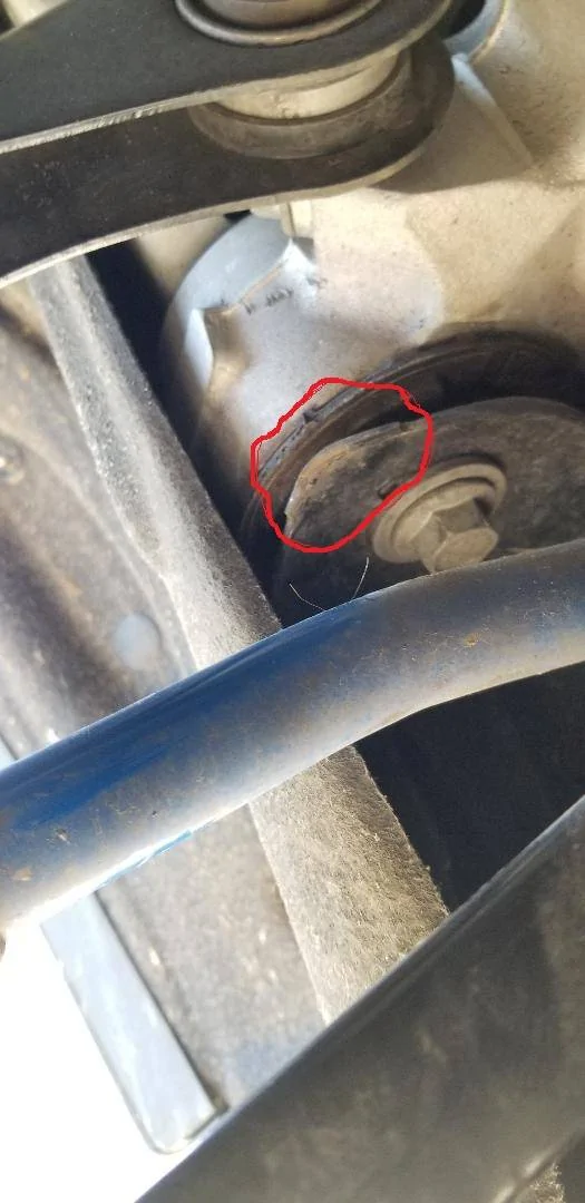

In case some did not read my post a couple of pages back, here was my rear bar with rub marks on if from contacting the body. #54 Shocks are stock but did add lowering springs which brought the body closer to the bar by half inch. I remedied this by changing out the rear OEM end links with adjustable ones and set them to about 3/4" longer than the OEM's. Just checked mine and looks like the body hasn't touched it since. That was two months ago.

I was hoping your issue was related to the lowering springs, and not the bars, and that my car would be OK.

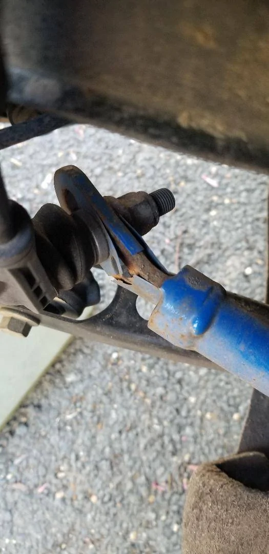

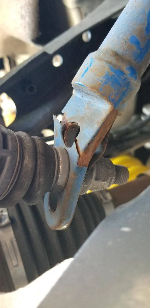

So I found this thread interesting because over the past two days I adjusted the spring tension on my KW v3 coilovers, and only in the rear. I wanted to set the ride height in the rear to the highest setting permissible by the KW design (not "the highest setting possible", just the highest setting within the KW setup instructions). In practical terms,this gave me another 1/4 inch of added height in the rear.
My KW coilovers have been on my Mach E since December 2022, or for about 16 thousand miles. I had two separate well-rated shops perform alignment on the wheels, all within the 1st 2 thousand miles.
My car is an AWD with the extended battery, so it's the heaviest variant of the Mach E. It now has over 31 thousand miles on the odometer. I installed the Steeda anti-sway bars back in Summer 2022, when the Steeda bars 1st came out and several thousand miles before I threw the KW coilovers on.
Of note, I put a lot of miles on my Mach E this past year, at times in Winter snow and ice road conditions around Lake Superior.
While adjusting my rear KW springs for a higher setting, I found two damage areas on the Steeda rear bar:
1. A notable bend in one end of the bar where the mounting holes are. I have no idea how this got there, and the only explanation I can think of is some severe ice ridges I remember driving over on a country road in northern Wisconsin. The attached pic 1 and pic 2 show the bend on the end of the bar, from the bottom looking up and from the top looking down. NOTE: this bend is only on the passenger end.
However this bending happened, I welcome comments and thoughts going forward, i.e. "live with..." at least for a while, or take the bar out and straighten it, or swap out with a new bar? BTW the endlink seems fine.
2. Paint notches on both ends of the sway bar, on its top side, which look exactly like the paint notches in the pic within markboris's Post #54. Ditto for a corresponding flattening of the circular lip protecting the big body bolt, right above the bar, again on both sides of the car. This damage is shown in the attached Pic #3, with the red circle around the flattened lip part on the car's body (looking up from below).
I do remember a slight occasional judder-type noise from the rear end, only during hard acceleration, that started after I threw the KW coilovers on. Now with the rear raised 1/4 inch by compressing the rear springs more, this WOT judder is gone. So, I guess the car tends to "squat" just a tiny bit under a Wide Open Throttle, and the lowered posture after I had thrown the KW coilovers on allowed this interference... now eliminated by raising the rear end's height.

That looks pretty bad. I have them set on the softest setting. Have to remember to check it out to see if I have any issues.
If so, wonder if it’s time to put old ones back on and then put koni shocks on

Was on the phone with Erik earlier today discussing this rear sway bar issue. I’m fairly sure mine was happening because I lowered the car about 1/2” with H&R lowering springs. Erik said his contact the body (same spot) when he has passengers in the rear. Anton also has this noise only when passengers in the rear. Erik and I are convinced that Steeda tested the bars with only a driver and not a fully loaded car. I have since installed longer adjustable end links in the rear and no more noise or contact.
