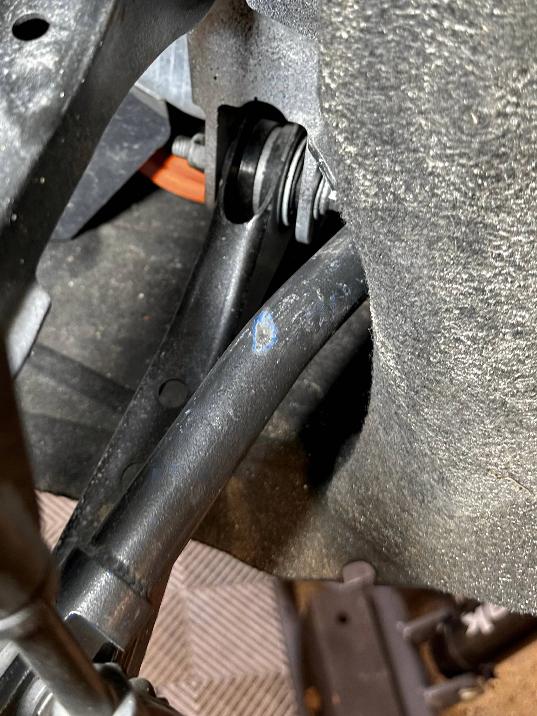

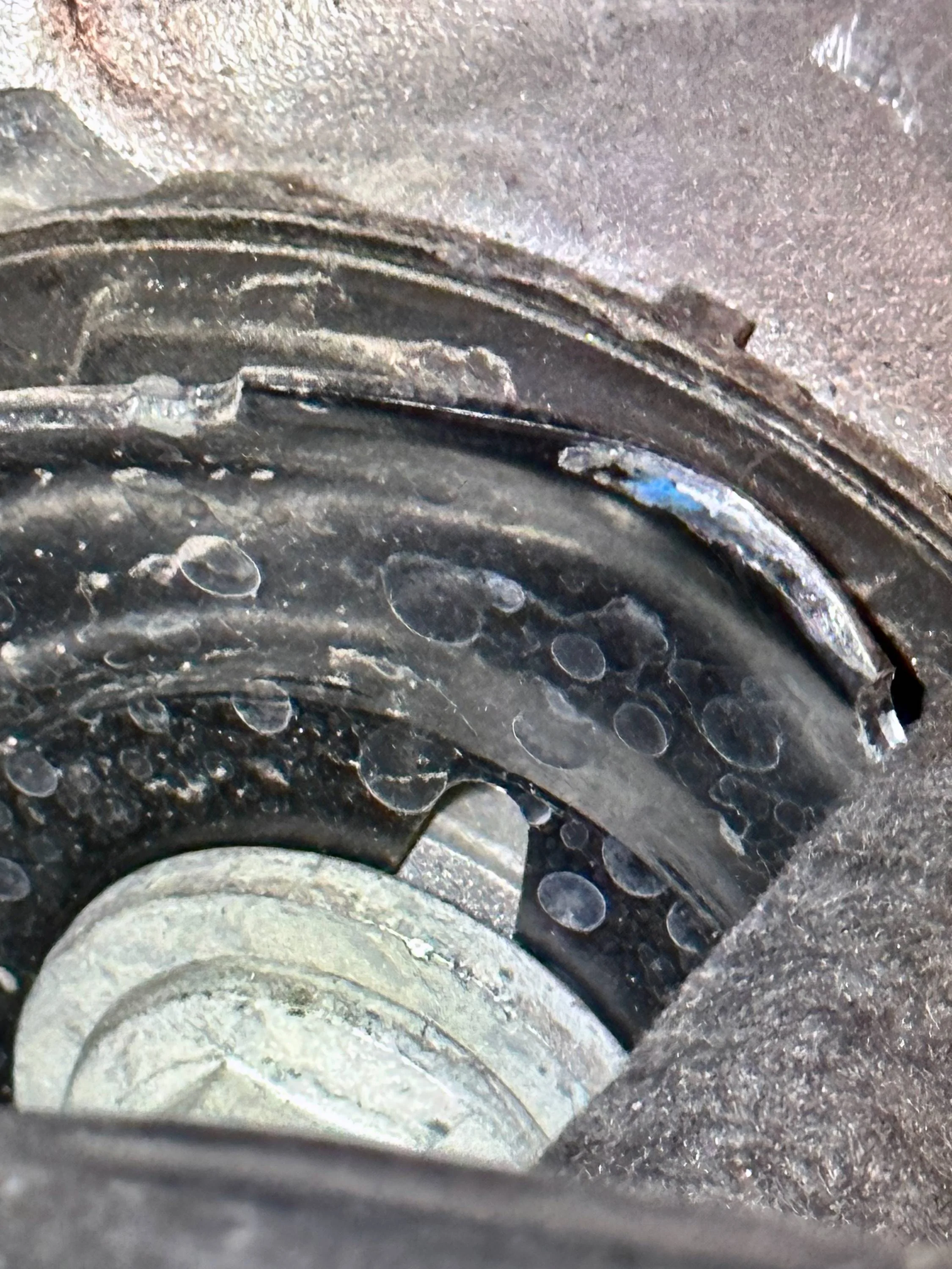

While messing around with the rear suspension today (fitting Koni and Bilstein shocks), guess what I found????
I came across the reason why I would get a faint clunk, clunk, when going over irregular road surfaces with passengers in the rear.
I painted my sway bars black (over the Steeda Blue) and you can easily see on the bar where the black and blue paint is worn off and bare metal showing. You can also see a touch of blue on the upper body part where the bar is contacting it. Looks like I will be getting some rear adjustable end links as they need to be a bit longer than the stock ones. I'm assuming Steeda never tested this rear sway bar with a fully loaded or lowered car?

No Ken, did not and will not cause any real damage. It is just barely contacting the edge of a body part which is really no big deal. There is no way I would put the OEM bars back on. Both the Steeda front and rear bars made a substantial difference in the handling and minor difference in the ride and have no plans to ever change it. I have lowered my car about an inch with the H&R lowering springs. That in combination of having a car full of people and luggage in the back is what I am sure caused this to happen. Easily fixed by getting a slightly longer end link. When I am done messing with the suspension I will check what length I need but it won't be much.

I wouldn't expect you to have any as you haven't lowered your car as I have (even though it was only an inch). Glad you checked it out though to see if there were any issues. ?

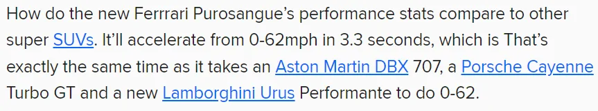

Ferrari's new SUV car thing comes in at ~4400lbs and doesn't use sway bars at all. The shocks have little electric motors in them and it keeps the car completely flat in cornering. They decided against corner lean-in as they said it was unnatural feeling. Of course the shocks look expensive as hell. They operate at 30hz and are apparently fast enough to dip in and out of pot holes (20mm of shock articulation at the shock, probably closer to 28mm at the wheel itself) though 'baby' potholes by the articulation range -- no travel speed mentioned on the baby pothole capability. Ditching sway bars w/ an active suspension would be badass though.

If only replacing the rear end links was easier! I recall that was by far the hardest part of the whole job...
They are a pain because of the tight area you have to loosen and tighten the nuts to the end link. Some patience and special tools make it a little easier.
This was all my fault anyway. I knew when lowering a car you should recheck other suspension components and one of the first would be the sway bars. I've ordered adjustable end links for the rear and will lower the end of that bar about 1/2" which will then never contact that body part again. I checked the front and all is ok there. I readjusted one end link on the front to relieve the slight bit of tension on the bar that must have occurred after lowering it.
