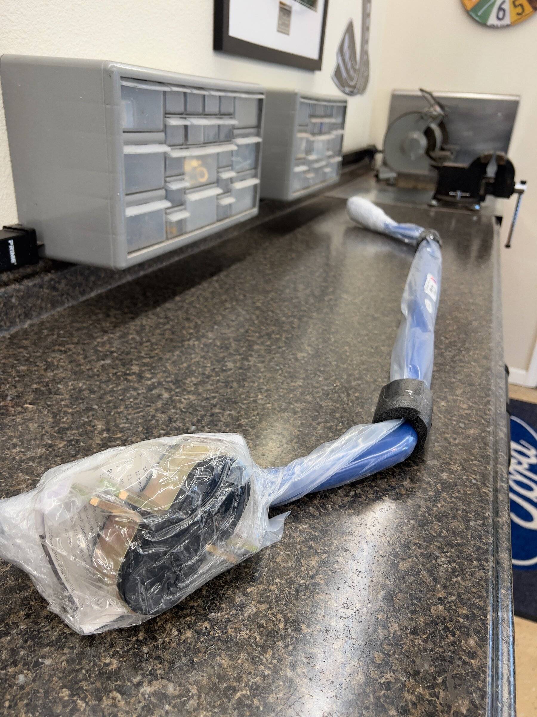

I've had my Steeda rear sway bar on a couple of days now and have been testing it out. I will get to the bottom line first, it really helps the handling!

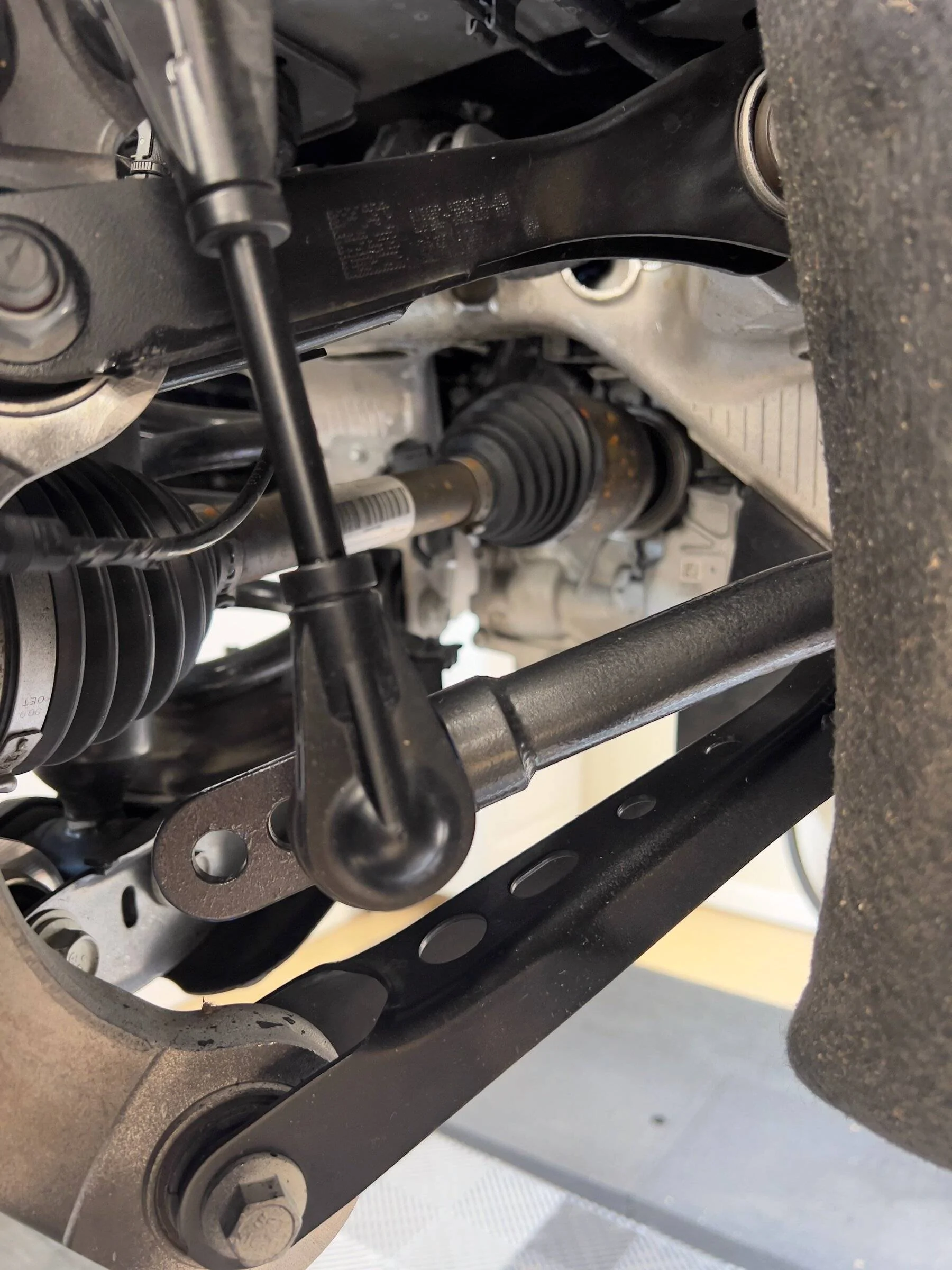

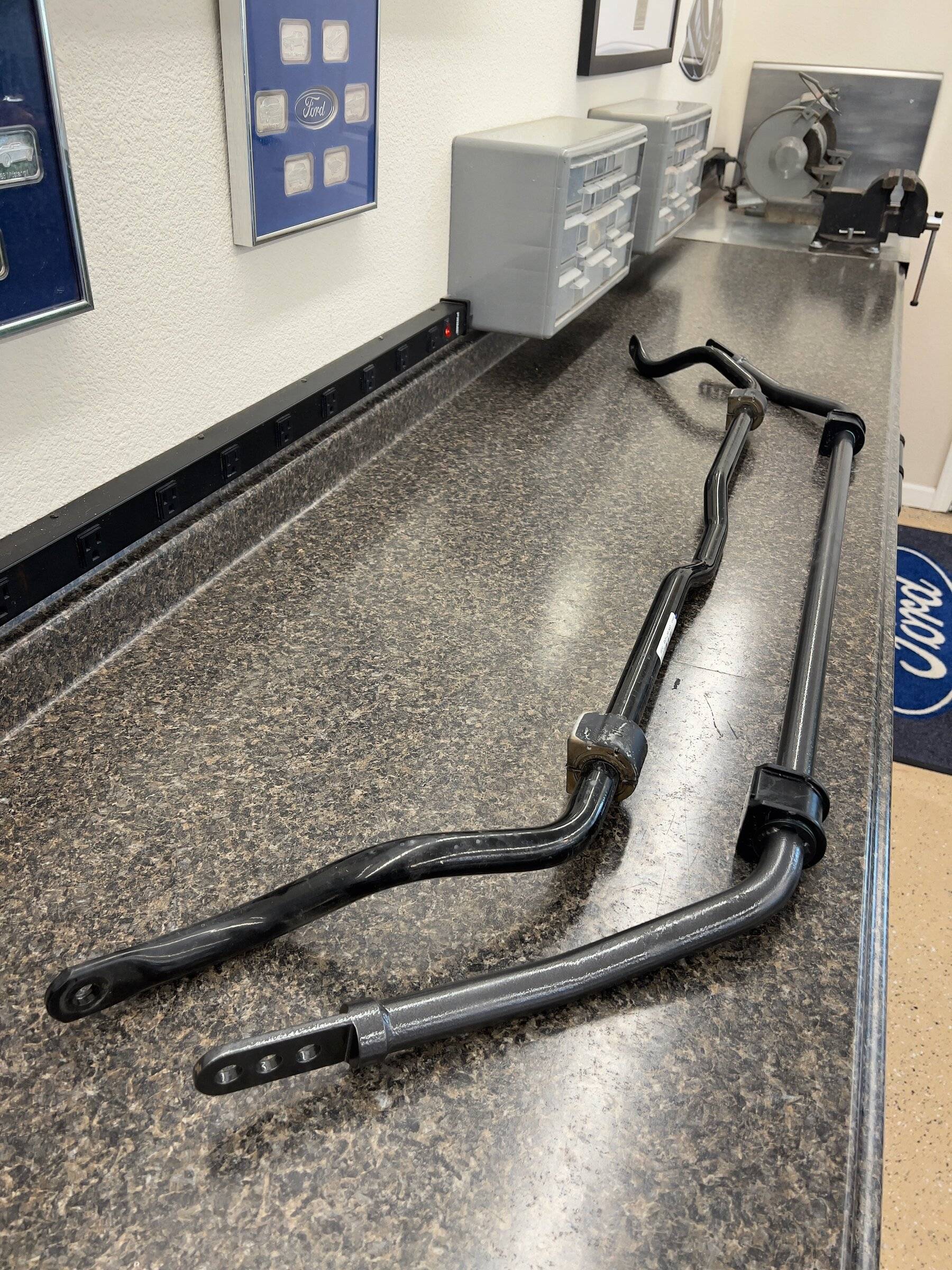

I'll start out by saying I have purchased many Steeda suspension parts for several of my cars (Escape, Focus RS, GT500) in the past and they are all top rate. I didn't follow the installation instructions that came with the kit. I had earlier looked at the Ford repair manual and it was very simple. Lift car up off the ground, remove the rear underbody shield, remove the two nuts on the end links that are attached to the sway bar, remove the two brackets holding the sway bar on to the body and slide the bar out. I did this and the bar came right out.

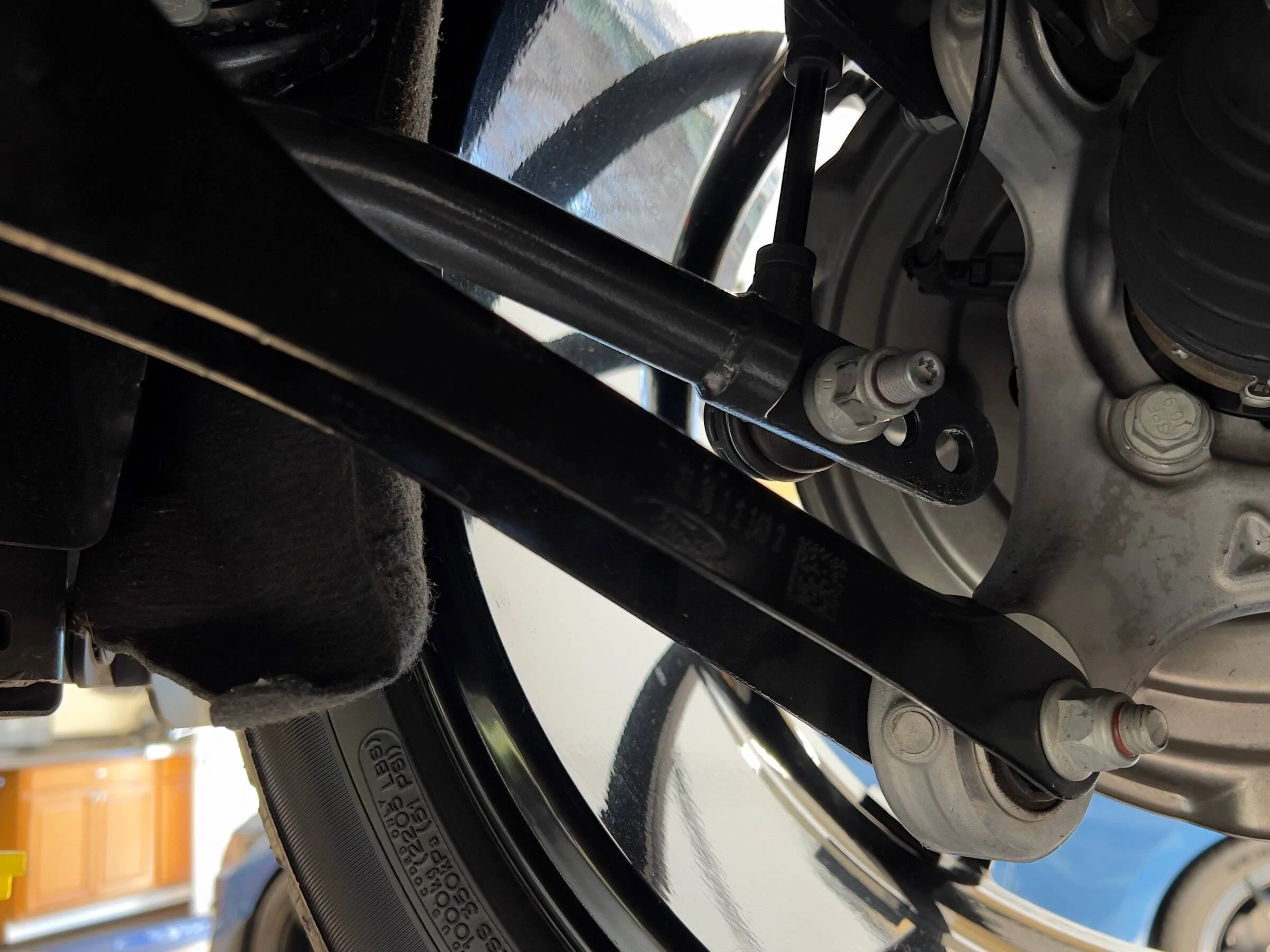

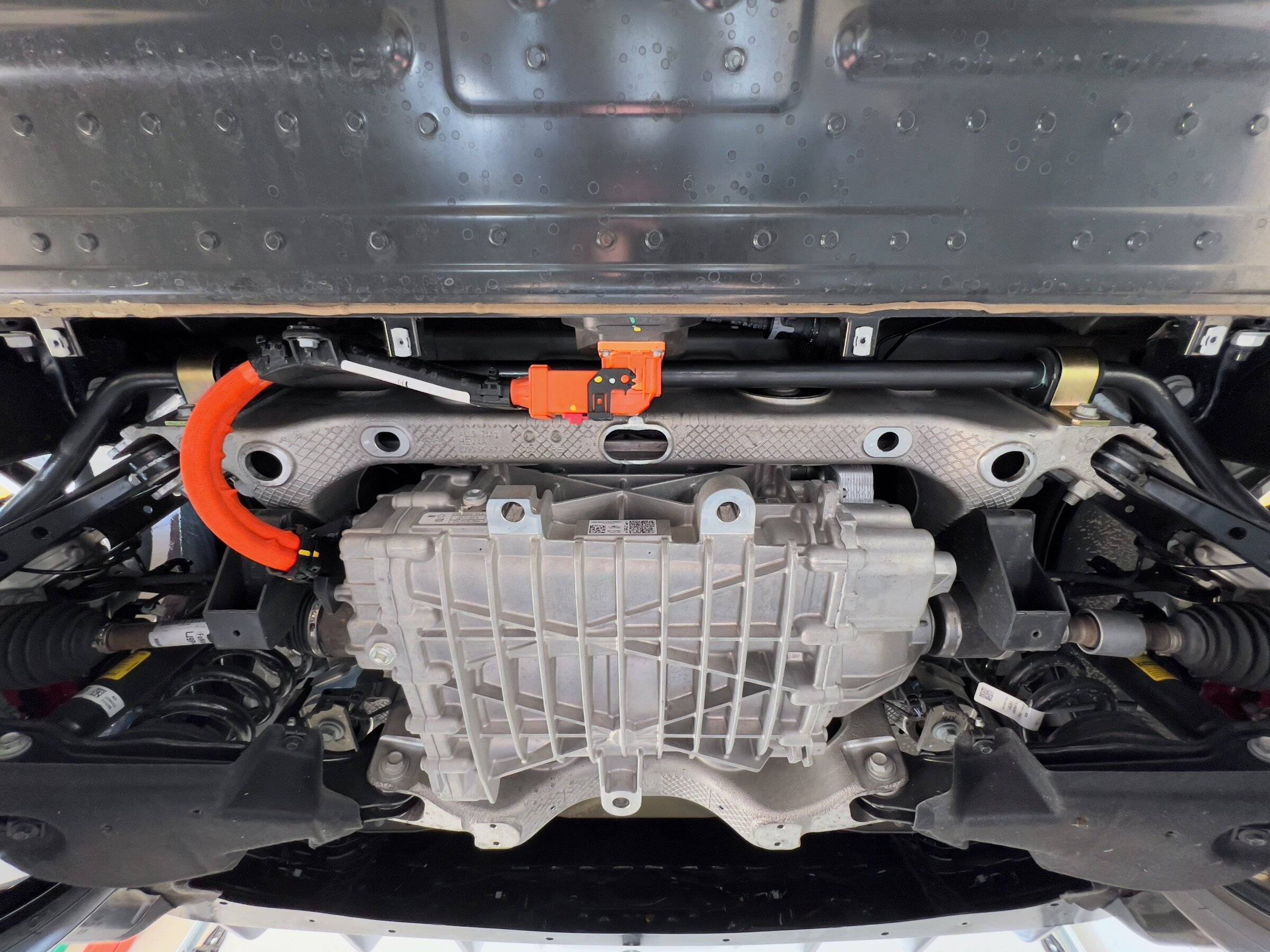

The Steeda instructions were to remove the right rear wheel, remove knuckle side bolt to right control arm, loosen chassis side bolt and lower right side control arm down, release the lithium-ion battery service connector and the two nuts on the cable bracket and position cable out of the way. I didn't want to mess with disconnecting the battery cable nor the control arm if I didn't have to and I didn't.
The Steeda sway bar is a slightly different shape than the OEM bar and it didn't want to go in as easy as the OEM bar came out. It was getting held up on the tire. Not sure if it was because I have wider wheels and tires but I removed the right rear tire and the bar went in. Still didn't have to remove the battery cable, bracket or lower the right control arm. I think the reason Steeda wants you to take the extra steps is to make it very easy to just drop down the bar and pop the new one in but I didn't find it difficult to maneuver it out with out doing this. The OEM bar is 27mm, hollow and weighs 7.6 lbs. Steeda bar is 32mm, solid and weighs 13.7 lbs.

I painted the bright blue Steeda bar hammered black. I am not into colored suspension parts. Yes, I have bright red brake calipers and still haven't decided if I will be painting them black or not.
There are three settings on the Steeda rear sway bar. They recommend the softest setting even though in their instructions they show the end link attached to the middle setting. I started with the middle setting (never tried the softest) and drove the car around quite a bit for an entire day. This thing really flattens out the handling. I've driven over 4000 miles prior to adding the bar so Iā€˜m familiar with how it handles. With the OEM bar, the rear end always felt like it is lifting up a bit when cornering hard. While I definitely push the car, I don't push it real hard. I am not tracking or auto crossing it. I am driving spiritedly on the mountain roads we have around here. Yesterday I changed to the stiffest setting and I like it even better but haven't driven it a lot.
I think with the narrower 245/45/20 OEM tires on the car, Steeda is right in saying they recommend the softest setting as you might get the back end to come loose. However in the rear, I have 20ā€x10.5ā€ wheels and wide 295/40/20 high performance all season SUV tires and it takes a lot to get that back end to move out. I will be keeping it in the stiffest setting and see how it goes in the wet as it might be too much. If it is, I will put it back to the middle setting but I know it will be one of the two settings I will end up with.

I think Steeda wanted to make sure of two things. One, take off the right wheel and lower the right lower control arm down to make it easier to install their sway bar and two, remove the HVB connector and brakes so as not to damage it if you are rough with the installation.
As long as you remove the two bushing brackets BEFORE you try to take the sway bar out, it will come out just fine and wont damage the HVB connection or cable. As I said, I did end up removing the right rear wheel because their bar is a slightly different shape and wouldn't go in as easy as the OEM bar came out.
