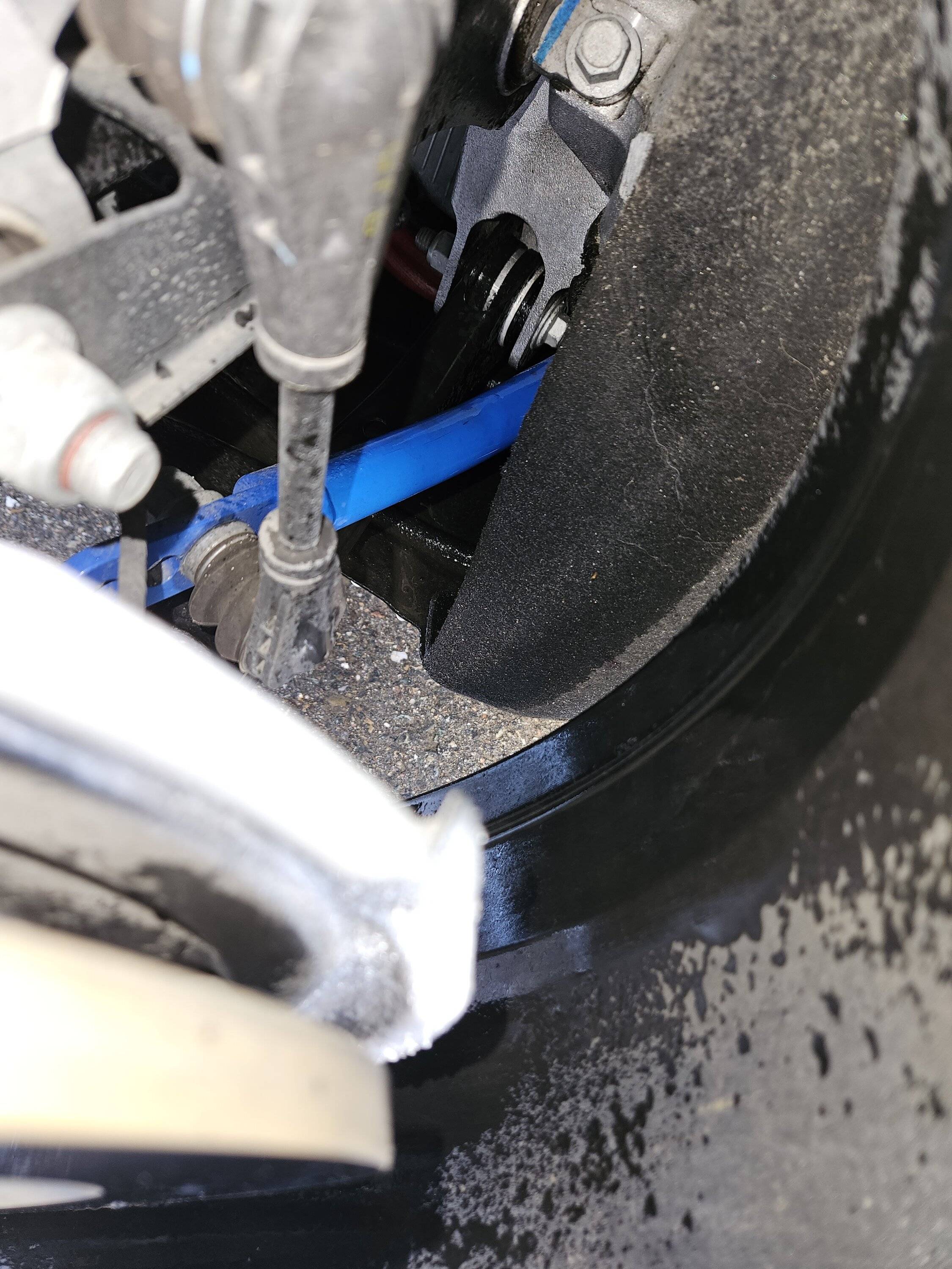

I've only recently started to notice a thud (knuckle to wall sound) on the back right. My wife sits in the back right with the kid in the carseat in middle. When I'm by myself, no sound. Might be able to see a split starting to form on the NE of the bar in this picture. Can't tell. Time for me to buy a jack.
The bar is solid steel. It won’t be a split unless something terrible happened.
After further inspection of the sway bar I found no signs of hitting. I believe the noise is coming from the (plastic?) rear hatch panels on the right side.
