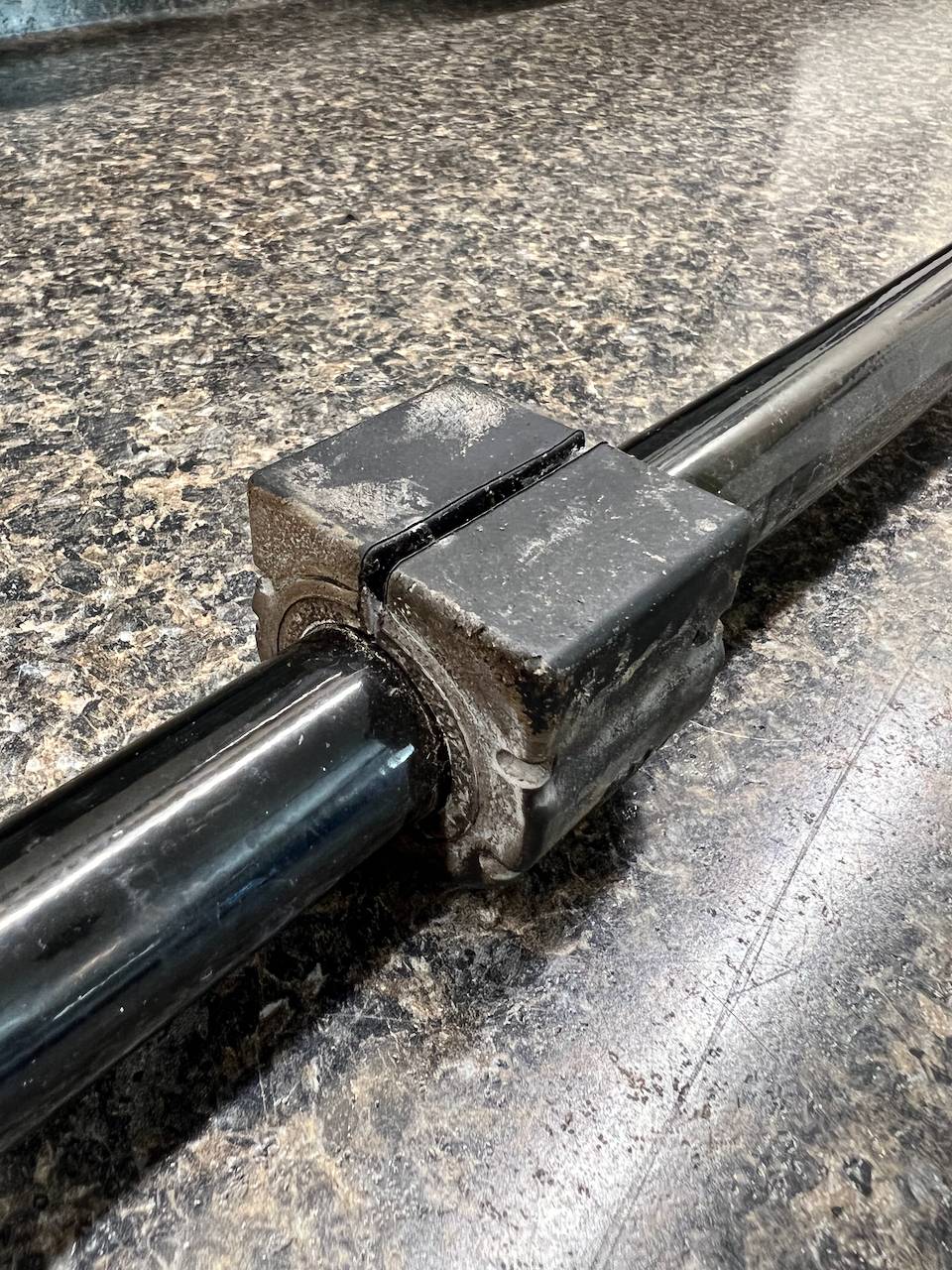

Hey @markboris I'm just going to lube up the stock bushings. Is it possible to just take off the bushing straps and peel the bushings off the bar or are they not split bushings that have to be slipped on?
While those bushings are split, it is not like they just pop off. There is a metal spring retainer vulcanized inside the bushing holding it tight against the bar. They don't slide and trying to split them open is very difficult. Not sure why Ford designed it like this. Never seen a bushing so tight around a bar before. It's not going to be easy to move them or get under them to grease.
In the photo below, you can see an outline of a circle close to the bar. That is a metal spring holding that bushing tight against the bar.
