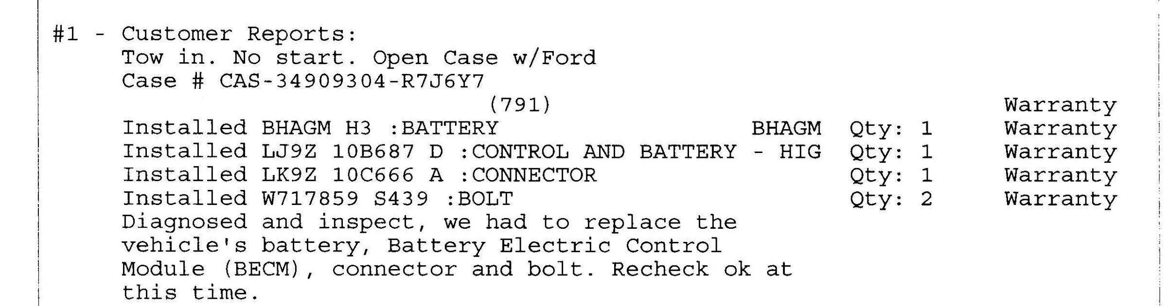

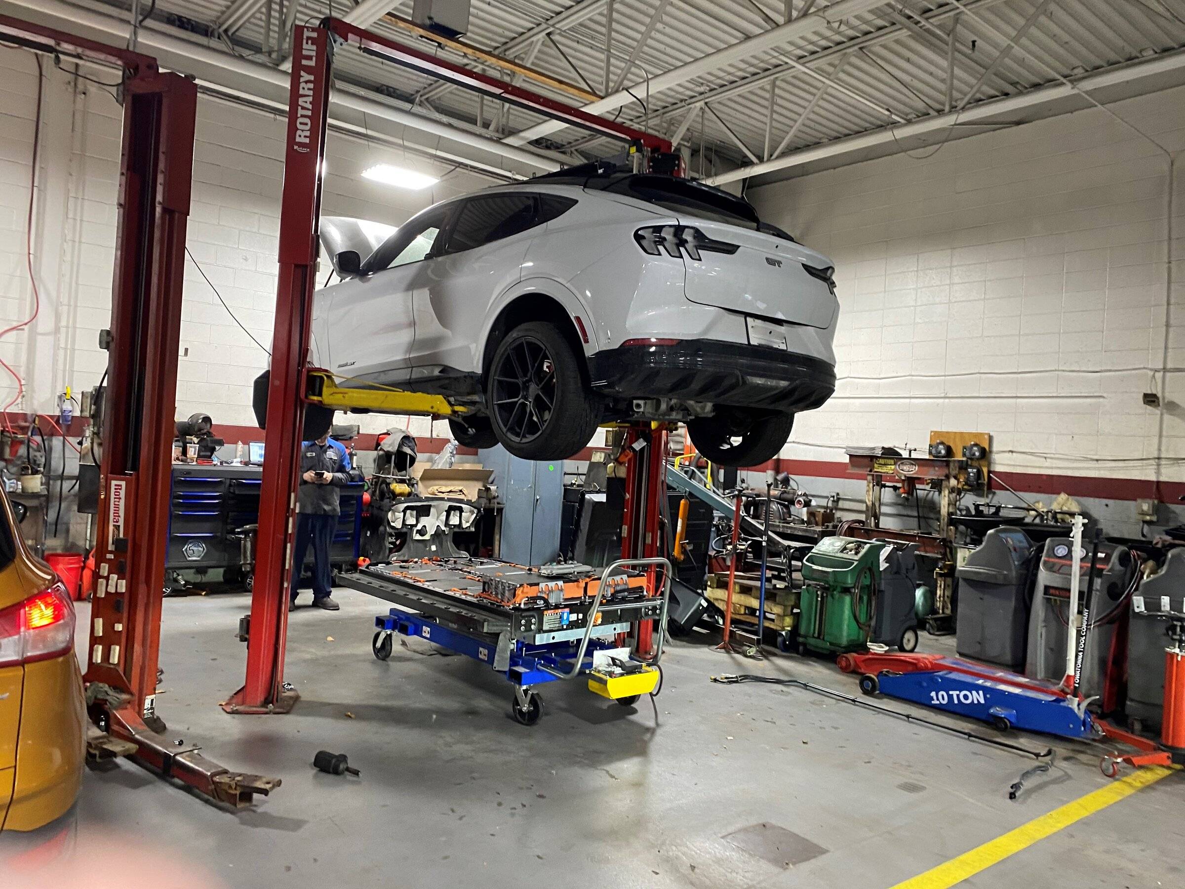

Got our GT back yesterday. Was ~7 weeks from dead to back in my hands. ~3weeks of that was waiting for parts want to say. Replaced LVB Battery, HVBJB (noted as connector), and BECM. Believe the junction box was the hold up , but had the becm in a week. I did open a case with @Ford Motor Company here at the start of it all, and the rep i got connected with did supposedly work with my dealer to expedite parts… so if you haven’t gone down this road it can’t hurt to reach out.
Time will tell if this was the long term fix ?.
