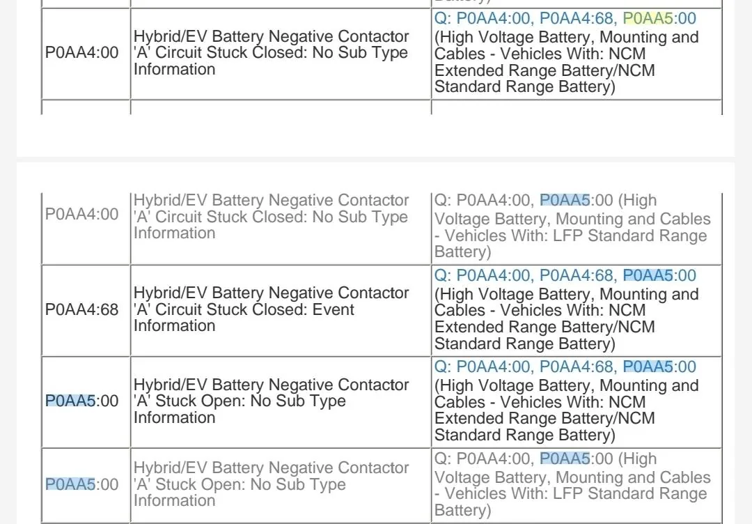

They scanned it already on Monday and should have a diagnosis. You had a P0AA5 code in the BECM (negative contactor stuck open), which means your HVBJB has failed and needs to be replaced. The dealer should perform the procedure outlined in TSB 24-2017.
Print that TSB, hi-light that code, and hand it to your service advisor. Tell them it says you need a the high voltage battery junction box replaced because you have that code.

P0AA5 was there on Monday when it came in, but then they cleared the codes out right afterwards without looking at them carefully. You have different codes now because the 12V battery is low. Just make sure they replace the HVBJB or you’ll be back.
