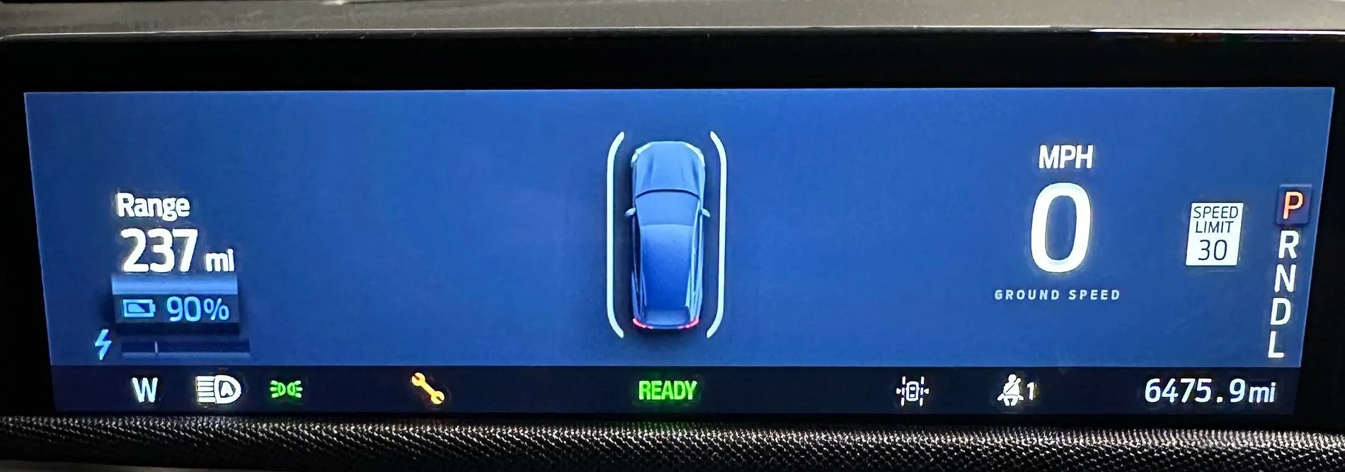

Have received the same error but the car was not charging. Ran errands, parked in driveway, and walked away for an hour. Jumped in the car to pull it into the garage and received the Powertrain Malfunction/Reduced Power error. Have followed the instructions in the link above with no luck. Before pulling the LVB, would a factory reset work? Car seems to drive fine and charges fine off our ChargePoint. Called dealership (actually called closest four!) and earliest date for an appointment is Nov 5. Thanks in advance!
VIN: 3FMTK4SX3PMA75464
Since you have a GT, do you have 21 jail bars? If so, it is likely an HVBJB. If not, it’s probably not the HVBJB. ??

No jail bars or any other "weirdness" besides the warning on start and the orange wrench. Manufacture date is 08/23 so I think it has the "fix" straight from the line.

The LL9Z-10C666-C HVBJB wasn’t cut in until mid-November of 2023, but this isn’t your problem. O
If you have an OBD-2 reader, you should pull your DTCs. ??

Gotcha. For some reason I thought anything past summer retooling. Scanner on the way. Thank you!
