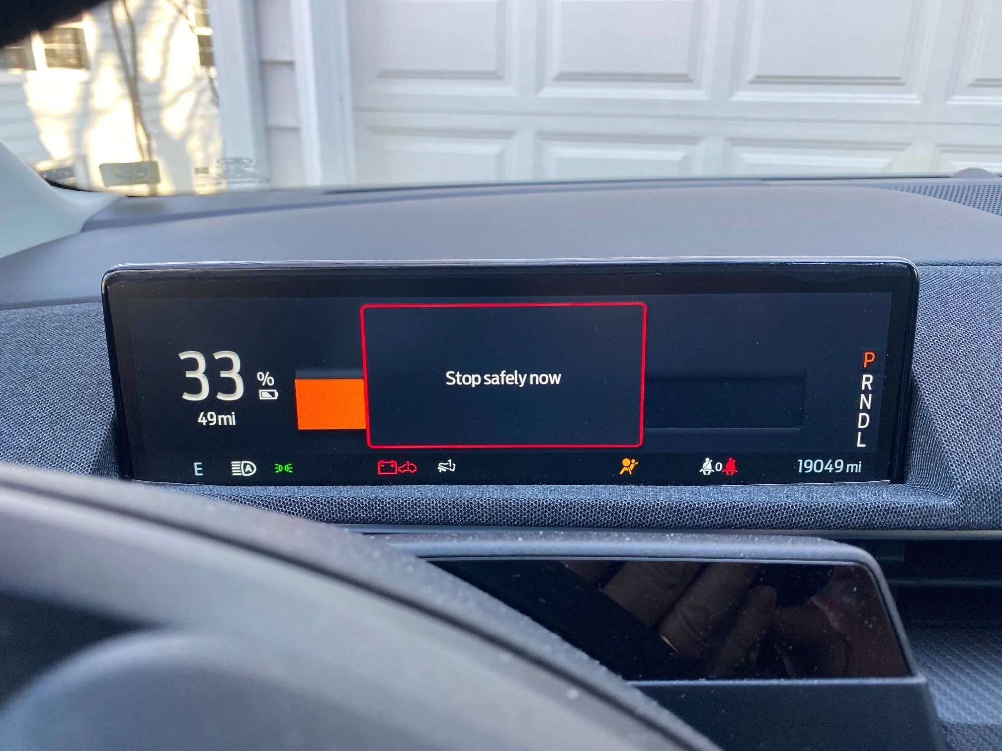

I kept the car plugged in at my sister's home on Level 1 charging. Temps were ranging from the mid teens to mid 30s (cold, but not absurdly cold). On Saturday night, got a charge fault error while at 33% SOC. Went to try unplugging and plugging in again, and had a red ring at the charge port indicator. Got in the car and started it up. The "Stop Safely Now" message popped up and the car wouldn't engage (I couldn't get it out of Park). I went to bed hoping that the car would reset itself overnight.

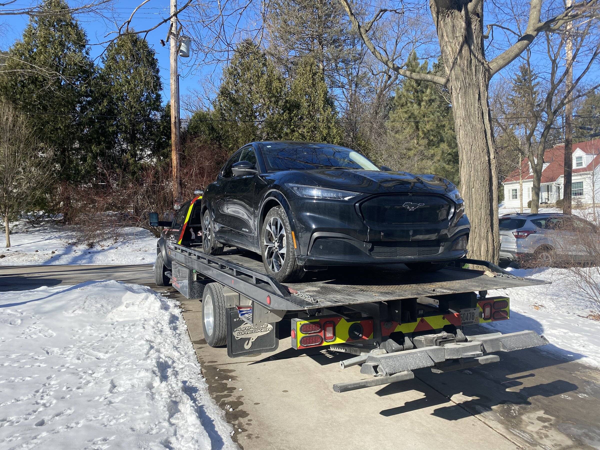

I got in the car this morning and the same problem persisted. I was supposed to drive back to Michigan today, so instead I'm having the car towed to a local (Madison, WI) dealership, spending $600 to rent a car to get back to Michigan (lowest available rental cost), and wondering how long it will take to get it back. Hopefully, Ford will have the decency to transport my car back to Michigan when the service is completed, because I don't want to spend the time and money to get back to Madison to pick it up.
@Ford Motor Company - I've been a cheerleader for this car for my first 20,000 miles, but it's hard to be a cheerleader today. Very disappointed for a car that is not yet one year old.
UPDATE (March 1, 2022): the dealership contacted me and said it was a software issue only. They were able to clear the error codes and they say the car is back to normal. I didn't get all the technical details yet, but there were no battery control modules or other hardware that needed to be replaced. Also, not a 12V battery issue. The tech said that this is a known problem that will likely be addressed with an upcoming OTA..

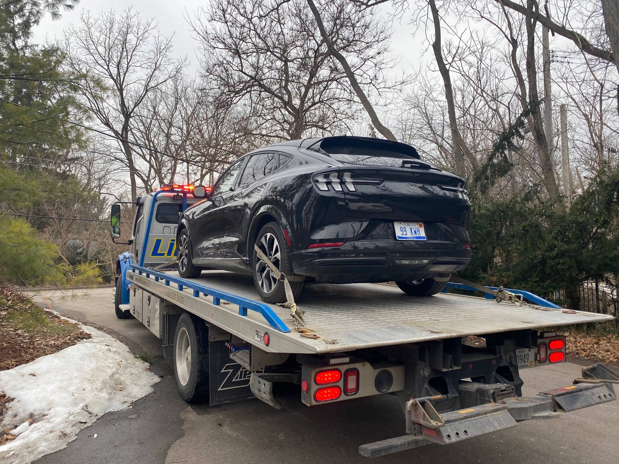

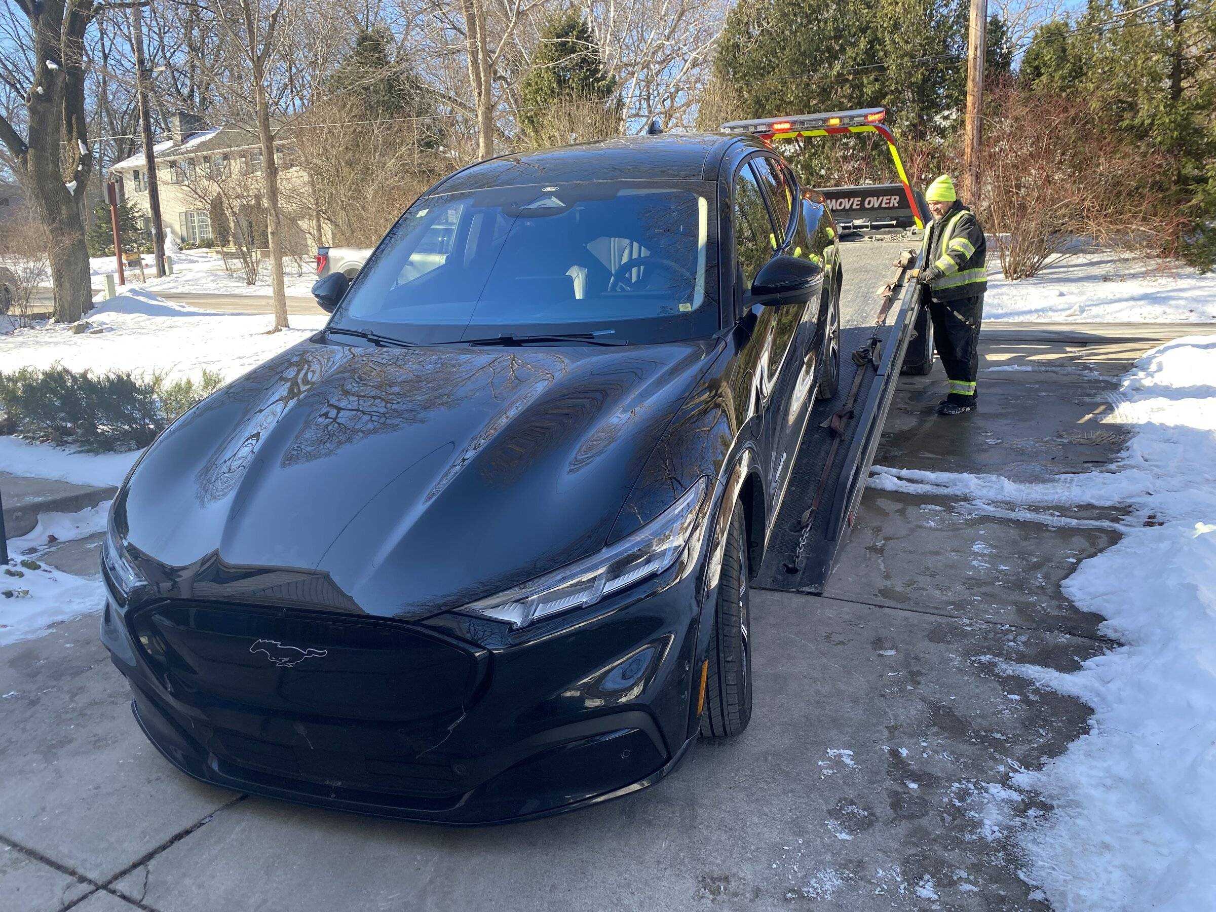

And it all ended well...got my Mach E back today, only three days after towing it to the dealership in Madison (WI). I blushed when I found out how much Ford paid to tow it back to Michigan. Ford kept this customer loyal.
