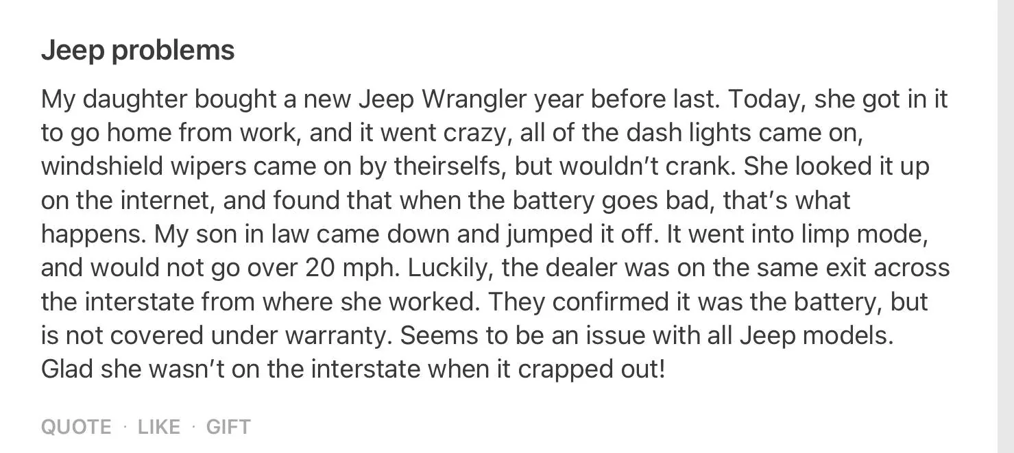

The more tech that goes into all cars means it can happen to any. Here’s a post from an electrical forum I participate in:

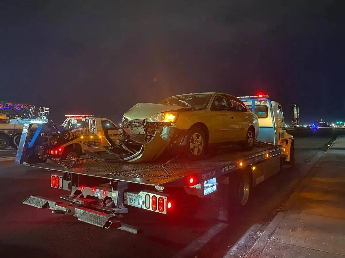

I guess that you don't have to have a front end collision to lose rear towing capabilities.
All you have to do is park head-in in your driveway. :)
Jan 30, 2022
If you are debating whether or not to put a towing hook on the rear of your MME, but figure that getting towed from the back is rare, it does happen.
Yesterday, at 3 PM (daylight), a speeding Dodge Challenger blew thru a red light here in Las Vegas. He killed himself, his passenger, and 7 other people in 6 other vehicles.
I only mention it because one pic stood out, you will see why.
Even a less violent front-end accident could screw up access to the front tow points.
