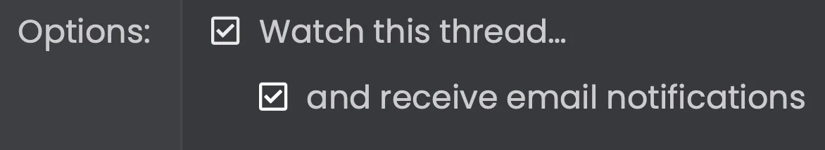

If I may, I'd like to suggest that you make it at least a daily practice to check this thread, and respond to any updates. Directly below the Reply compose box you can easily watch this thread and receive email notifications when there is new content.
Ford Mustang Mach-E Suma Mirrors | 5% off "MACHE5OFF" Screenshot 2023-09-19 at 6.58.59 PM
We can all take bad news, usually quite well. What we can't take is silence when we have legitimate concerns. Please keep up the communications.
