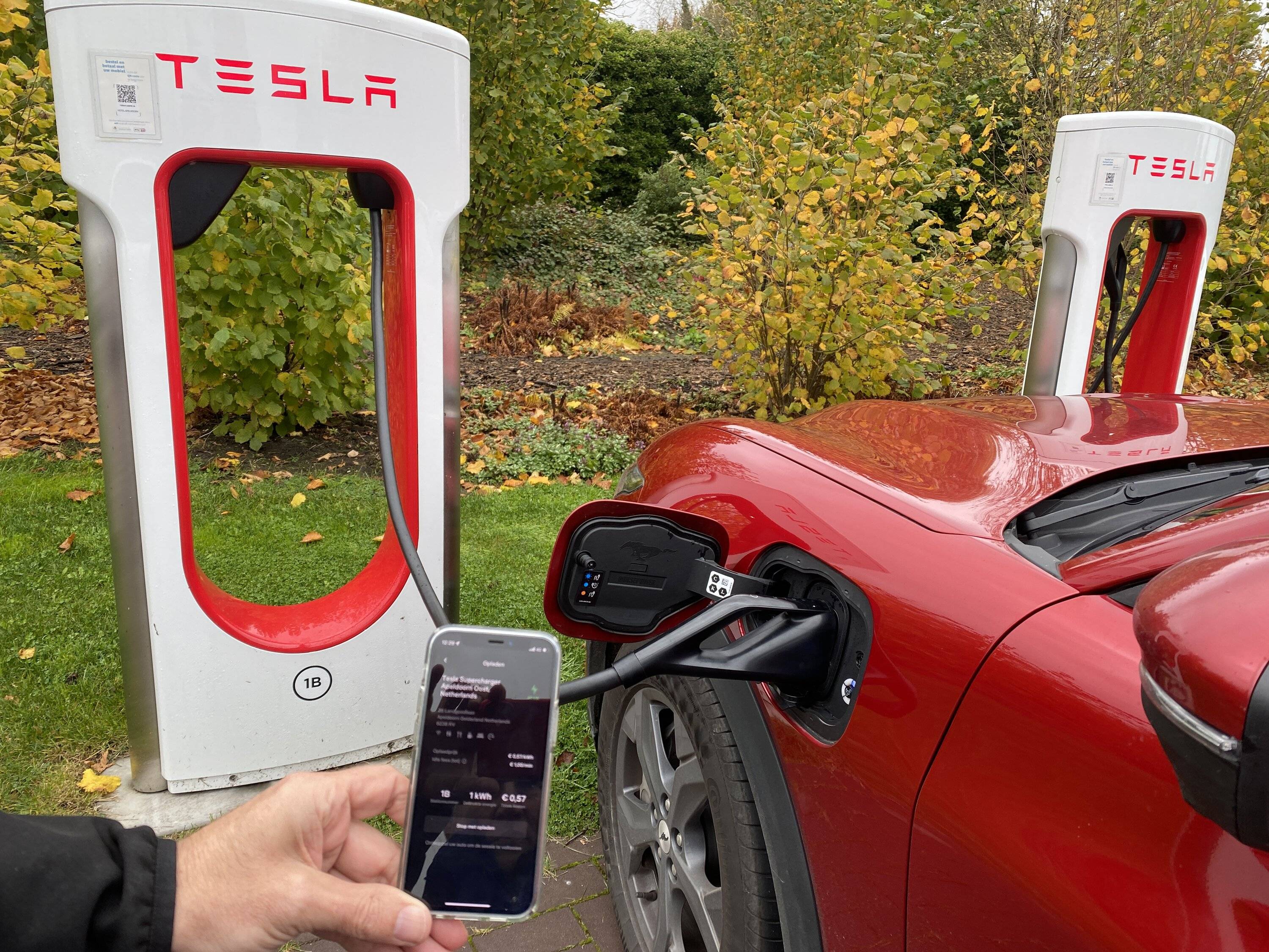

So I was really thrilled to hear that Tesla opened up its supercharger network to other car brands in parts of Europe a couple of weeks back.
All you needed to do is install the app, add payment method and you're good to go
I'm currently on a trip to France and since fast chargers are not that common I could use some extra options.
SO I went to one in Vierzon yesterday because there were no others in the surroundings.
And indeed there already was a Kia and Audi charging.
However my Mach E refused. Bunch of errors in the app and red lights around the charging ports. Ford app mentions a charging station fault.
Tesla app mentioned a coms error.
Tried several Tesla stations but none worked. Talked to the Kia guy if I did something wrong but no
So only Fords are having this issue?
Had to drive 50km per hour to another city to save energy and find another charger and caused some hours delay.
Nice gesture of Tesla and really disappointed my Ford refuses to talk to superchargers
