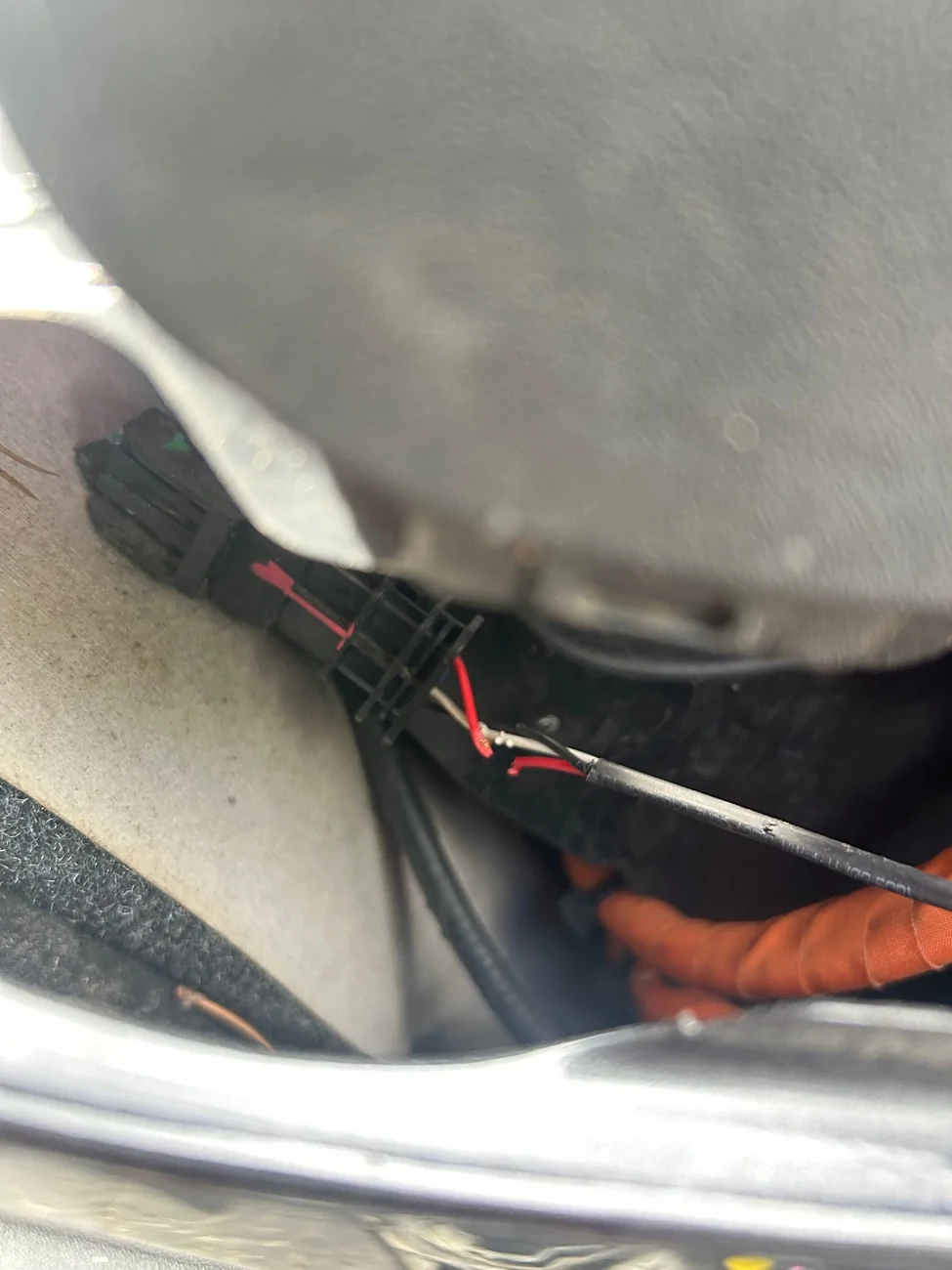

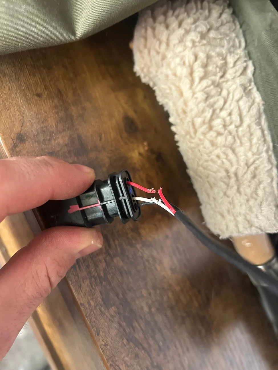

Turns out mine was the charge port door. Dunno how it’s connected to powertrain but that’s what the dealer diagnosed it as

Grandpa Gus's pouches can temporarily discourage the things. You need to replace them regularly, and they can get used to the smell and decide to ignore it.
