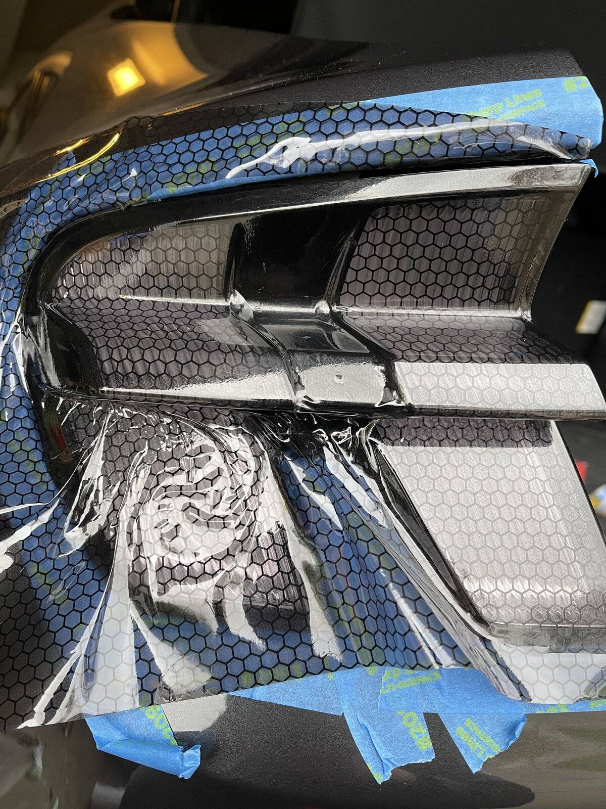

I cut the film to approximate size then start with it bent over my squeegee. Using that as a tucking tool to ensure the first adhesion point is the underside of the sharp angle of the taillights. Then it’s just a matter of wrapping it up over the top. Pretty easy when done one light at a time.
Dammit. I think I started this the opposite way and FML. Getting it to wrap the underside is going to put me in the loony bin.
Ford Mustang Mach-E Taillight tint D1F94819-CEE7-405C-84AE-568B6D4483AE
time to start over!
time to start over!
Cut it to smaller pieces first. Do one light at a time.

Oh crap! You didn’t wrap the entire housing? Just the actual lit sections? Yeah, should make life easier.
Yeah. Sorry if that wasn’t obvious. Each bar of the tribar was done individually. Makes it very easy to do.

I had the same problem... started trying to wrap the whole light (like the videos all show) and it is nearly impossible if you are not a professional due to all the sharp nooks and crannies these lights have. Then I realized that murse and others who have done this just did the individual lights. After a palmface moment, I tried it and it is soooo much easier!

Ford Mustang Mach-E Taillight tint 2B82337F-053A-46F4-90CC-1D529D926A09
Finally got both done. Second light went much better. I’ll try and take a better pick after I get this thing clean. I ordered just light smoke without the hex. Debating doing headlights. But at the rate car projects go with late nights after little one goes to bed it could be a little while. Looks sick with Dark Matter Gray. Thanks for the tips and pointers along the way.
