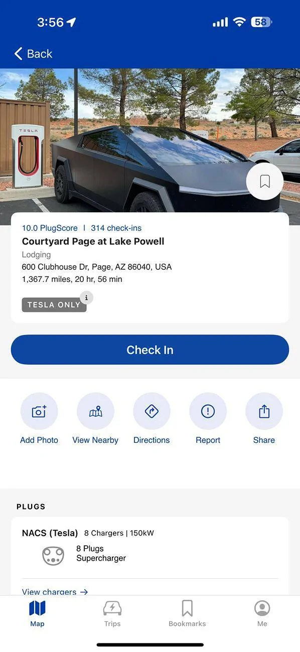

Use the Tesla/FindUs website and check the box for NACS Partner. Page AZ is Tesla only. You need the NACS partner or Open to other EVs Supercharger V3/V4.
You can also search via Plugshare but it's slightly more complicated and not always up to date.
Enabling Plug & Charge will help you with NACS Partner Superchargers, but won't help with Tesla only V1/V2 sites.

Where did it say it was available for Ford users?
It definitely isn’t because it’s an older 150kW station which are all Tesla only.
The Ford dealership in Page did. Go figure!
