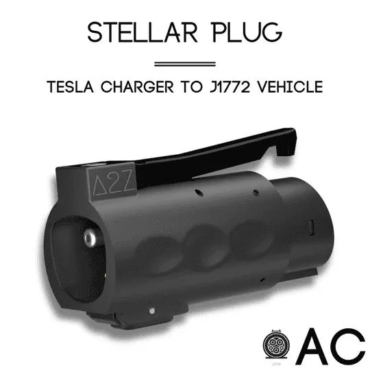

The only three brands / model I would buy is A2Z Stellar, UMC TeslaTap or Lectron J-1772
I personally bought the 48 amp Lectron and gave it away to a forum member and prefer to use the 80 amp A2Z Stellar with built in lock and compact design.
I am currently using the A2Z Stellar NACS to J-1772 adapter which is available for $92, compact build, has a built in lock, good customer service / warranty and overbuilt for futureproofing.

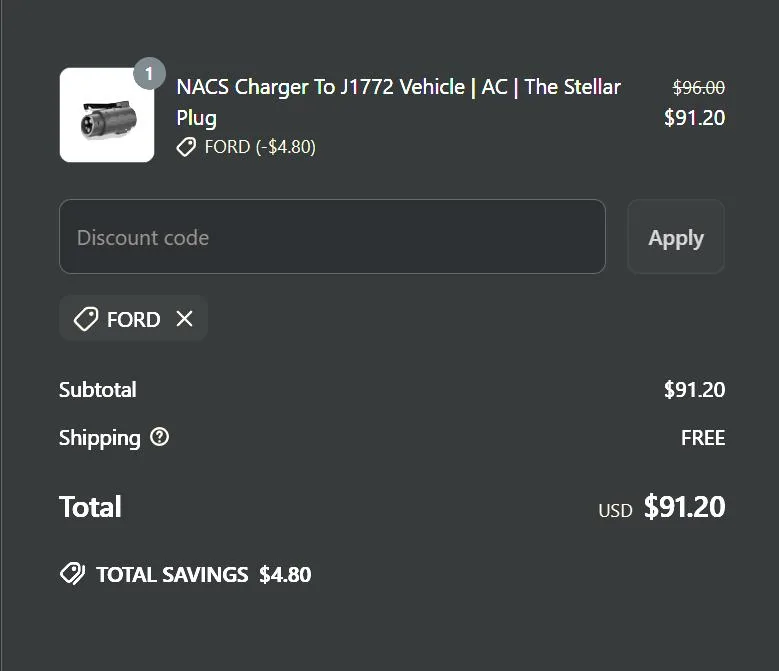

Discount promo code “FORD” is still working and free shipping is also available.
Stellar AC L2 adapter
A2ZEV NACS To J1772 adapter (Hotel Destination Charger for Hotels / Shopping centers) | Up to 80A | 20kW | 12 Months Warranty
