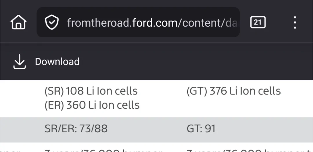

Yes, Ford removed some of the cells from the extended pack on the premium and select models. With the heat pump and efficiency improvements, they likely figured they could shrink the battery slightly and maintain the same range.
The GT is less efficient and requires more battery power output, so it needs all the cells.

In fact, even though the cell count went down Ford does in fact state the range is exactly the same as the the same as the 2024.
