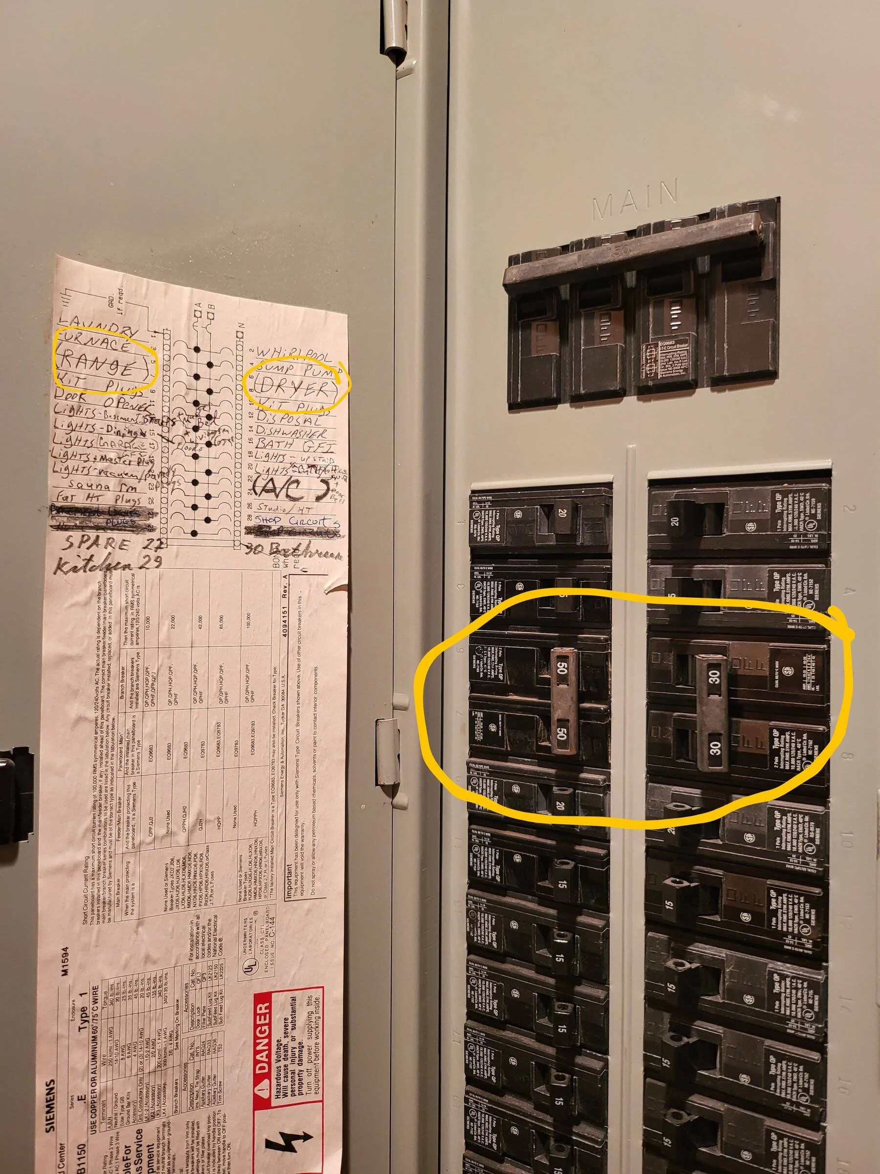

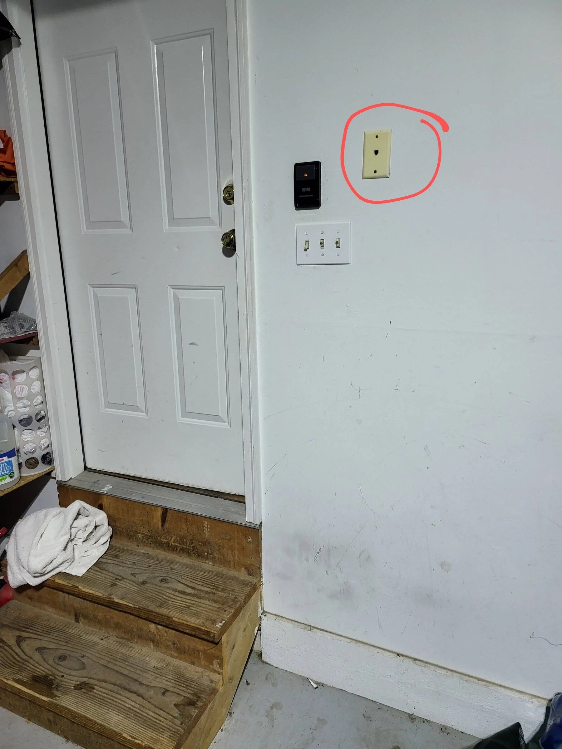

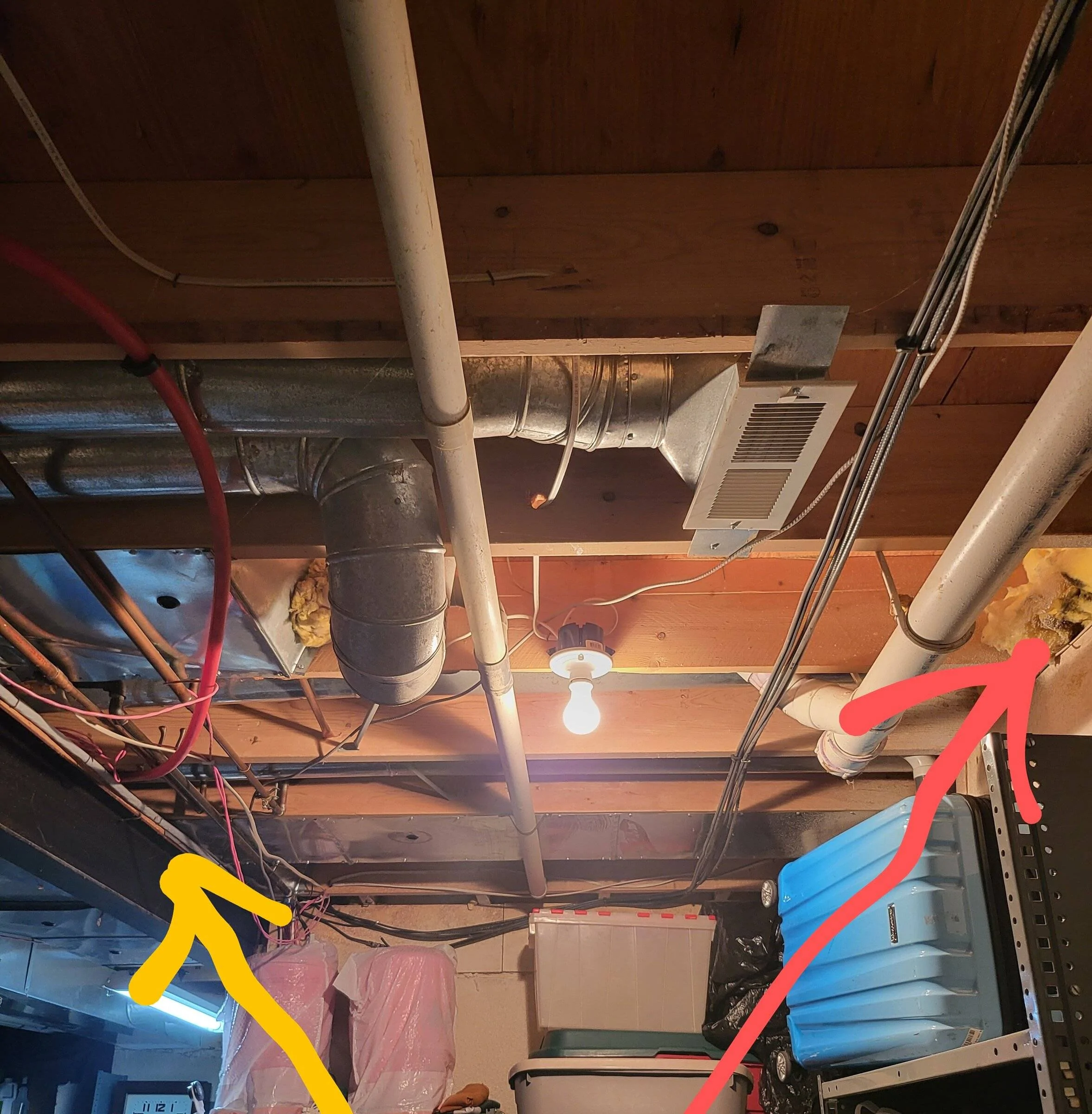

Ok, I'm going to pose this question and I'd love to get the input of those of you here. My MME GTPE ordered back in May is finally set to arrive in a couple weeks. And I'm getting ready to figure out my charging situation. I've been tossing around in my head the idea of doing this:
Just inside the garage, I have a laundry room with a 30amp dryer outlet. I have a gas dryer so the outlet is not being used. I also have a 50amp outlet behind my gas range in the kitchen. Not really being used. My breaker box is in the basement and it's about 50 feet from the garage. The dryer outlet run is 6:3 wire (as is the range run.)
Ford Mustang Mach-E Things to consider when DIY installing a wall charger / outlet 20220218_181745
My thought is to switch the two breakers so the 50amp is the one headed to the garage side of the house
Ford Mustang Mach-E Things to consider when DIY installing a wall charger / outlet 20220218_181246~2
then rerun the dryer wire up into the garage wall (yellow arrow is dryer run, red is under garage wall)
Ford Mustang Mach-E Things to consider when DIY installing a wall charger / outlet 20220218_181825~2
and install the NEMA 14-50 outlet there.
Ford Mustang Mach-E Things to consider when DIY installing a wall charger / outlet 20220218_181933
There is an old phone jack and wire I can use as a pull.
Ford Mustang Mach-E Things to consider when DIY installing a wall charger / outlet 20220218_181435
Ford Mustang Mach-E Things to consider when DIY installing a wall charger / outlet 20220218_181152~2
I am going to install a non-fusible 3-pole AC disconnect in the basement (the heated discussion in this thread on whether this is required by code or not has been interesting. I think it would be silly to install it in line of sight in the garage, as if the car ever did get a runaway battery fire I would assume the heat would be too much to get into the garage. however I would be able to run in the basement and pull the disconnect perhaps.)
Thoughts? Code considerations?
I'd get a permit and inspection for obvious reasons. My biggest question I guess is the breaker box change.

Not code if you switch the breakers since the oven outlet is now connected to a 30A breaker. Just replace the 30A breaker with a new 50A breaker.
Thanks. That makes sense. Do I have to worry about total capacity of the box?
