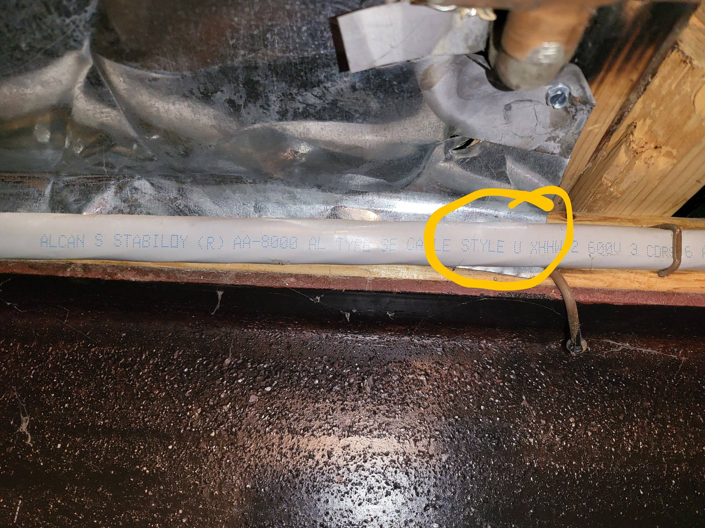

Ok, so after some research, I have discovered what the "Style U" means on the wire going to the dryer outlet I was going to reroute to the garage for the NEMA 14-50 outlet.
Ford Mustang Mach-E Things to consider when DIY installing a wall charger / outlet 20220305_200618~2
It means 3 conductors no ground wire. Therefore only three 6 guage wires in the cable. No bare ground wire in the jacket. Learned it Here.
But of course the NEMA 14-50 has three conductors and a ground. What does this mean for me? Do I have to run all new 6/3 Romex from my breaker box to the garage? No repurposing of the dryer run for me?
Most EVSEs don't require a neutral. You could wire up the 2 hots and a ground to the 14-50 outlet, but that would be against code. If you want to reuse the wiring, buy a hardwired EVSE.
From an electrician’s point of view, a properly wired 14-50 needs 4 wires.
From a DIY point of view, an EVSE does not use the neutral, so as long as the SEU originates in your main panel (not a sub-panel), you can use the outer braid as the ground and omit the neutral and it will work. There could be future problems if someone tried to use the receptacle for a load that requires a neutral (such as an RV).
I would either run this to a hard-wired EVSE or run new wire to a 14-50.

You could also just run a ground wire.

Thanks for all the input. Great suggestions. I figure I have three options, do the EVSE, run new romex and put in a sub-panel, or run a ground. Haven't made up my mind on which one.
If I run the ground, what wire would I use and how should I run it to keep it up to code?
Ground is typically be 1 size smaller than L1, L2, N
for NEMA 14-50 outlet, using a 50-amp breaker, depending on length of run from breaker to outlet, L1,L2,N *could* be awg8 for a short run, but you are better off to use awg6 for conductors (L1,L2,N), and awg8 for the ground.
why not just a 6-50 outlet? To code. And get a EVSE with that plug. Done.
Unfortunately, there is no code-compliant way to run an additional wire (ground or otherwise) that functions as part of a circuit where the other wires are in a cable.
Ah, ok. I thought so. I think I'm just going to run new Romex and put in a sub-panel. That way if a future owner wants to go back to an electric dryer, they can.

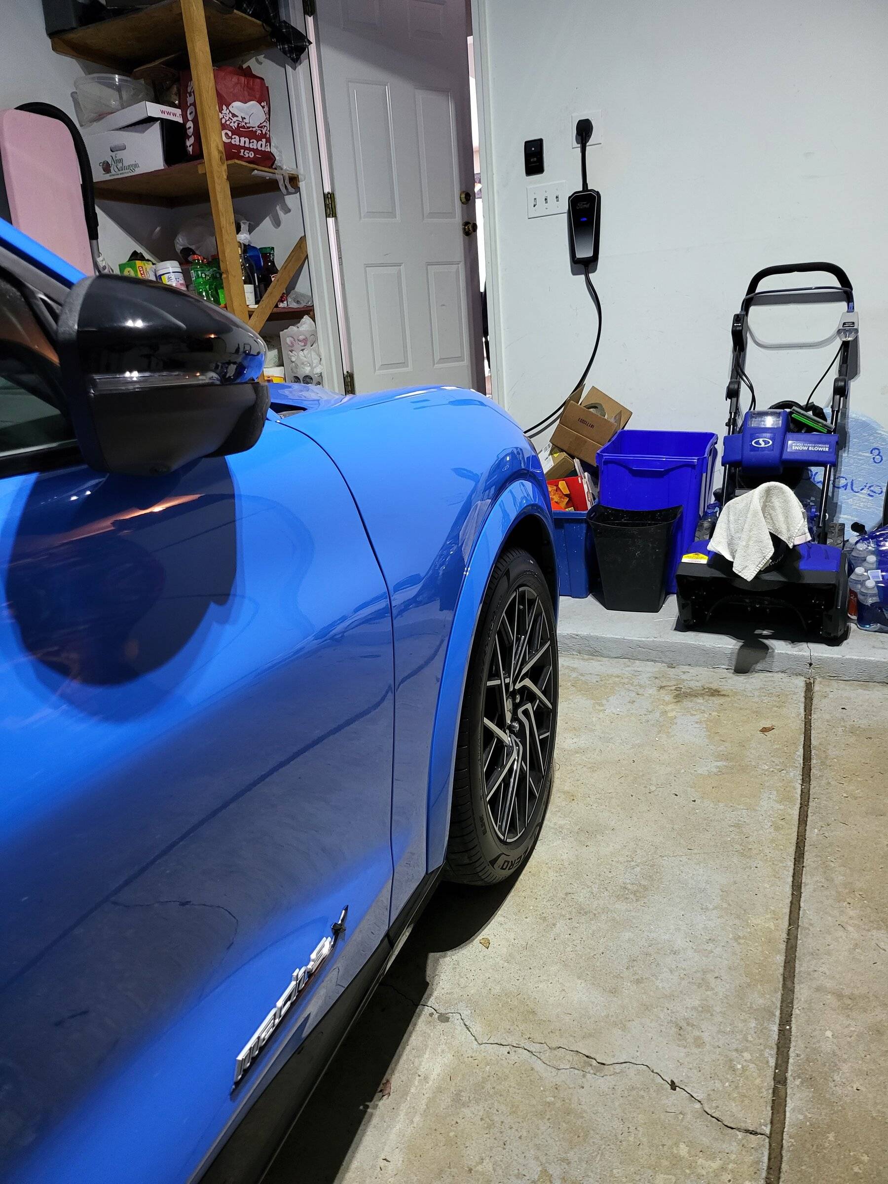

Okay, so I ended up just running 6/3 Romex across the basement and replacing the electric dryer 30 amp breaker with a 50. Pulled the dryer wire out of the breaker box and shoved it up into the ceiling for now. Garage outlet went in well. Got the car, working great.

Looks good, glad you just did it right and ran the new cable. A few minutes more effort now but a better long term solution.
