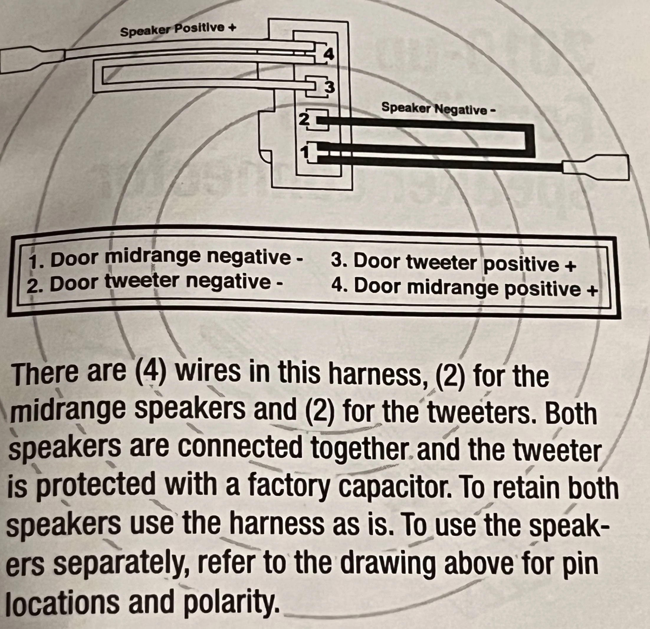

The correct adapters to place aftermarket speakers in the mache front and rear doors is METRA 82-5605.
When using the PAC Audio interface be aware that while there are 10 speaker leads only 1-4 work.
The front tweeter speaker leads are in the front of the car not where the factory amp is located.
The rear tweeters and midrange door speakers are wired together on channels 3/4 of the pac audio harness .
