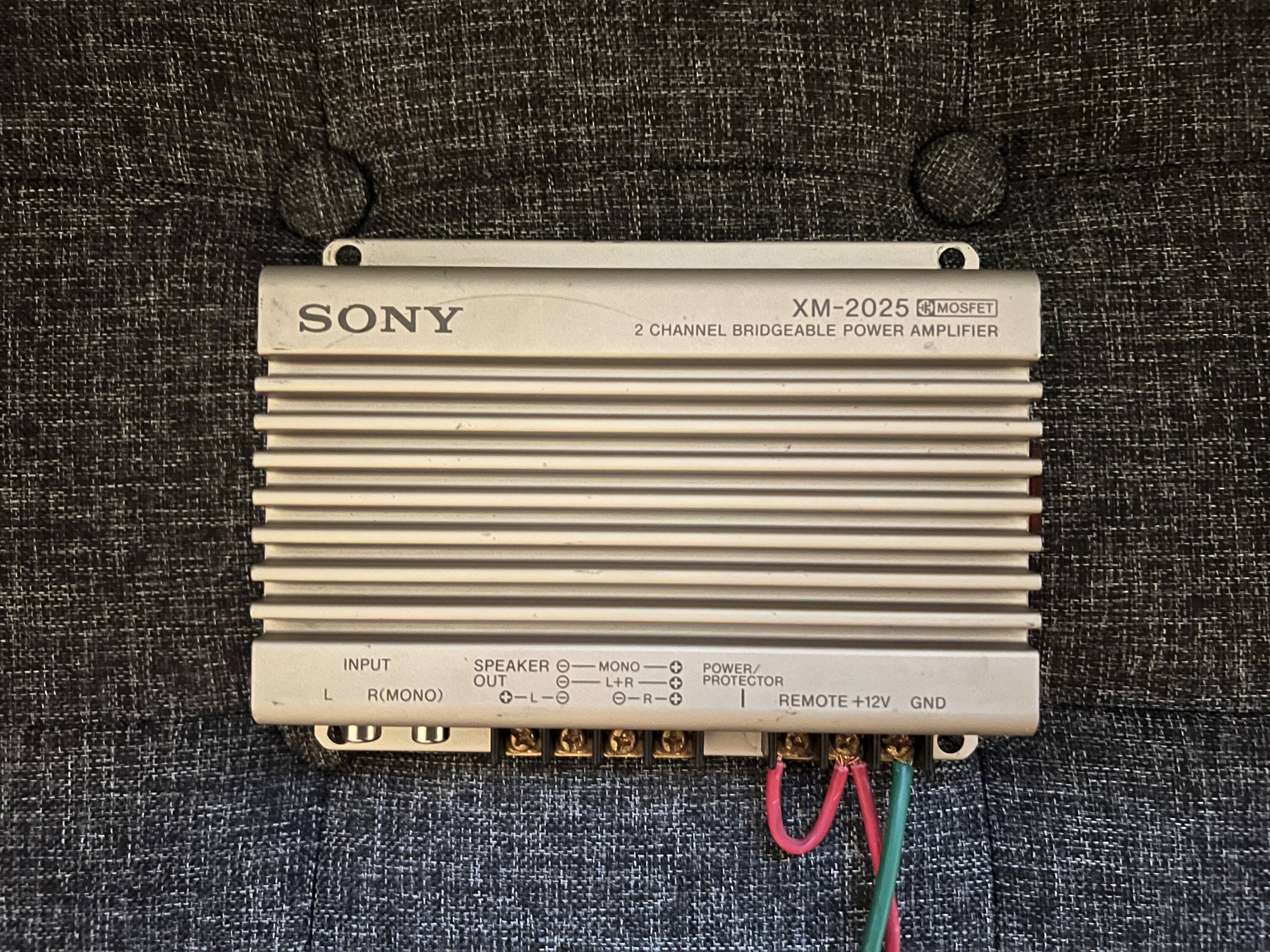

Tweeters typically don't use more than 10-20 watts RMS. Most multi-channel amps start at 50+ watts RMS. Using an amp that puts out this many watts is a waste of an amp. What I have done instead is using two dedicated class AA 2 channel amps. Really hard to find class AA amps these days. Everyone wants smaller more efficient amps and the trend is now class D amps. My personal opinion is when you're using the upper echelon of speakers it warrants a class A amp. Most folks however will never install speakers that warrant this. So in those scenarios just find a nice little class D amp that fits your budget. (Alpine, JL Audio, Rockford Fosgate all offer products)
Front Tweeter amplifier. Class AA 20x2 RMS Vintage circa 1994. Japanese made with huge caps and the kind of quality you just don't find in todays china manufactured amps.
