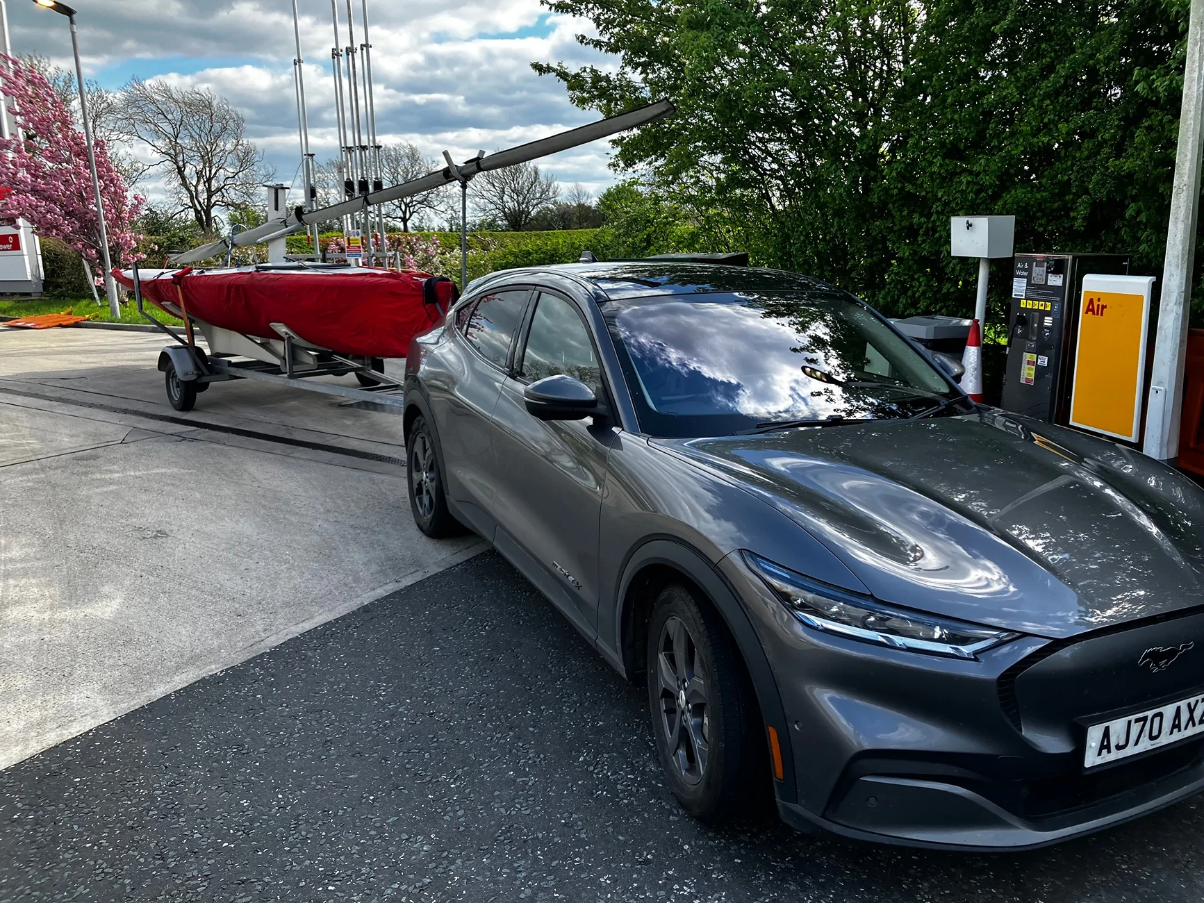

I’ve recently towed ~300kg of boat for 240 miles (120 miles each way) around the UK.
Ford Mustang Mach-E Towing - a lot less hassle than I expected. IMG_2260
Set off 100% 300 miles indicated, very quickly adjusted.
Arrived with 60 miles left in the battery.
30 mins on a fast charger, near the sailing club took me back to 80%.
Arrived home with 15 miles indicated.
Completely no drama, I’d been worried about how it would perform.
Now I know.

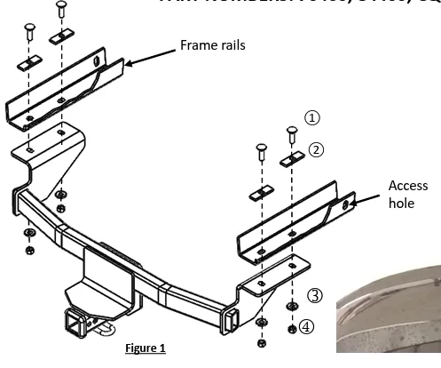

I've heard too many frame related issues. I believe the Ford hitch has re-enforcing plates inside the frame tubes
This is a good point.
It's been a few years, but I believe my Draw Tite came with the frame reinforcement inserts. There was some finagling to get them in place for the installation.

Per @AJ70's post with the Ford installation manual, the Ford appears to be sturdier than my Draw Tite. Draw Tite didn't need the bumper removed, but it came with the plates and a threaded fish wire to pull the top-down plate/bolts in place. I did need to trim the lower fascia. for the hitch
This is the only one I know of here that has extra mounting points to the bumper, all the others I've seen only bolt to the frame and are known to have issues. You could also pull the bumper off and add reinforcement like the EU hitches use.
