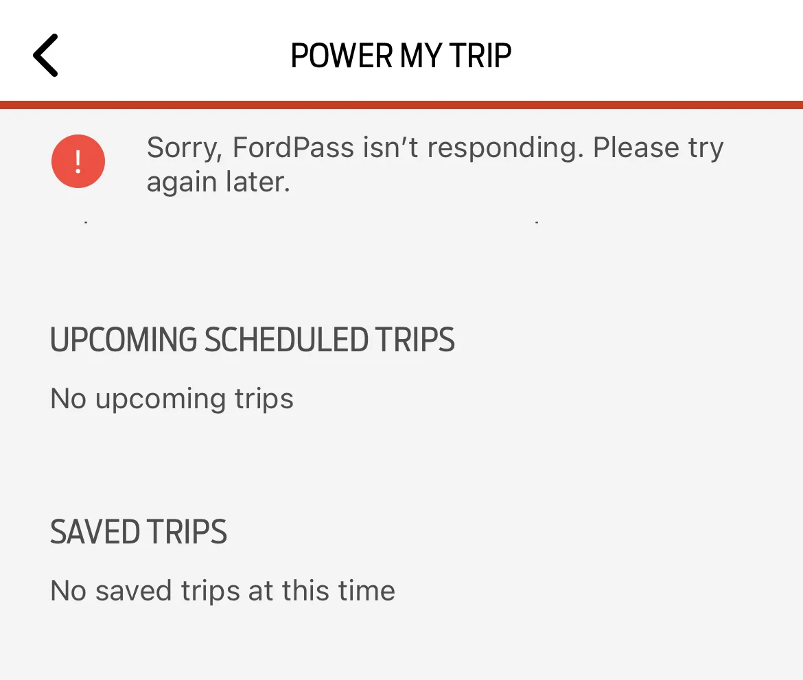

Adding this here rather than starting a new thread. A few weeks ago when I actually wanted to plan a long trip, I got a "Sorry, FordPass isn't responding. Please try again later" whenever I select "trip planner" from the FordPass (FP) App. It will still let me plan a trip, but when I try to save it to the car I get "Trip Limit for VIN Exceeded" (screen shots below).
I only had 4 trips in memory in the vehicle and deleted them all from the car as noted above in a post. Did not help.
I just planned the recent trip from in the vehicle as it was a minor inconvenience not to be able to do it in the app and push to the car. FP has updated at least once since this started an no change to errors. I was having an issue with notifications not working also (even when turned on in iOS) so I deleted and reinstalled FP app. That fixed my notification problems but not the trip planner errors. Anyone else experience this issue with the trip planner (this was the only thread I could find remotely similar)?
