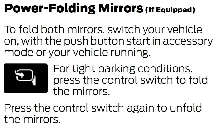

Can I use this to park in my garage? I literally have 2-3 inches on each side getting in and the mirrors dont fold in when im trying to park. Just curious.
You must be in the car holding the Park Assist button down for it to park. So if you wanted to us it to park in your garage and there's not enough room to open the door, then you'd need to climb out the tailgate - that is if it would park in your tight-clearance garage at all. (Hint: it won't.)
You can trigger your mirrors to fold/unfold by pressing the top left button on the mirror-adjust cluster on the driver's door.
Ford Mustang Mach-E trouble with parking assist Screen Shot 2022-11-09 at 6.02.41 PM

Thank you everybody, I looked everywhere on the center console for the mirror adjustment and didnt even think to look at the door buttons. Duh.
The button to fold/unfold the side mirrors is on the driver's door on the top left of the circle that adjusts the mirrors.
