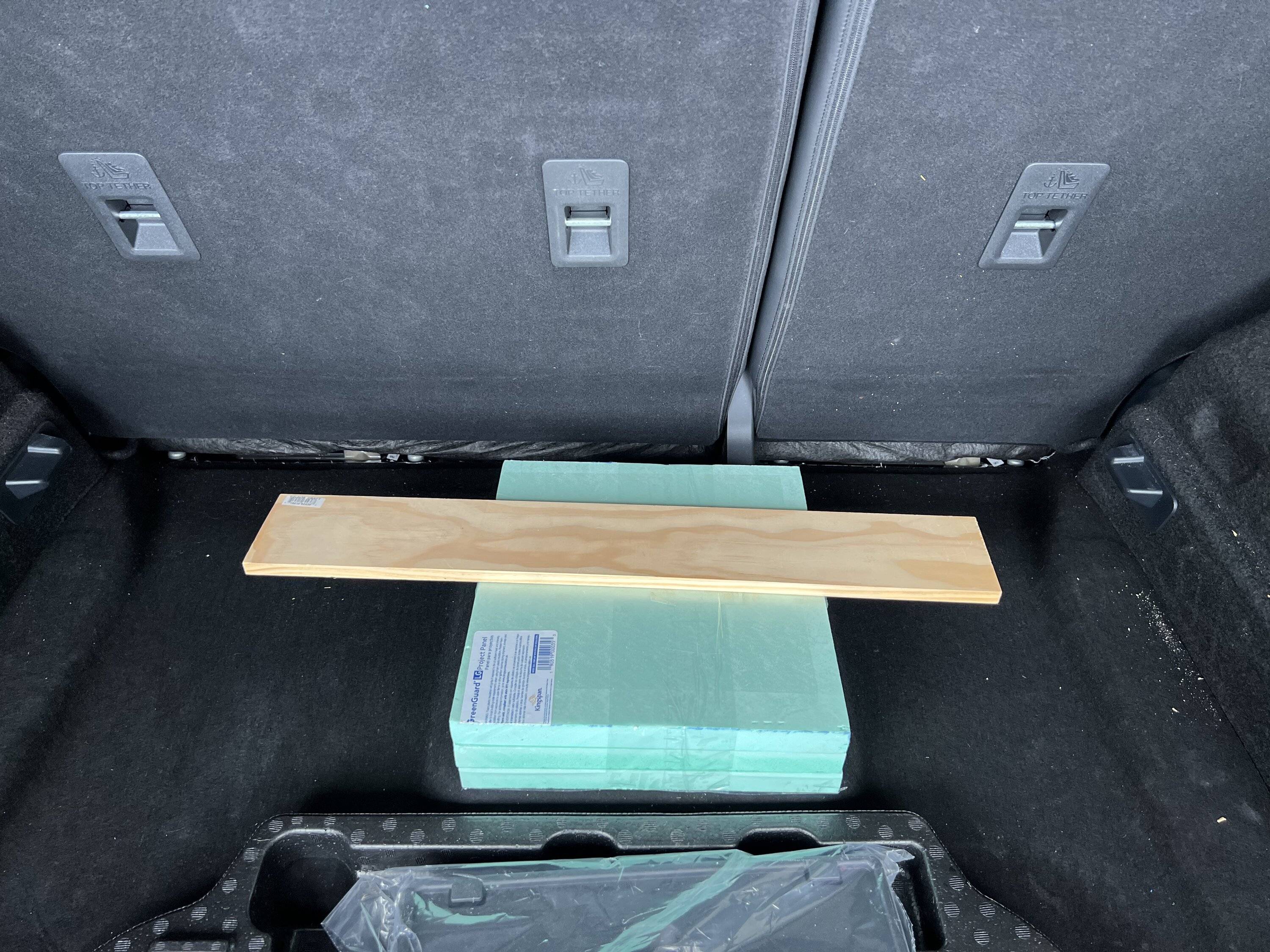

I actually took and built support for Center and so far I’ve had about 300lbs distributed across without any problem so far

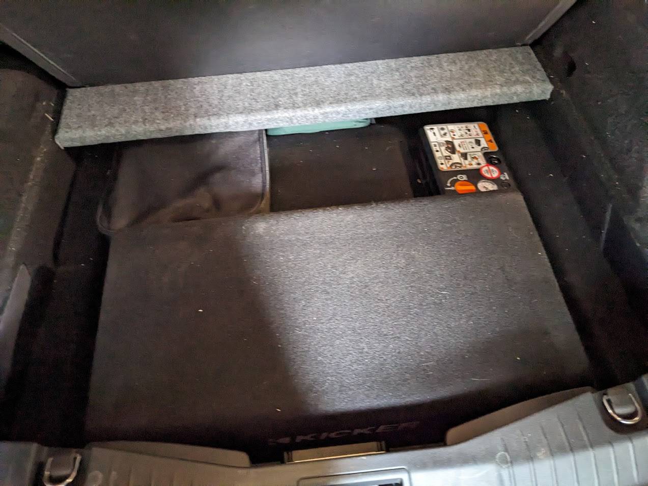

I went a step further with a 2x6 - routed the shape of the nub holders into the ends of the board, stuffed a bit of sound deadening in there to keep it snug, and then wrapped it in felt to help with vibrations. My floor sits on my sub and 2x6.
Ford Mustang Mach-E Trunk mod for more weight? PXL_20230607_230330110
With the foam removed and amps underneath. The floor sits higher than the highest position, which is basically flush with the trunk exit. This does mess with the rubber mat - I'm thinking about trimming it...but I'm waiting until the install is done to hear this setup and if it rattles I'm going to move the sub above the floor and drop it all the way.
Ford Mustang Mach-E Trunk mod for more weight? PXL_20230607_230313326
At any rate, if you're trying to get more space under the floor and strength above the floor I'd recommend running the board all the way across.

That will work just needs to spread weight out looks great.
