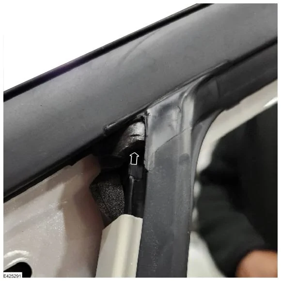

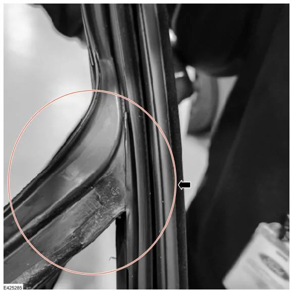

5. Separate and fold back the front door glass top run from the door frame and the run channel in the areas highlighted in Figure 2.
Figure 2

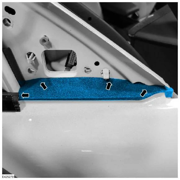

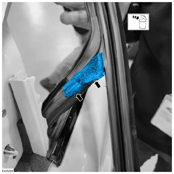

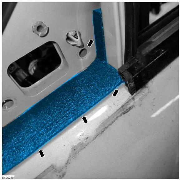

6. Remove the existing lower inner foam.
7. Install the new lower inner foam.
(1). Insert the front of the foam first making sure is seated under the window run/sheet metal and the foam shape properly fits the curves of the door. (Figure 3)
Figure 3
(2). Evenly tuck all edges of the foam into the door making sure that the rear sections sit flush against the window run frame with no gaps. (Figure 4)
Figure 4

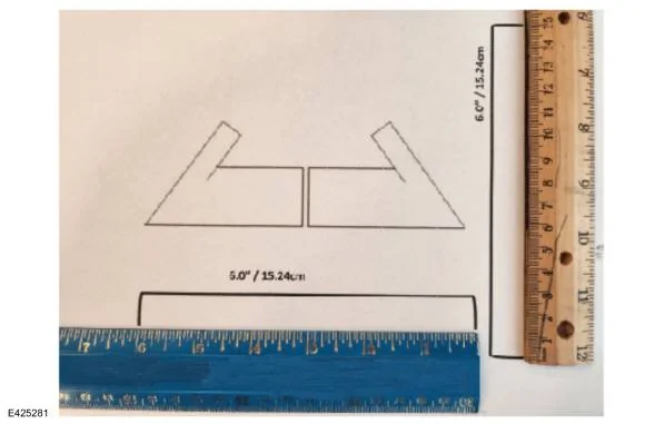

8. Print the foam template by clicking this link. Verify the horizontal and vertical scale of the image using a ruler against the scale on the template printout (Figure 5) to confirm the image scale is correct. Is the scaling of the template printout the same scale as the ruler?
Figure 5
(1). Yes - proceed to Step 9.
(2). No - adjust scale of the printing properties to actual size to resize the image. Repeat Step 8.

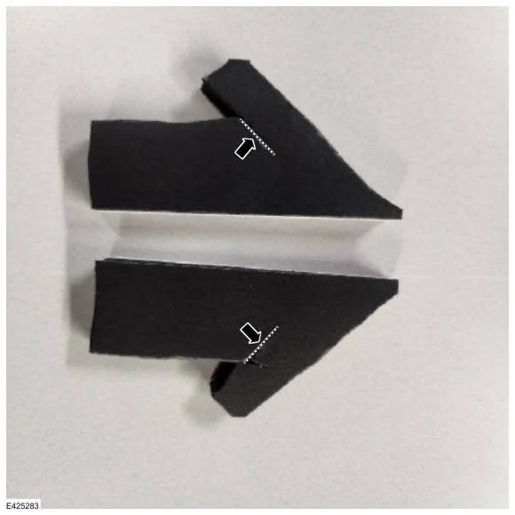

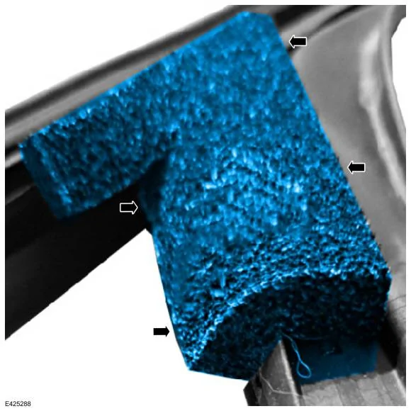

9. Layer together 3 pieces of the PVC Soft Foam Strips (Rotunda part) to obtain the desired thickness.
10. Cut the shapes from the template printed out and trace the shape of the back side of the foam. Cut the foam along the line traced on the back to create the shape indicated in Figure 6.
Figure 6
11. Cut an additional 10mm (0.39 in.) slice into the foam in the area indicated in Figure 7.

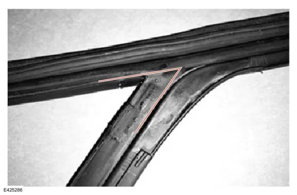

12. Remove the existing glass top run foam and clean the surface to remove any residual foam. (Figures 8-9)
Figure 8
Figure 9
CAUTION: Be careful to not tear the rubber of the glass top run when fitting/tucking the foam underneath.

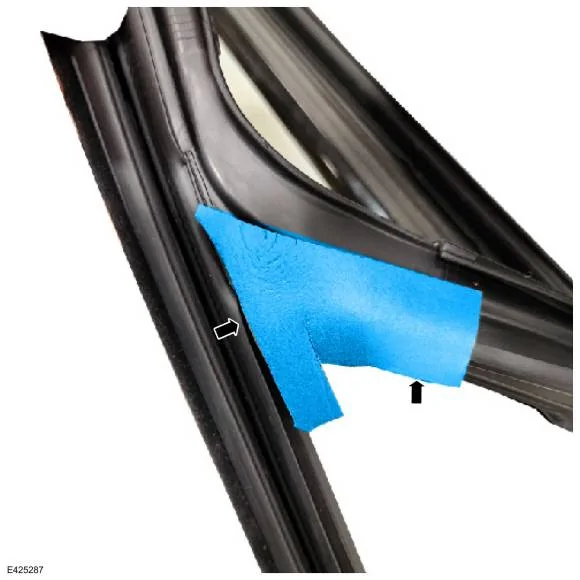

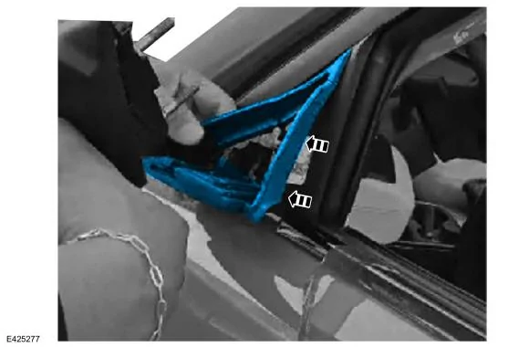

13. Install the cut pieces of foam onto the glass top run.
(1). Align the foam with the ridge along A-pillar and the lip along the header. (Figure 10)
Figure 10
(2). Apply pressure to adhere the foam to the inner surface of the glass top run. (Figure 11)
Figure 11
(3). Fold and pressurize the lower area of the foam over the back of the A-pillar channel, leaving the upper extension unadhered. (Figure 12)
Figure 12

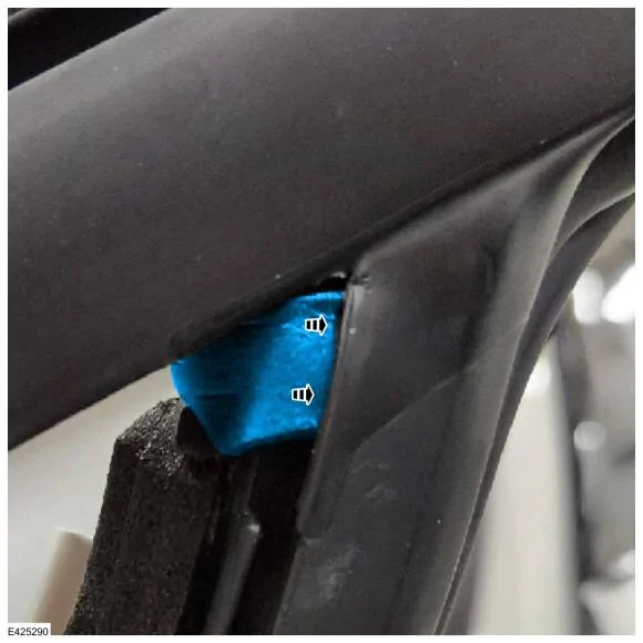

(4). Moving to the exterior of the glass top run, take the end of the foam extension and pull, seating the foam toward the header/A-pillar corner (Figure 13)
Figure 13
(5). Tuck the end of the foam extension high up under the lip of the glass top run following the upward angle of the run. (Figure 14)
Figure 14
