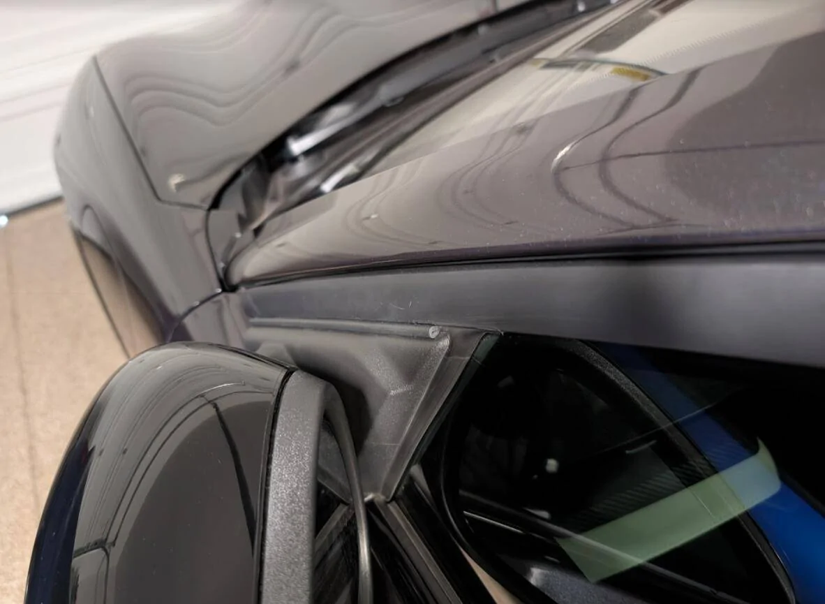

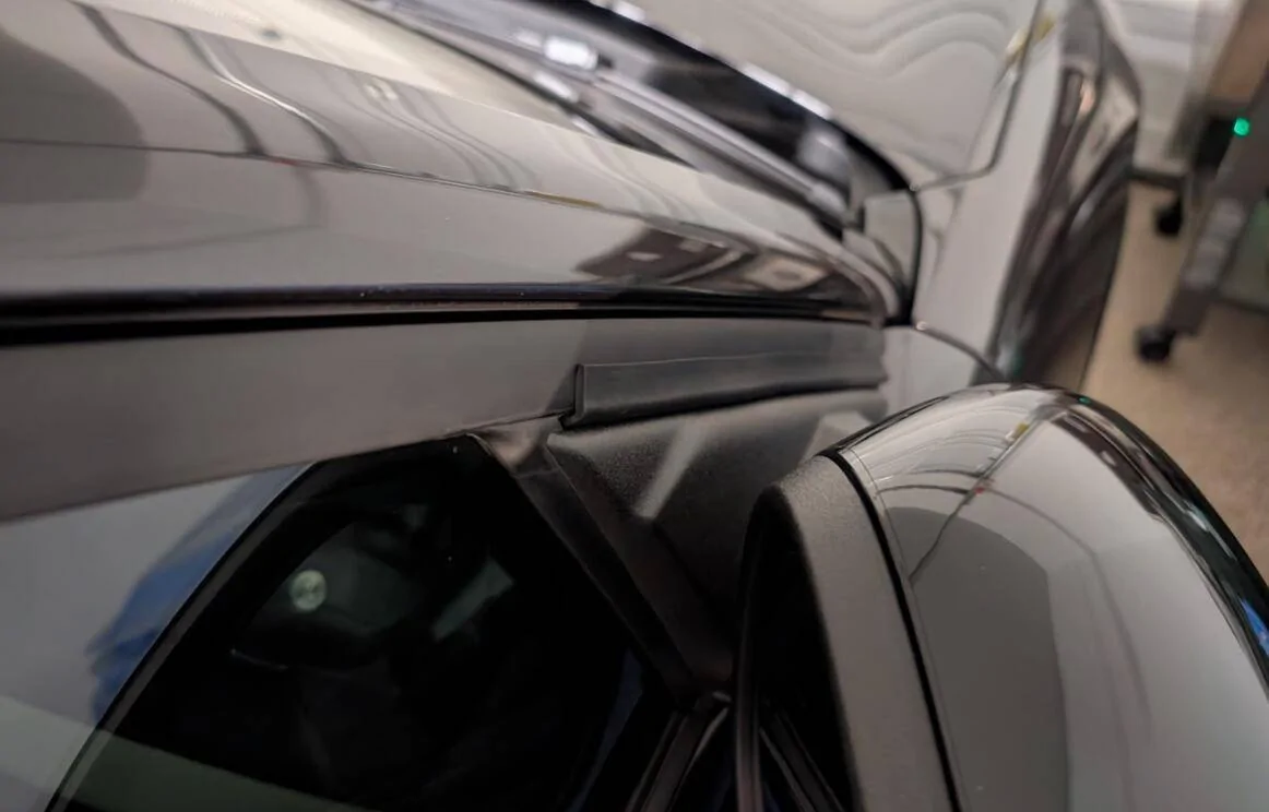

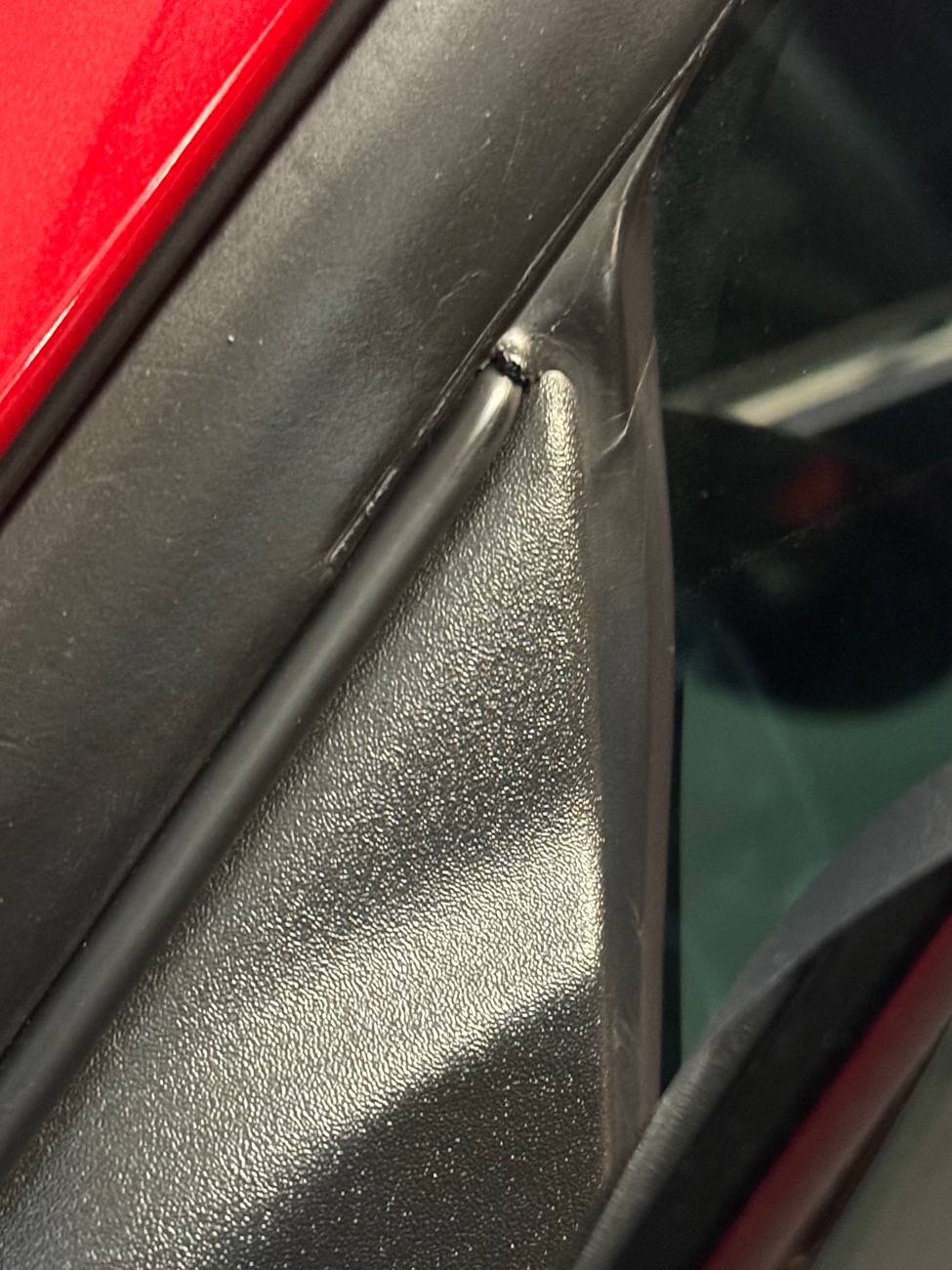

i had the same issue and a permanent fix was done by my Ford dealer as per TSB below.

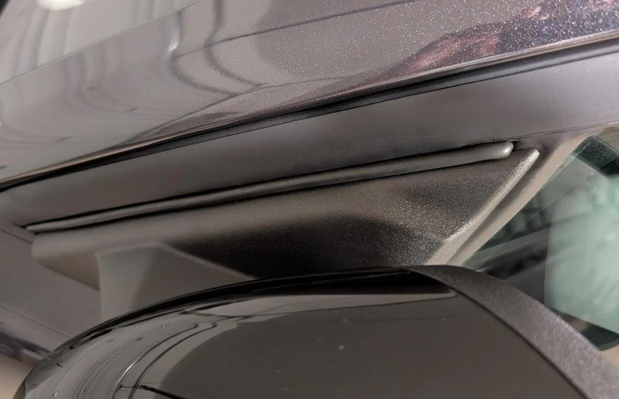

Issue: Some 2021-2024 Mustang Mach-E vehicles built on or before 09-Jul-2024 may exhibit a wind noise from the exterior mirrors/A-pillar area when driving between 25 mph-40 mph (32 km/h-64 Km/h). This may be due to poor sealing of the lower mirror foam and the glass top run foam. To correct this condition, follow the Service Procedure to install new lower inner foam and the glass top run foam.
NOTE: A small amount of wind noise from around the exterior mirrors is considered to be characteristic of vehicle design.
Action: Follow the Service Procedure to correct the condition on vehicles that meet all of the following criteria:
• 2021-2024 Mustang Mach-E
• Built on or before 09-Jul-2024
• Wind noise from exterior mirrors/A-pillar area when driving between 25 mph-40 mph (32 km/h-64 km/h)

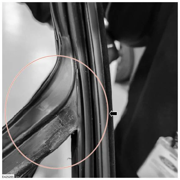

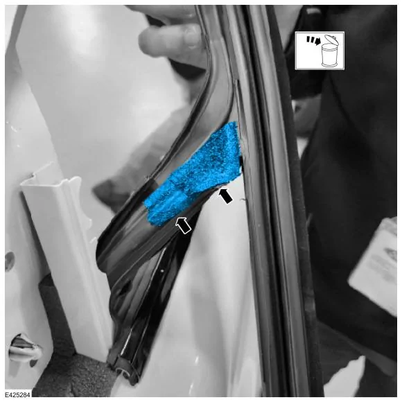

2. Lower the front door window glass of the affected side to the fully down position.
3. Remove the exterior mirror. Refer to WSM, Section 501-09 Rear View Mirrors > Removal and Installation > Exterior Mirror Assembly.
4. If the exterior mirror foam gasket/seal remains on the door, remove and refit the mirror foam gasket/seal back onto the mirror before reassembly. (Figure 1)
Figure 1
Ford Mustang Mach-E Side Mirror Wind Noise Fix imagen2

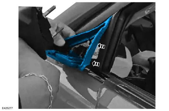

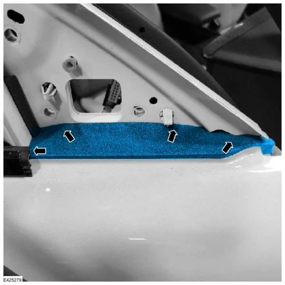

5. Separate and fold back the front door glass top run from the door frame and the run channel in the areas highlighted in Figure 2.
Figure 2

7. Remove the existing lower inner foam.
8. Install the new lower inner foam.

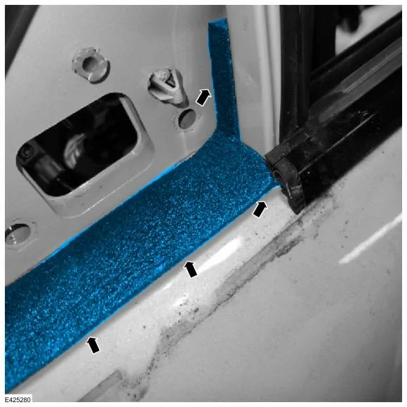

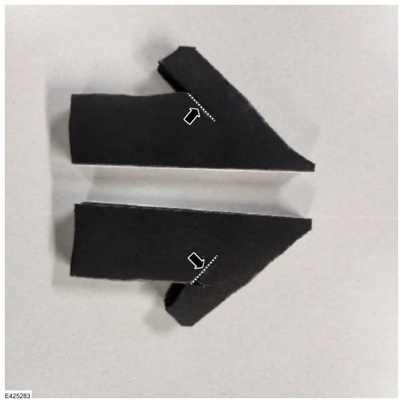

(1). Insert the front of the foam first making sure is seated under the window run/sheet metal and the foam shape properly fits the curves of the door. (Figure 3)
Figure 3

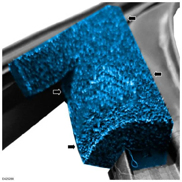

(2). Evenly tuck all edges of the foam into the door making sure that the rear sections sit flush against the window run frame with no gaps. (Figure 4)
Figure 4

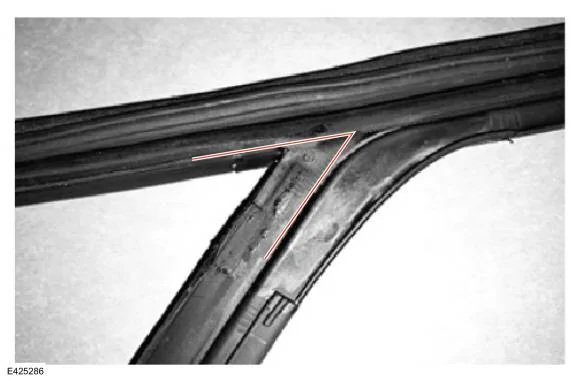

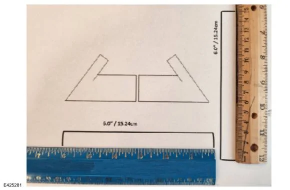

9. Print the foam template by clicking this link. Verify the horizontal and vertical scale of the image using a ruler against the scale on the template printout (Figure 5) to confirm the image scale is correct. Is the scaling of the template printout the same scale as the ruler?
Figure 5
(1). Yes - proceed to Step 10.
(2). No - adjust scale of the printing properties to actual size to resize the image. Repeat Step 9.

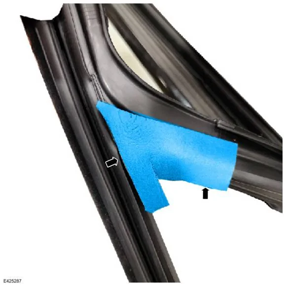

10. Layer together 3 pieces of the PVC Soft Foam Strips to obtain the desired thickness.
11. Cut the shapes from the template printed out and trace the shape of the back side of the foam. Cut the foam along the line traced on the back to create the shape indicated in Figure 6.
Figure 6

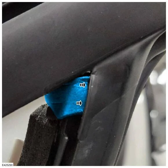

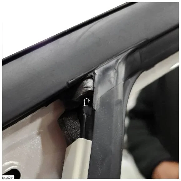

14. Install the cut pieces of foam onto the glass top run.
(1). Align the foam with the ridge along A-pillar and the lip along the header. (Figure 10)
Figure 10
(2). Apply pressure to adhere the foam to the inner surface of the glass top run. (Figure 11)
Figure 11
(3). Fold and pressurize the lower area of the foam over the back of the A-pillar channel, leaving the upper extension unadhered. (Figure 12)
Figure 12
(4). Moving to the exterior of the glass top run, take the end of the foam extension and pull, seating the foam toward the header/A-pillar corner. (Figure 13)
Figure 13
(5). Tuck the end of the foam extension high up under the lip of the glass top run following the upward angle of the run. (Figure 14)
Figure 14

Figure 1
Figure 2
Figure 3
Figure 4
Figure 5
Figure 6
12. Cut an additional 10 mm (0.39 in.) slice into the foam in the area indicated in Figure 7.
Figure 7
13. Remove the existing glass top run foam and clean the surface to remove any residual foam. (Figure 8-9)
Figure 8
Figure 10
Figure 11
Figure 13
Figure 14

Had a bit of a eureka moment and I think I've found the perfect compromise solution between spline (which works just ok for noise) and the thick rubber strip, which works better but is ugly. I had some of this U-shaped rubber left over from an unrelated project and it hit me after a road trip (during which I was still hearing more wind noise than I should) that it might fit nicely into the mirror gap. And wow, not only is it a good fit but it works GREAT - ZERO noise - and it doesn't look like sh*t.
I also want to express gratitude for this solution. I'd had the wind-noise TSB done on my car and it may have made a little difference but the majority of the noise didn't go away. I tried your solution this week and couldn't be happier. Not only did it resolve the wind noise problem, it practically eliminated the road noise from other cars along side of me and passing me on the road. That was noise I had just accepted as being normal until now. It's a great improvement so thank you very much.
My driver's side came out similar to yours:
Ford Mustang Mach-E Side Mirror Wind Noise Fix 1726425854982-ks
I decided to do the passenger's side as well but there wasn't room for the trim rubber to fit so I compromised. It doesn't look as good but it should stays put:
Ford Mustang Mach-E Side Mirror Wind Noise Fix 1726426029239-ht
Well done,and I'm happy this solution helped others. I found that by gently using a metal hook to hold up the rubber trim up at the top I was able to tuck the top edge of the rubber strip in, which I think really gives it a finished appearance.
Here is that top edge today, months after I installed it:
Ford Mustang Mach-E Side Mirror Wind Noise Fix IMG_5820
Oh, OK. That's the reason for trimming that end of the rubber. I hadn't quite understood that part. Now it's clear. I'll do it. Thanks!
Update: Done
Ford Mustang Mach-E Side Mirror Wind Noise Fix 1726459261622-b8
