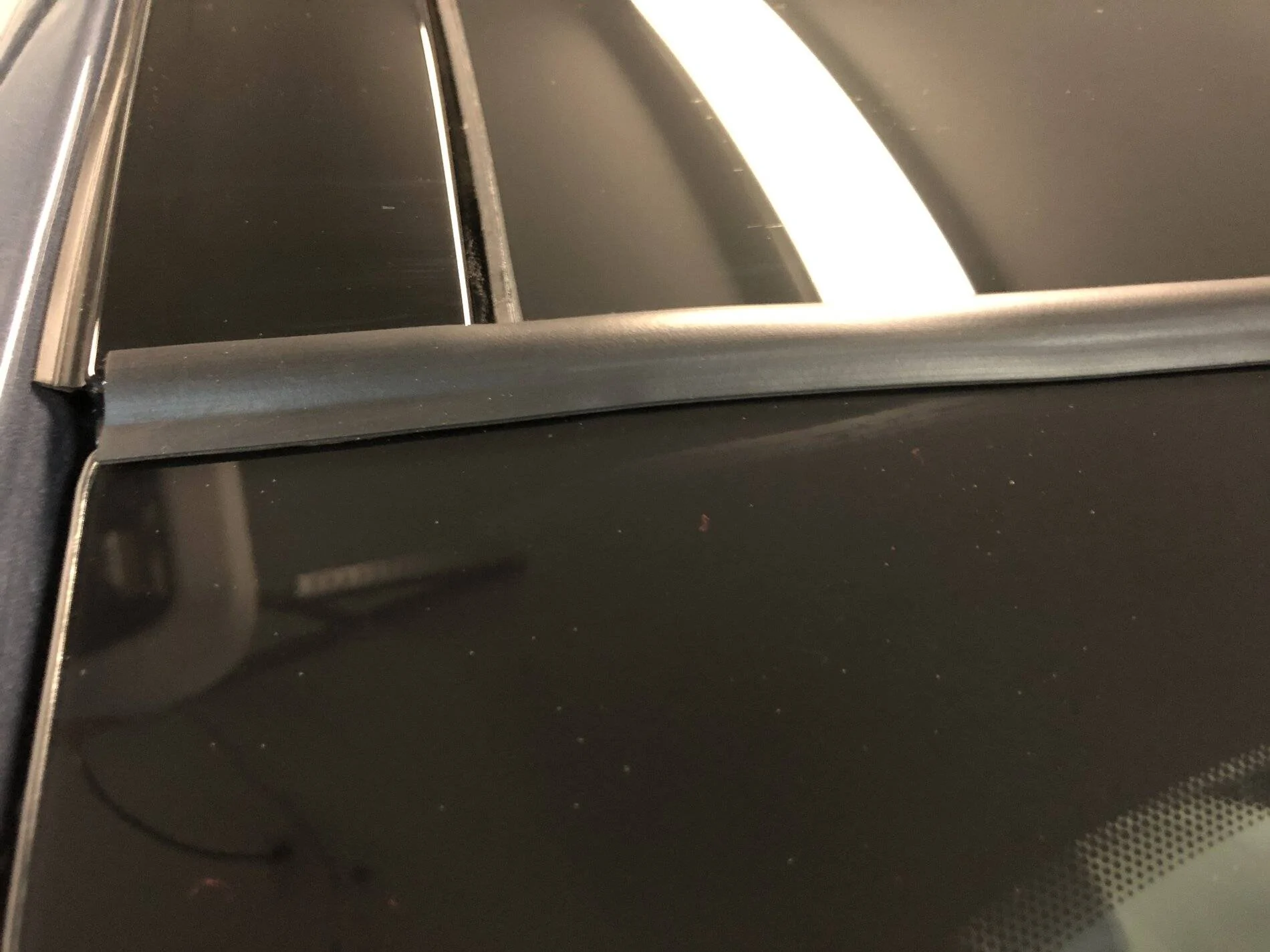

Instead of foam cord, I used a T-shaped rubber fitting across the line to smooth out the raised second on the passenger side. Took a spin on the highway and found a decent perceived improvement.
Car Windshield Weather Rubber Sealing Car Front Windshield Strip T Shape Sealing Strip Automotive Door Sealing Strip for Car Truck Door Window Decor (10 Feet) https://www.amazon.com/dp/B08V8QWFH...abc_VHG34Q25KJ59GPDC39HX?_encoding=UTF8&psc=1
Looks like it was meant to be there, good job!

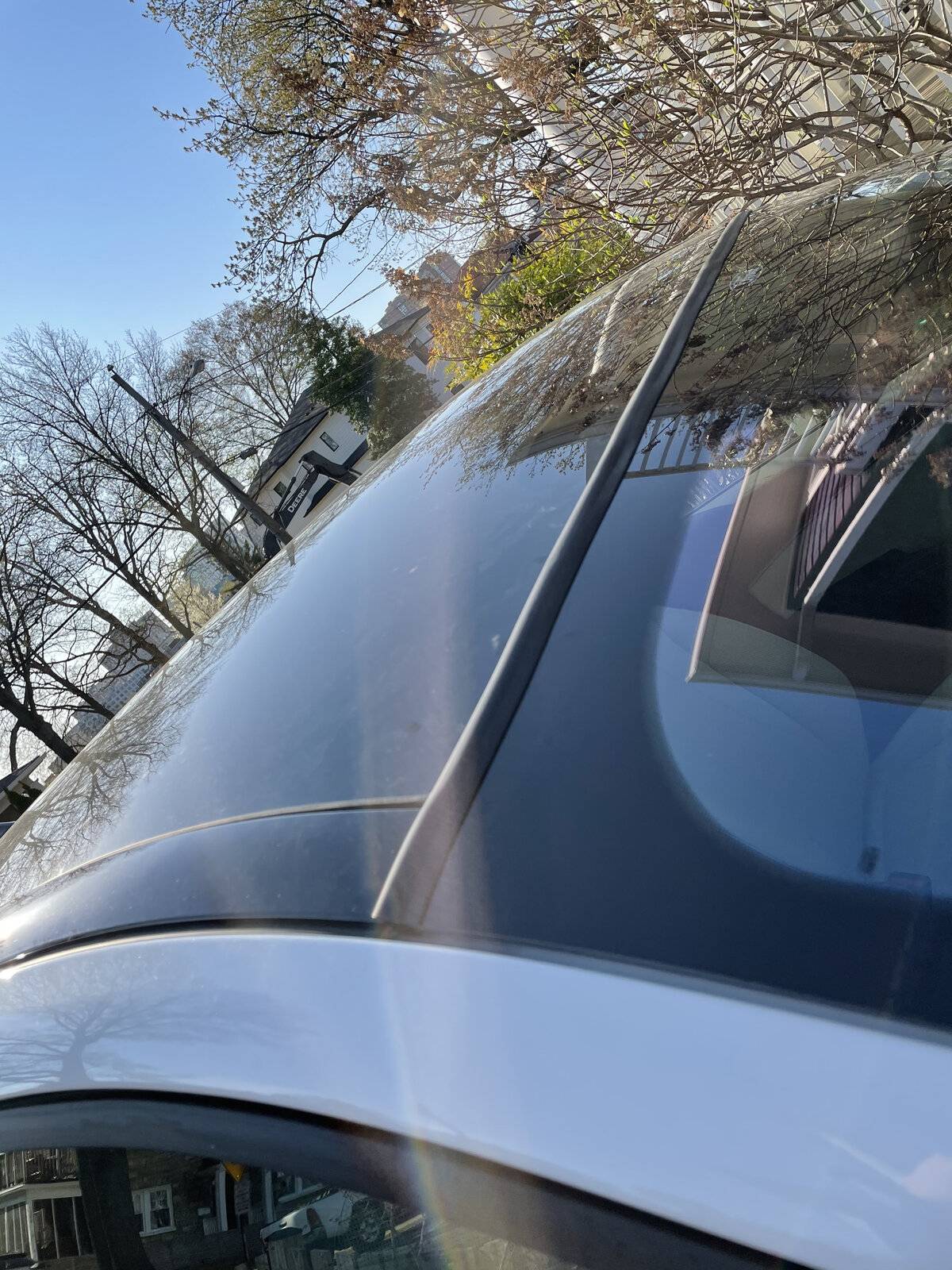

Just the front as per @JSW. That does look pretty cool.

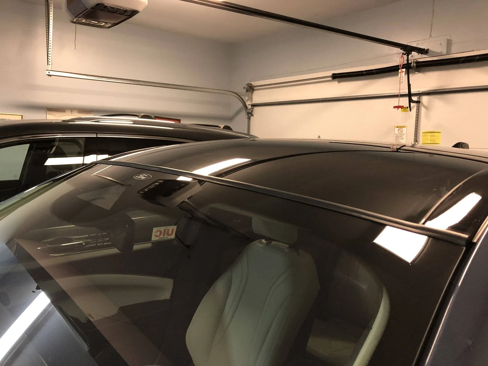

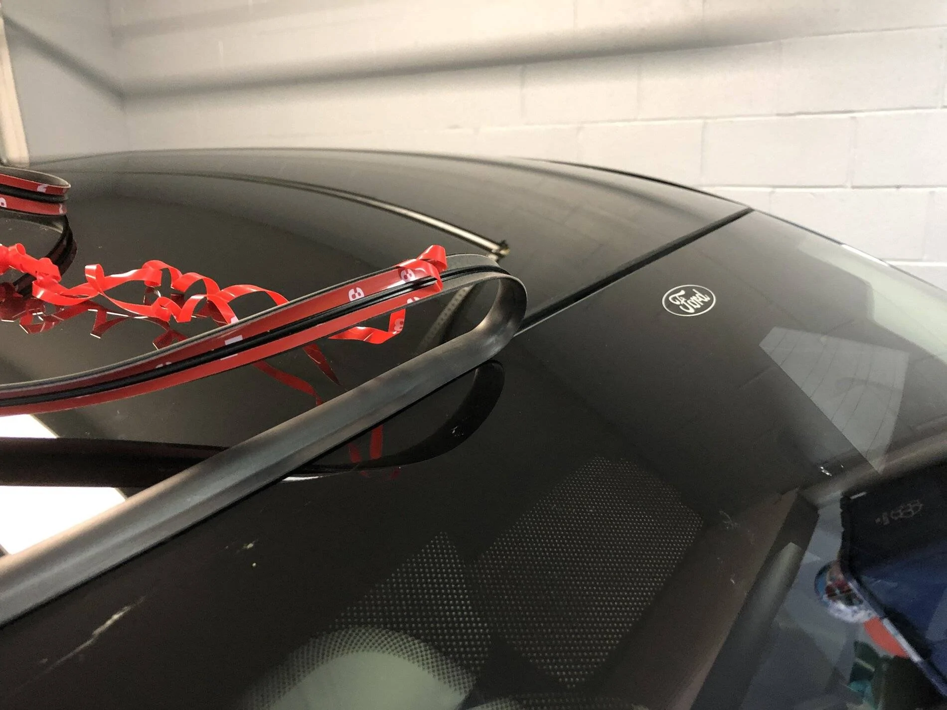

Used the same sealing tape on mine. Don't know how they'll last in the extreme weather (heat in summer and subzero in winter typical weather in Illinois). I tried what another member did and put masking tape over seam and the wind noise decreased so I went to these. I didn'y\t have directions and didn't call up the page in Amazon with them so the rubber seal is backwards from what they recommend so pay attention to the blue diagram.
Thanks for posting pics! Been away for the past month or so, and was really hoping for a TSB or something from Ford on this. Doesn't look like it. Will look into ordering this as well. When you say you applied it backwards, do you mean the 9mm side should be on the glass, and 8mm on roof? Wonder what that notch is for on the 8mm side
