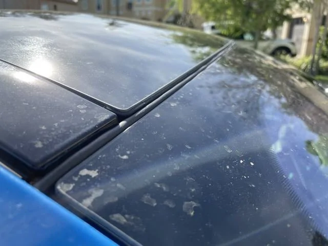

Normally I would totally agree that neoprene is very compressible (I've had neoprene wetsuits, ankle brace, car seats, etc) but the neoprene cord that I got was exactly like hard rubber and impossible to fit into the gap between the windshield-roof.
So instead I purchased this:
https://www.amazon.com/dp/B00NL4D2T...abc_GGZM1S8C1XM66SAHW4D6?_encoding=UTF8&psc=1
which is a solid but squishy EPDM 0.25" cord that could be jammed into my 3/16" gap. It took 20 minutes of me swearing, but it slowly and steadily got done.
For me, wind noise was most noticeable at around 30 to 50ish mph, as anything faster resulted in more road/tire sounds in the cabin. The effects of cord installation on decreasing wind noise was greater than I expected -- subjectively, I'd say it was well north of 50% and worth the effort.

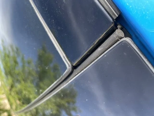

This is exactly the product I just installed over the weekend and achieved EXACTLY the same results. Wind noise wasn’t debilitating, but louder than any other car I’ve driven.
Pro-tip: use a solution of isopropyl alcohol and water to install the cord. Just enough slickness but flashes off cleanly without residue. Also used a plastic putty knife for spackle to help wedge it in. Had to be careful not to push too hard or else it gets wedged down in the gap.
If you use the foam cord in the original post, you wouldn't need to go through all these. The recommended foam cord compresses extremely well, and can be very easily installed without any tools or solutions.
I originally made the same mistake of using something different (although it has similar descriptions as the recommended one), and had to use tools and soap water. I strongly recommended that every one stick with the recommended product in original post.

Yes this product is also a compressible foam cord one specifically designed as a window/gasket seal. But this one has a rubber coating on outside for durability. Wanted 1/4” because my gap was bigger than OP.
With the alcohol it only took 15 min to install and was sold by Amazon so had it next day.

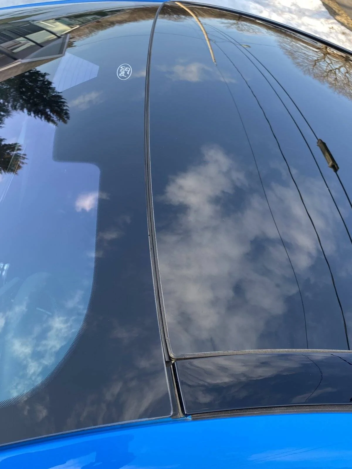

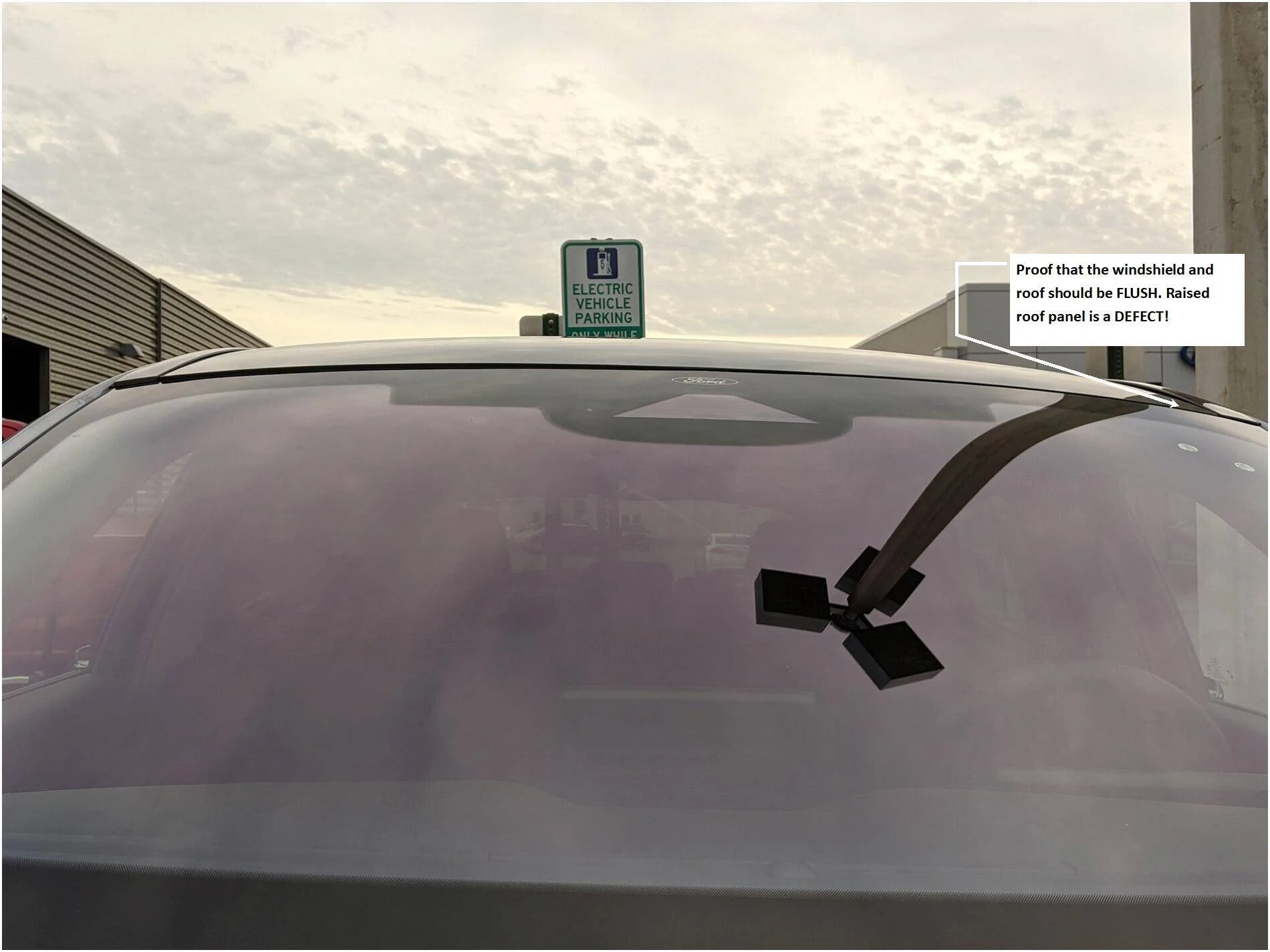

I think there is finally POSITIVE PROOF that a raised pano roof is a DEFECTIVE pano roof.
See this thread:
(1) Panoramic roof - Windshield misaligned! | Ford Mustang Mach-E Forum - MachEforum.com
As I stated there,
This, I believe, is positive proof that the roof should NOT protrude above the windshield - and any that do are DEFECTIVE. Take a look at that thread and you'll see many mentions of the noise problem and a few about the pano roof cracking because (being raised) it is susceptible to damage by small rock hits, etc.
See this thread:
As I stated there,
How does this photo prove anything? Mine looks the same and isn't loud. My previous vehicle looked the same and wasn't loud.

Looks to me like drivers side is flush and passenger side has roof slightly raised. I'm I seeing it wrong?
noflipping
MJ
Jun 26, 2020
184
271
Burbs of Detroit
Mach e Premium 4X, Focus Electric
It actually looks like the passenger side windshield may be set too deep. If the roof were set too high, you'd think it would have a mating issue with the bodywork (which does not seem to be the case from this pic). I've actually thought the issue with most pictures I've seen was the windshield being seated incorrectly - pushed in too far/unevenly.

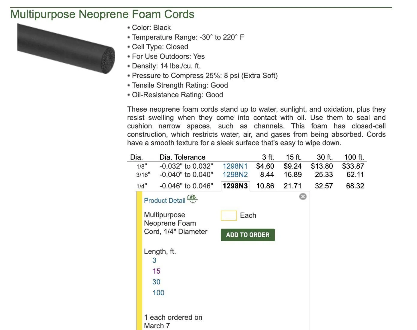

Wow, I did the fix today and the results are nothing short of stunning. I used .25" (USA Sealing, purchased from McMasterCarr) Neoprene Sponge Cord. Thank you @JSW!
After several difficult attempts, by different methods, I remembered the Tesla guy saying to use dish soap with a bit of water. That did the trick. I was able to just push it in guided by my thumbnail, which is a bit sore now. But, it just dropped right into place. I would say about 60% to 80% improvement for my car, which was not terrible to begin with. Wind noise was pronounced, just not as loud as others have reported. A bit of wind noise remains if you listen for it, but now road / tire noise is dominant.
One possible metric might be if we can find a tone or noise source that we can all play in a "sort of" calibrated way? So, just turn it up, watching the radio volume numbers until the sound matches or just masks the wind / road noise. Not sure if android auto and/or car play on different devices would allow for that kind of "gross" calibration between users?
Please provide a link to the product you used.

Info about types of foam cord: about foam

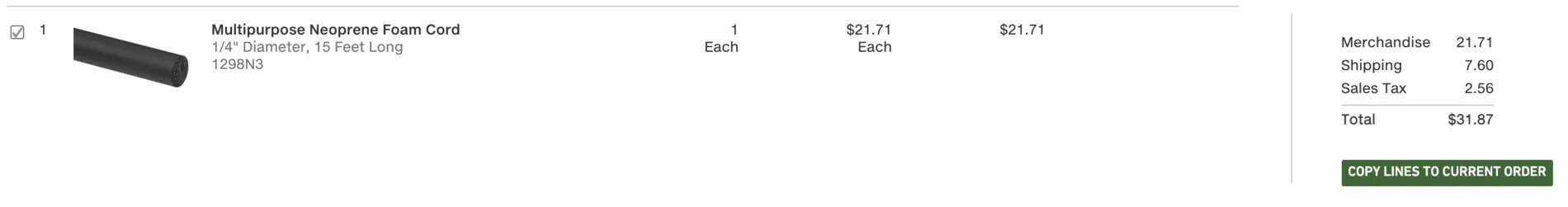

McMasterCarr catalog page
With shipping, it is certainly not the least expensive, but McMaster-Carr is an industrial supplier, so most if not all of the time, quality is expected.
I went to 1/4" based on JSW's original posts. For sure, dish soap is needed, but then I found installation easy. So far so good, it has not come out.
