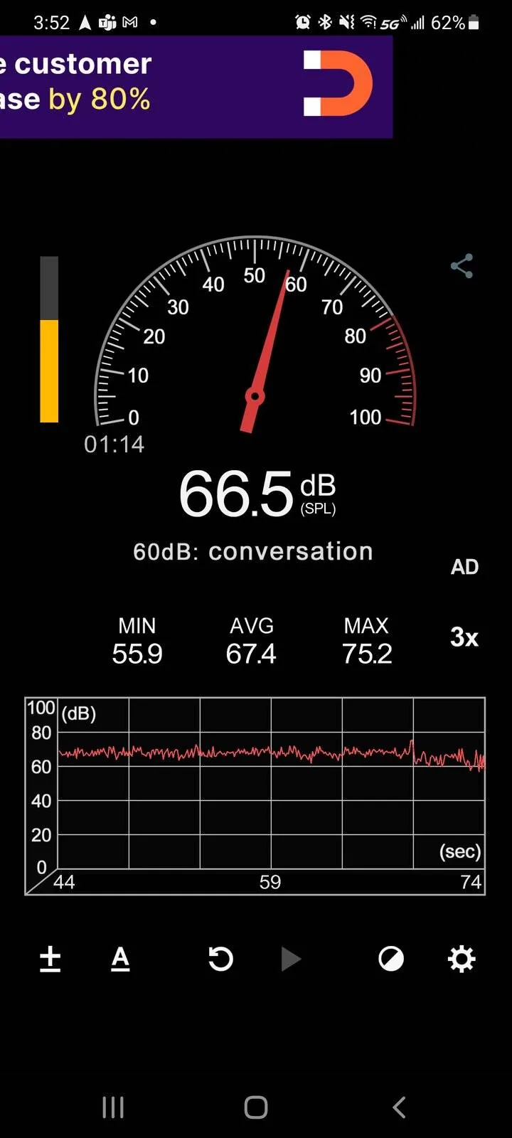

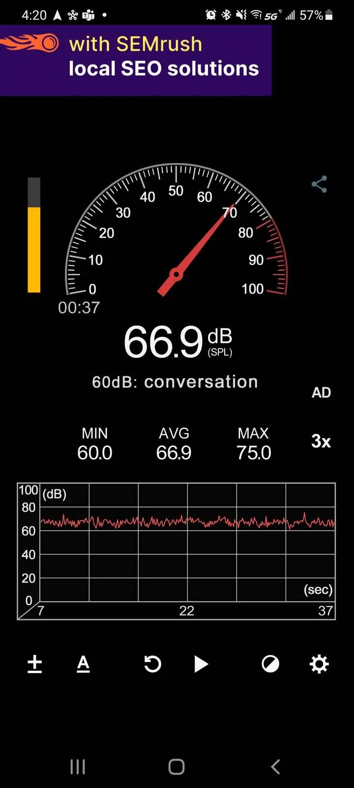

Well, I ordered some foam cord and it came in today. I took a drive on the highway next to my house and used a decibel meter app on my phone to track it. Then came back home, put the foam in, actually went all the way around the windshield with it. Then took it back out to the same spot on the highway.

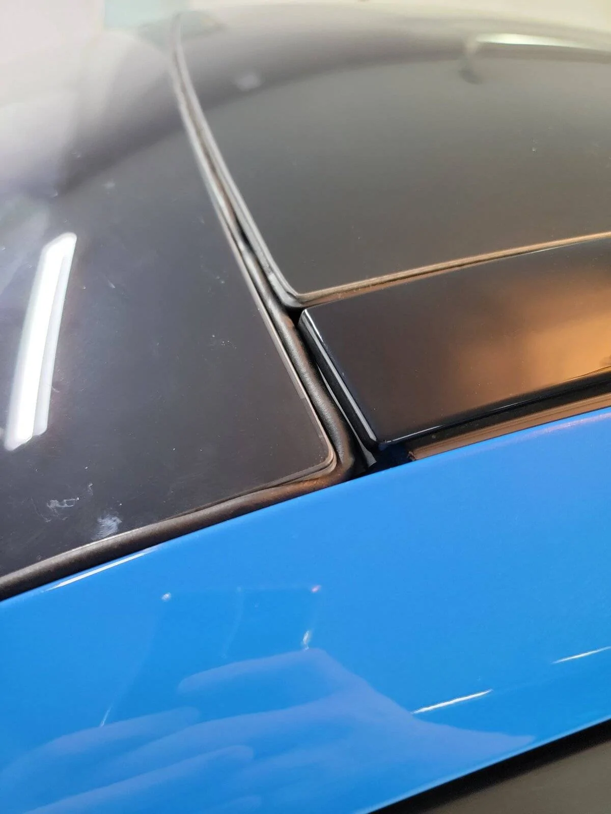

I actually thought it sounded worse with it in there for me. The biggest difference is that I feel like the sound is more localized to right and left top corner of the windshield, where that gap is considerably bigger. Before the foam you could hear wind noise all across the top of the windshield.
At low speeds, it did seem to be a little more quiet than before. But I didn't measure low speeds.
Before with no foam. Highway Speed (75mph)

After foam cord installation. Same mile section of Highway. (75mph)
