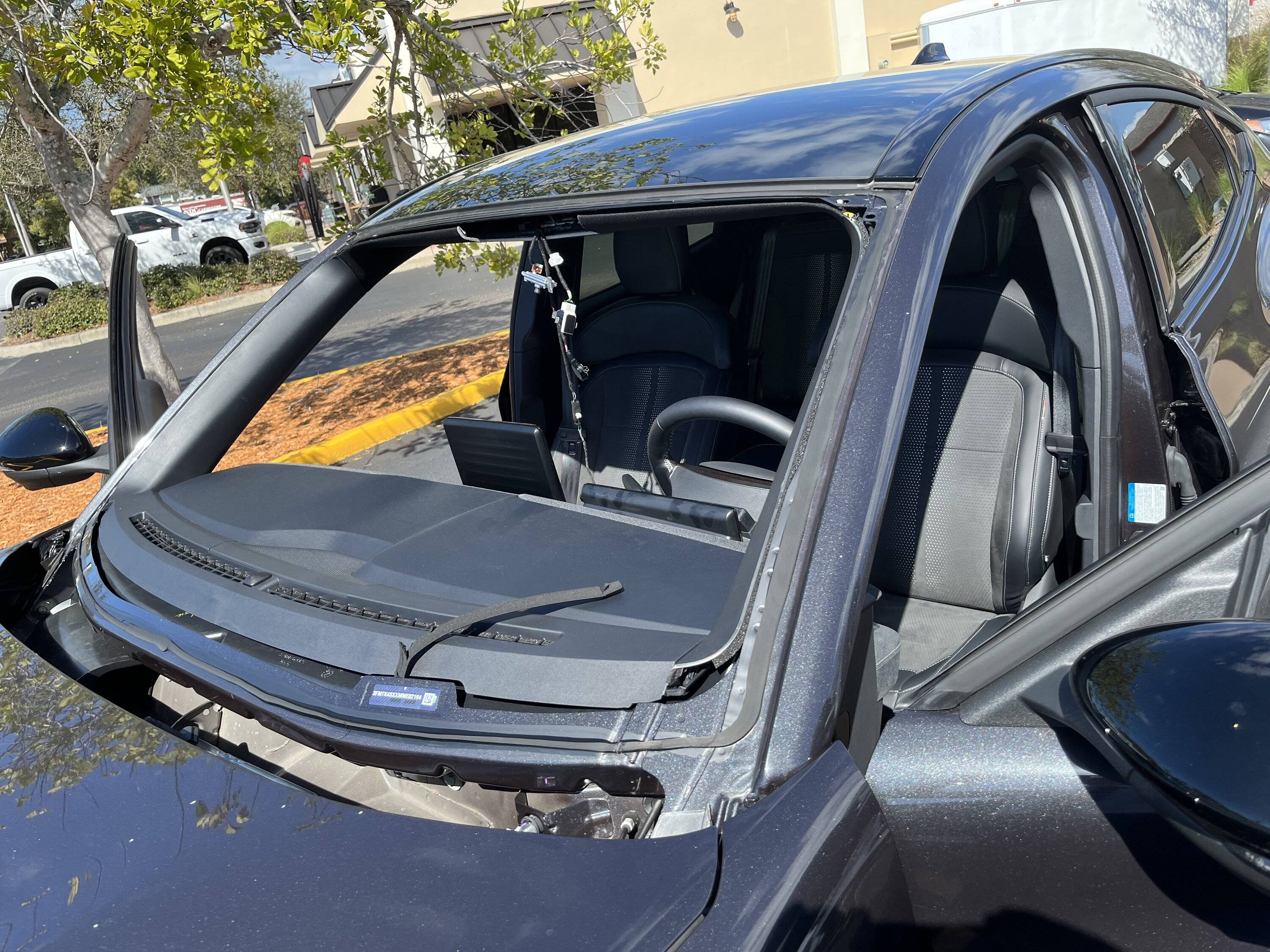

ANYWAY, to the point..... When a windshield is installed, there is an adhesive primer that is brushed on the part of the body that makes the windshield frame. After that, they lay down the windshield adhesive, like caulk out of a caulk gun.
When they removed the original windshield, they showed me that there was about a 2 inch area, near the bottom driver's side of the windshield, where there was no primer or adhesive. He suggested that there was likely some wind noise coming from that spot.
With the new windshield in.... Yes. I did notice that now there is less wind noise.

My wind noise went way down when my windshield was replaced as well.
Safelite showed my how uneven the gap at the top of the windshield was.
The new installed one was much more even.
Whoever installs the windshield in Mexico doesn’t seem to take too much time lining it up.
looking at the pics when they replaced mine, I did have adhesive all around:
