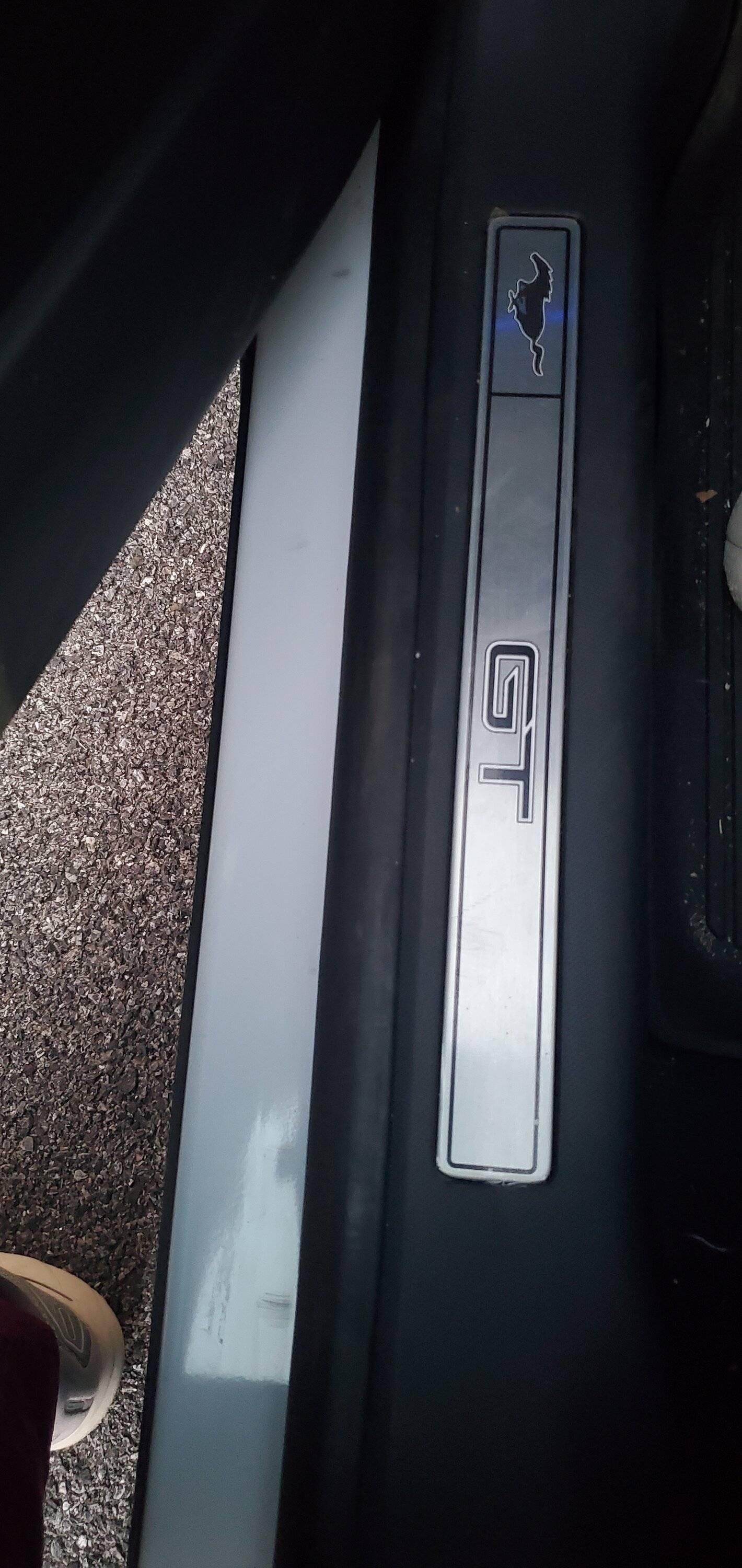

Update on the issue, so they replace the weather strip along the door, and told me they were replacing the piece along the panoramic roof too. The rubber piece along the panoramic roof is not on properly you can clear tell when you actually pay attention to it. All the did was fill in the gaps with adhesive. So long story short the problem did not get resolved and they scratched up the inside by the area where you get in and out of the car. I only noticed because the was a draft coming in from the bottom of the door.
So yeah it just got worst.
