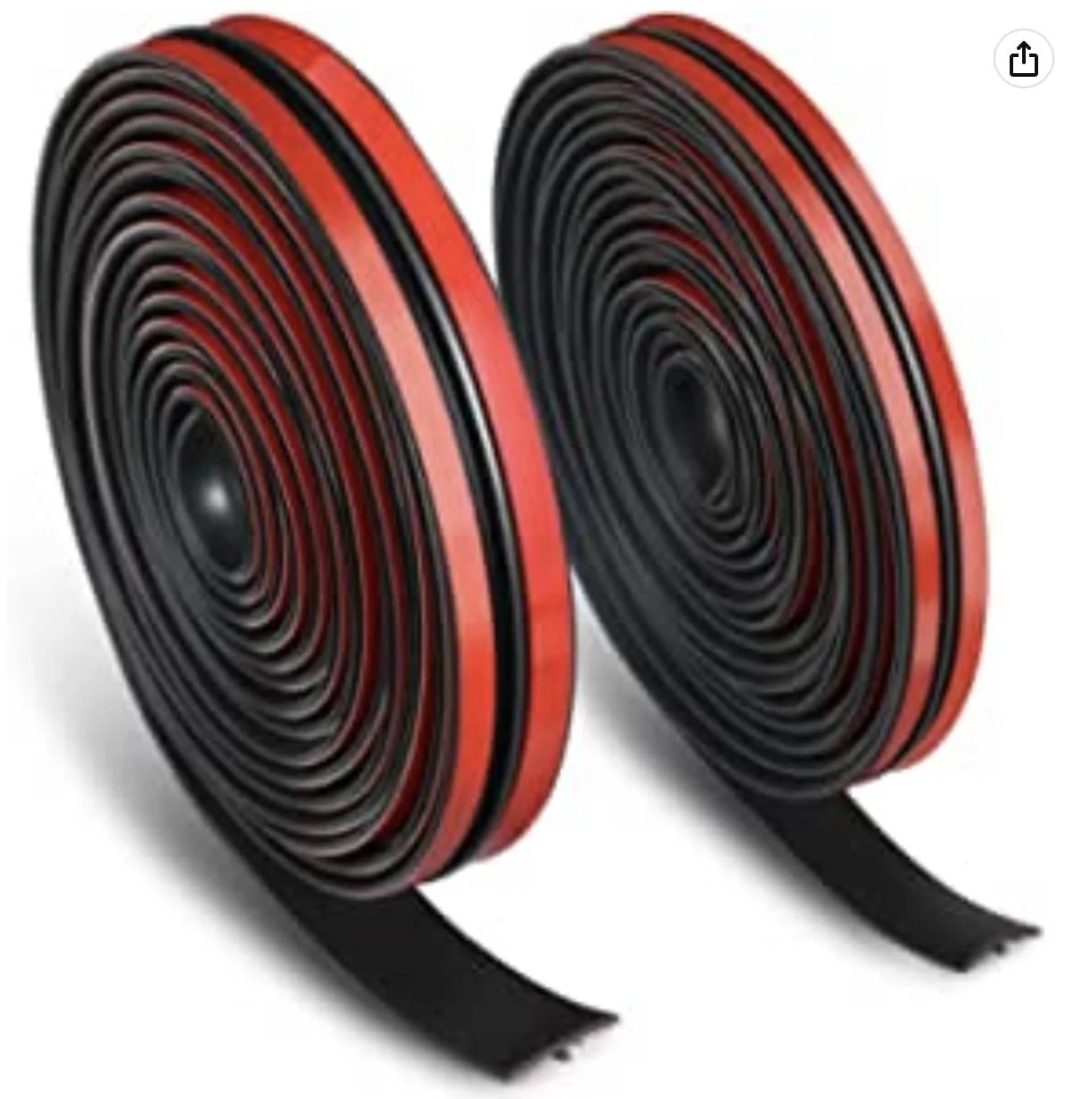

On my 2022 GT the wind noise was pretty bad at speeds north of 45 or so. I added this to cover the gap between the windshield and the pano roof and it helps quite a bit:
Ford Mustang Mach-E a little wind noise at 80 mph Screen Shot 2022-09-13 at 6.07.45 PM
