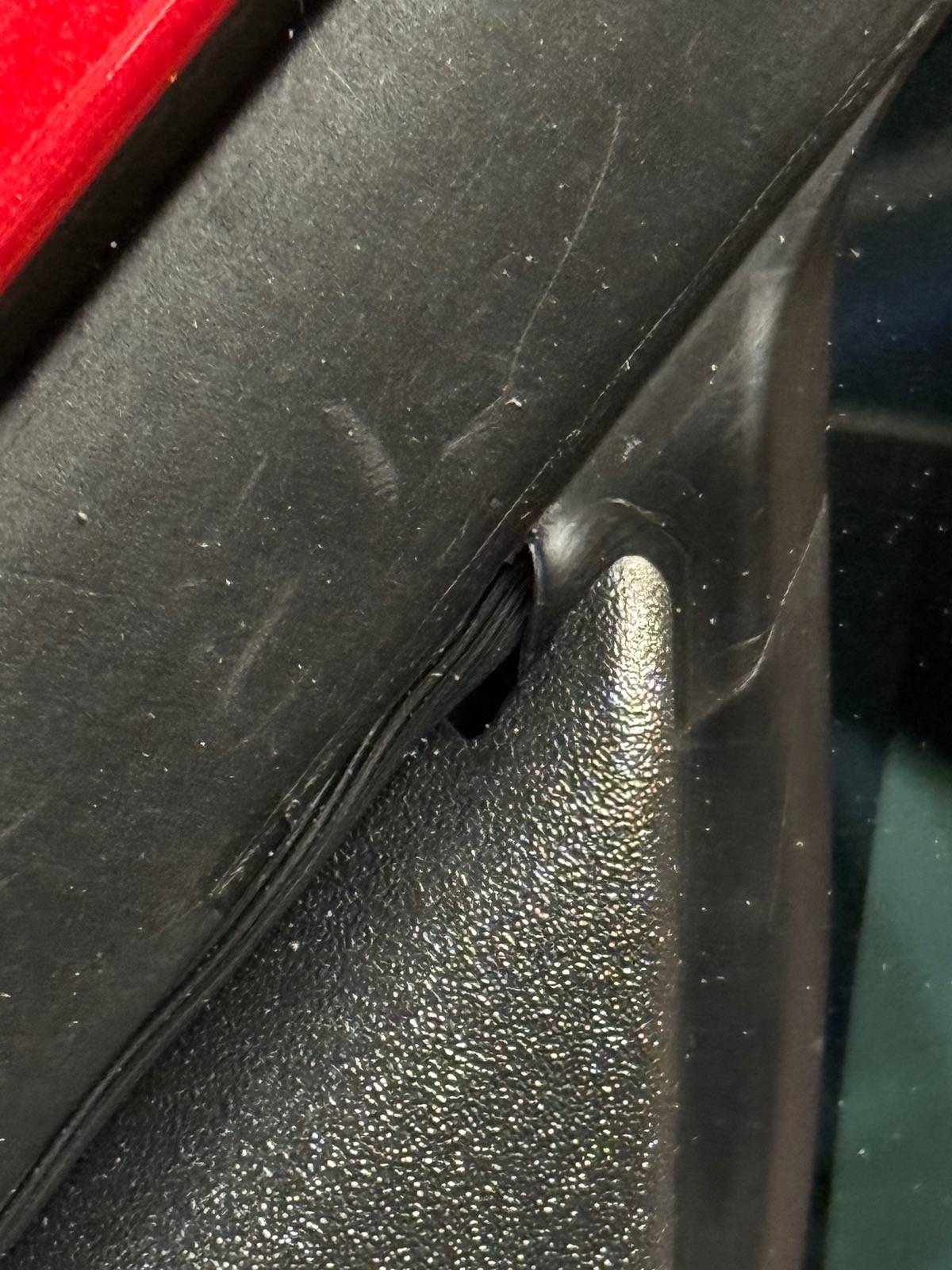

Sure thing. It looks MUCH cleaner than the big honkin' piece of rubber shoved in the mirror gap. I pushed a piece of the thicker spline fully into the gap (who knows if that does anything) then carefully pushed a piece of the thin spline into the gap. I then took a second identical piece of spline and wedged it VERY gently into the same gap, trying not to push the first thin piece out of the gap (in which case it would just be loose in the void behind the gap). It's very tempting to keep pushing on it to make it even or whatever, but try not to go nuts because it is easy to push it too far. I found that using a microfiber over my fingertip helped smooth it into the gap without pushing it too far. I would start with one piece of the thin spline before adding the second piece, as I'm sure every vehicle will have some variation in what it needs to reduce the wind noise.
So far it has withstood the carwash and wind noise has been resolved to my satisfaction. In the first pic below, you can see that I tucked the leading edge of the spline under the rubber lip at the top of the mirror. I used a little metal hook tool to lift it and then pushed it in (I didn't even realize until I looked at this pic that the spline is a little twisted!).

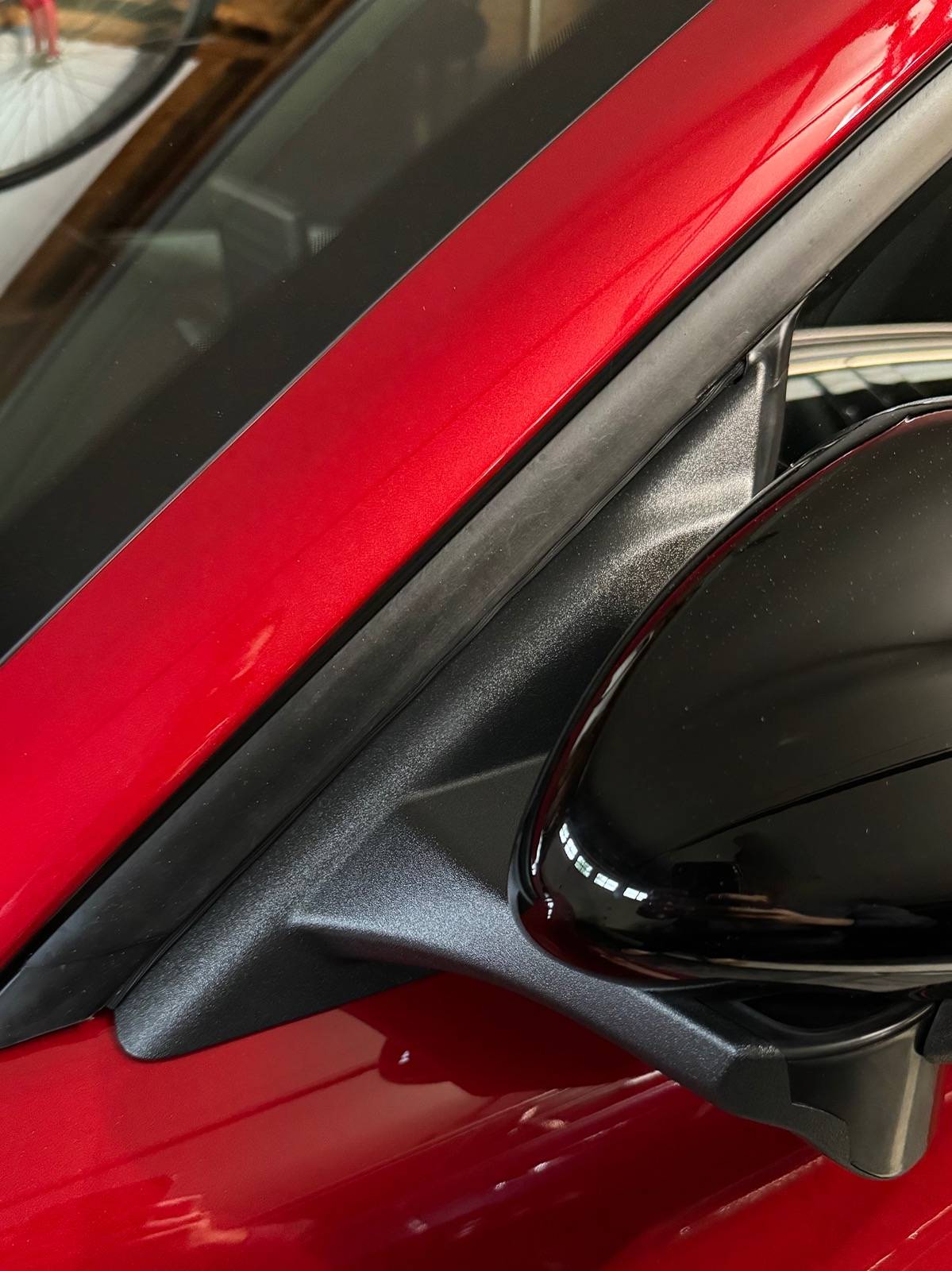

Had a bit of a eureka moment and I think I've found the perfect compromise solution between spline (which works just ok for noise) and the thick rubber strip, which works better but is ugly. I had some of this U-shaped rubber left over from an unrelated project and it hit me after a road trip (during which I was still hearing more wind noise than I should) that it might fit nicely into the mirror gap. And wow, not only is it a good fit but it works GREAT - ZERO noise - and it doesn't look like sh*t.
Amazon link
Ford Mustang Mach-E Side Mirror Wind Noise Fix IMG_4891
At the top end, I cut out a notch so that it would fit right up against the top corner piece, otherwise it's not possible to push the strip flush without leaving a gap. I found it helpful to use a bit of Shin Etsu seal conditioner as lubricant to slide the piece in and push it up against the top corner piece, but it's not necessary.
Ford Mustang Mach-E Side Mirror Wind Noise Fix IMG_4890
Amazon link
That came out great! Looks like the best DIY solution yet. Thanks for posting!

Been months and it’s been perfect. Hasn’t budged and no wind noise.

Thank you so much for this and the detailed photos! I have tried all of the fixes suggested on the forums and nothing has worked. I had the TSB done at the dealer, and that did not work. They have ordered a new door seal as their next step. However, I did this today with the same product from Amazon and it worked perfect. I cant hear the noise at all anymore! I might tell them not to replace the door seal.

Thank you for this! It has solved my issues, noise was greatly reduced. At least on the drivers side, hard to drive from the passenger side.
I had no trouble getting it into the crack on the drivers side, but the passenger side has a smaller gap. I decided to cut the rubber; removed one of the 'legs'. This left one piece of rubber to get into the crack. I didn't cut exactly in half, I left a little extra to make sure it was held tight. If it falls out I have several feet to try again.
