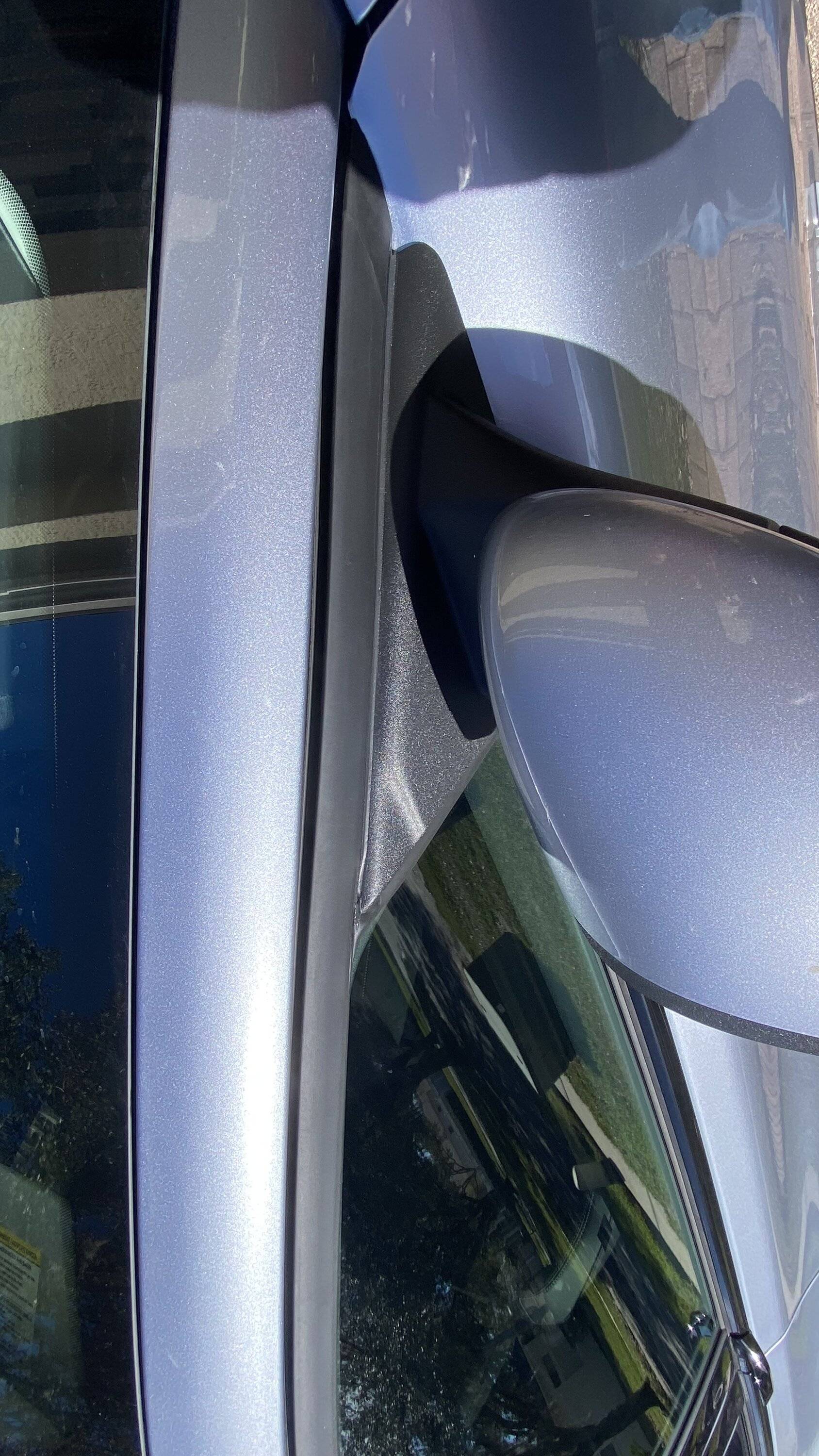

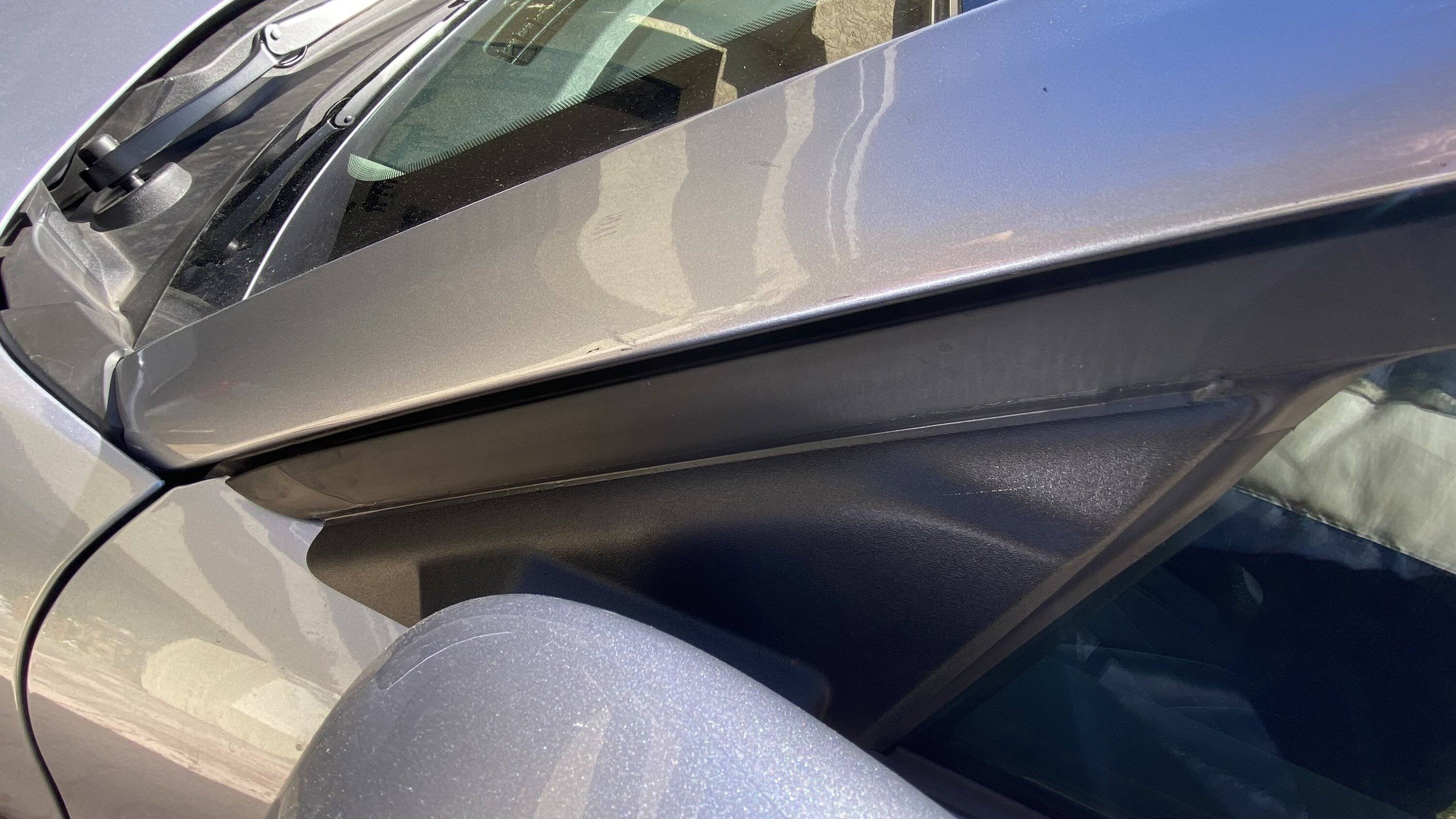

It looks like a big surgery. Not sure how well they can fix it. It all depends on how precise the individual tech manually cuts the foam I guess. I have done the caulking myself and I have afterwards heard very little wind noise even at 90 plus mph. I’m not going to bother pursuing the TSB, and, besides I can guarantee they wouldn’t hear any noise at the first place if I bring the car in for it.
Here is my DIY result.
Ford Mustang Mach-E TSB 24-2002 - Wind Noise From Side Mirror Area IMG_4928
Ford Mustang Mach-E TSB 24-2002 - Wind Noise From Side Mirror Area IMG_4927
