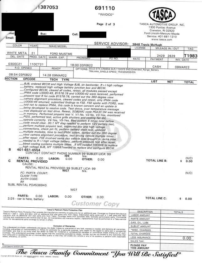

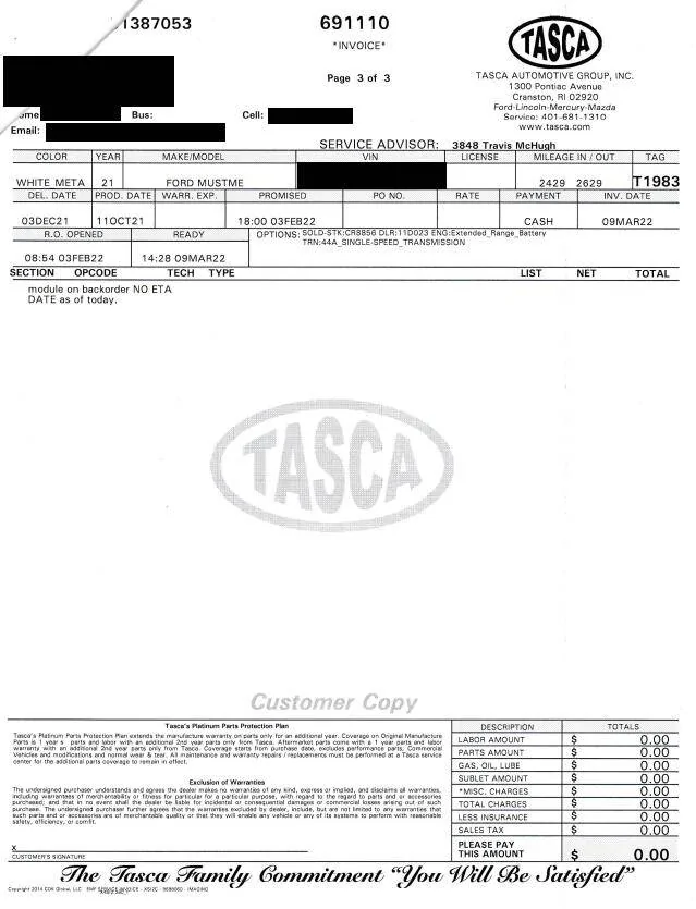

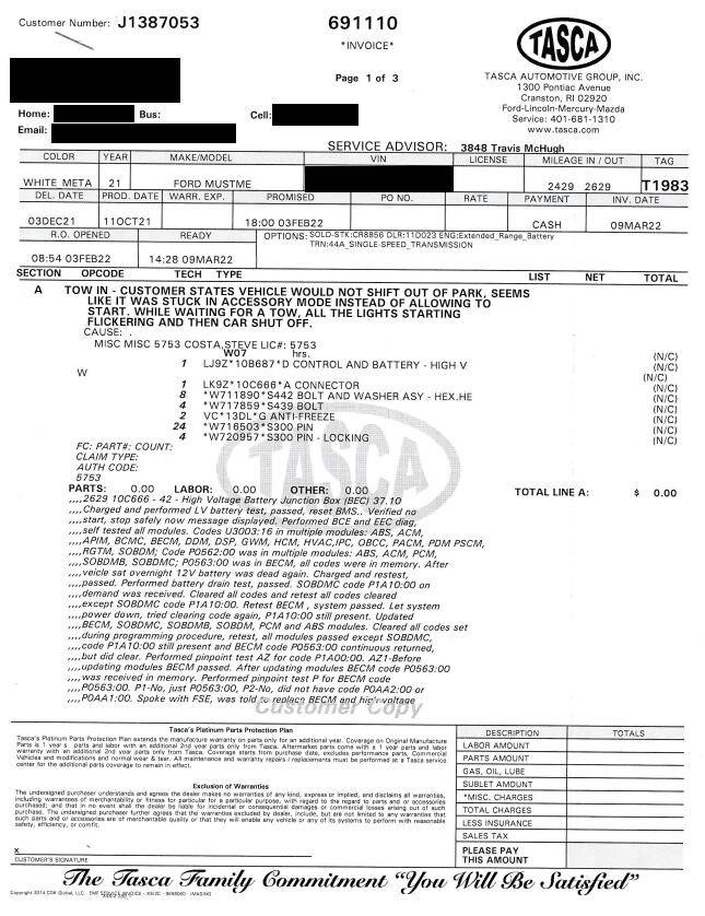

Ladies and gentlemen.....
She is back.
Just finished up today after 1 month and 7 days. This whole experience has been exhausting. So here is the write-up for you all to read.
