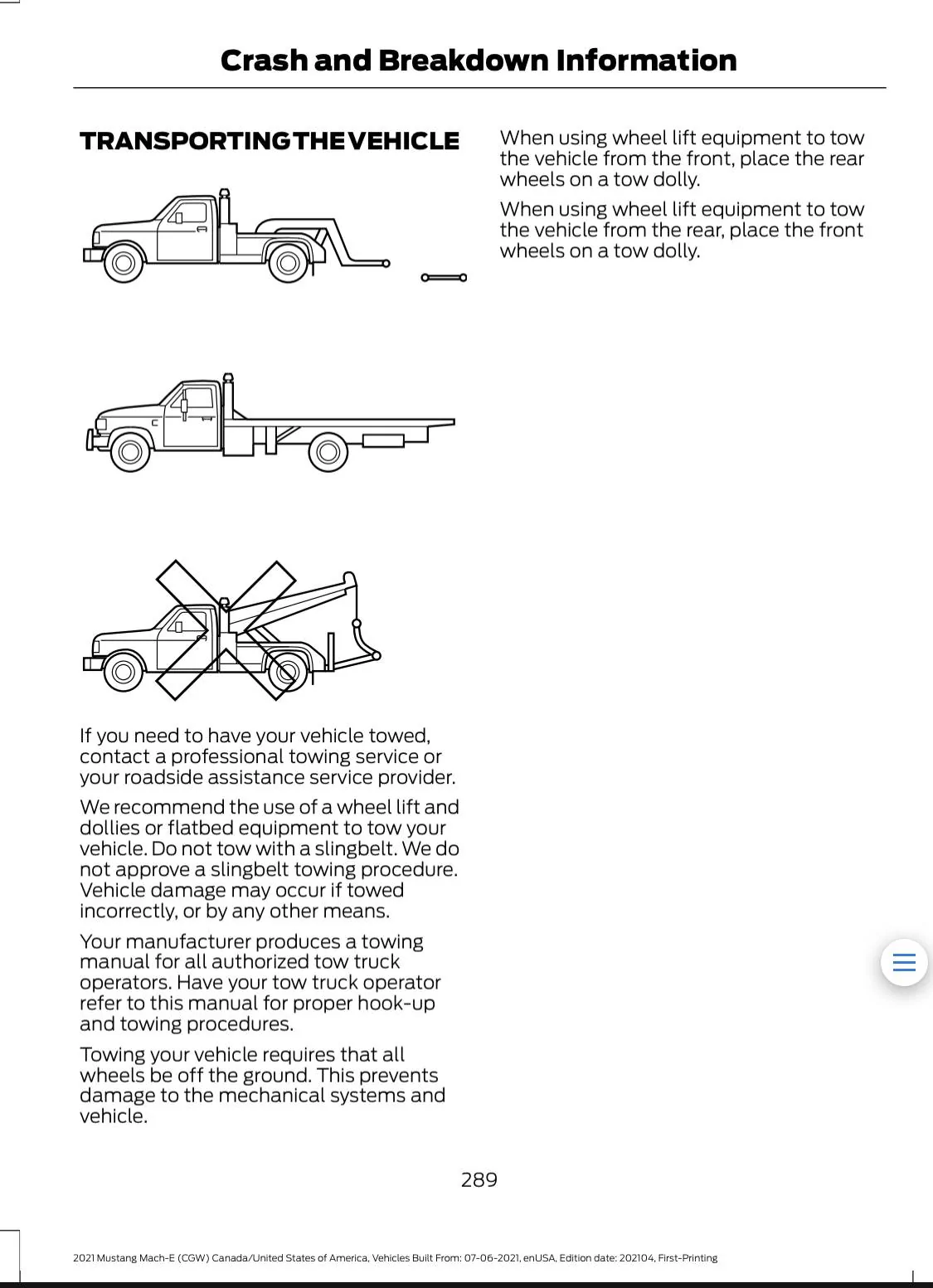

If the tow truck can’t get it jumped you can use tow dolly on the rear wheels and lift the front with a wheel lift per the manual. I wouldn’t let them drag it up a flat bed, if they dont have smaller dollies to pull it up I’d go to Harbor freight and buy my own.
