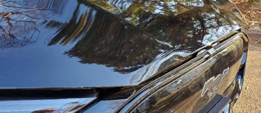

Ouch! I feel for you.
Just so you know, that's just a little over the estimate to repair getting the two support blocks for the rear load floor fixed if they get torn out. I overloaded mine, tore one of those plastic blocks off, and was quoted about $1k to fix it.
