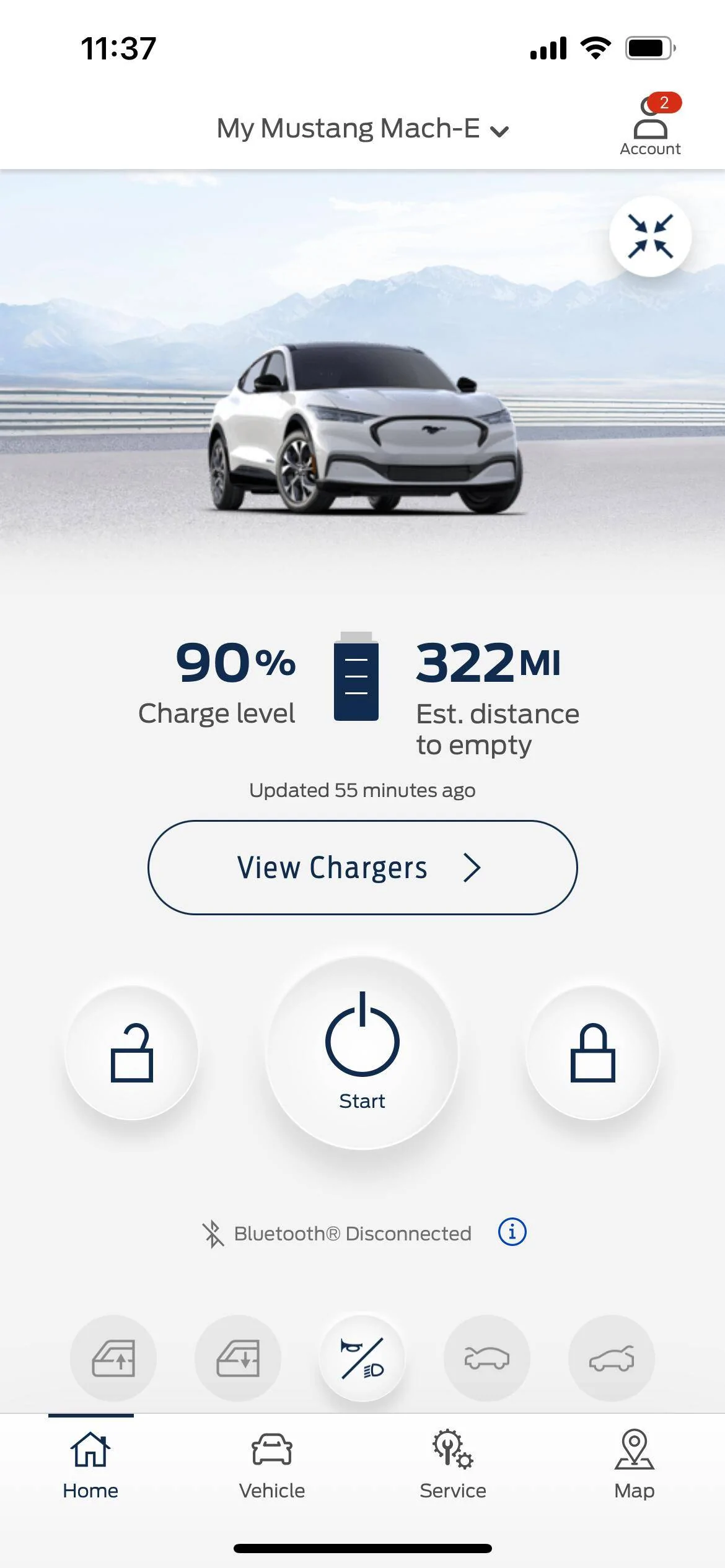

Pretty good range here in Florida. No hills or cold weather and A/C off this month.

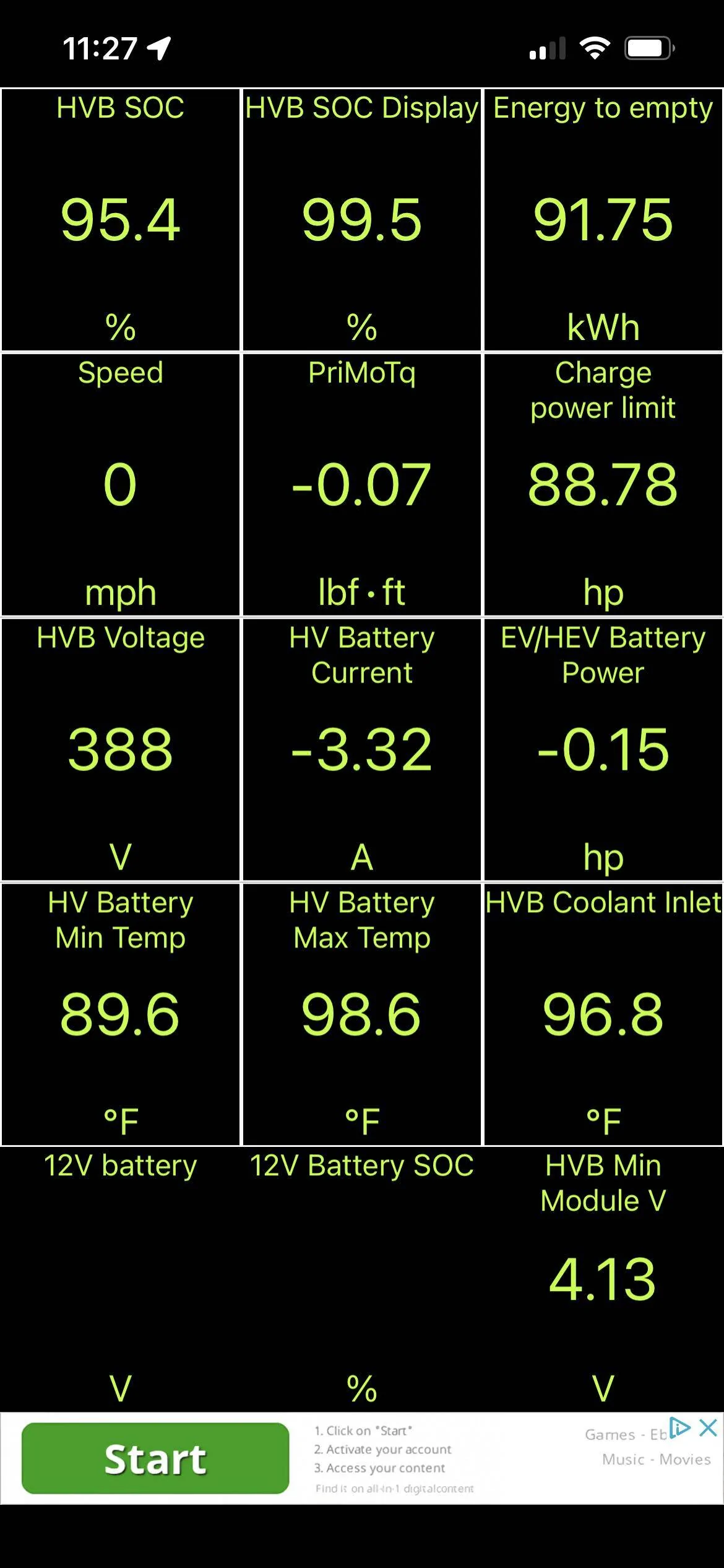

Mine shows 91.75 2021 job 2

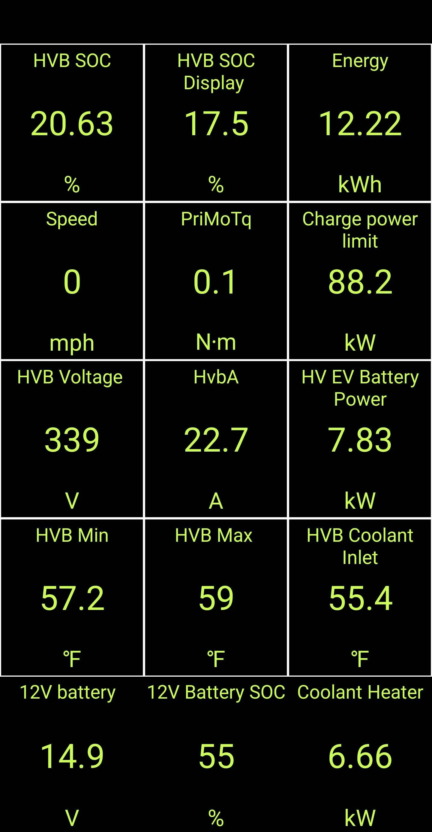

Could you share with me the OBDII code reader and phone app do you use for your MME? I need to buy one so I can see a similar chart to what you shared.

App is CarScanner.
Reader I use is OBDLink MX. It is no longer available, MX+ is, but it's pricey. There are others that work fine - https://amzn.to/4aNcd3B
Car scanner iOS software.
OBDLink MX+
