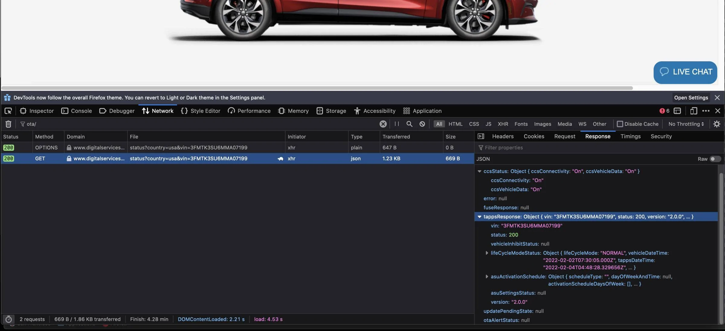

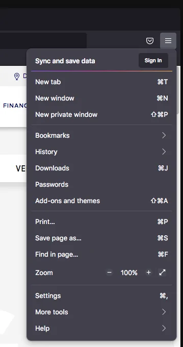

Start firefox and open the developer tools window by clicking the "hamburger"->more tools->web developer tools:

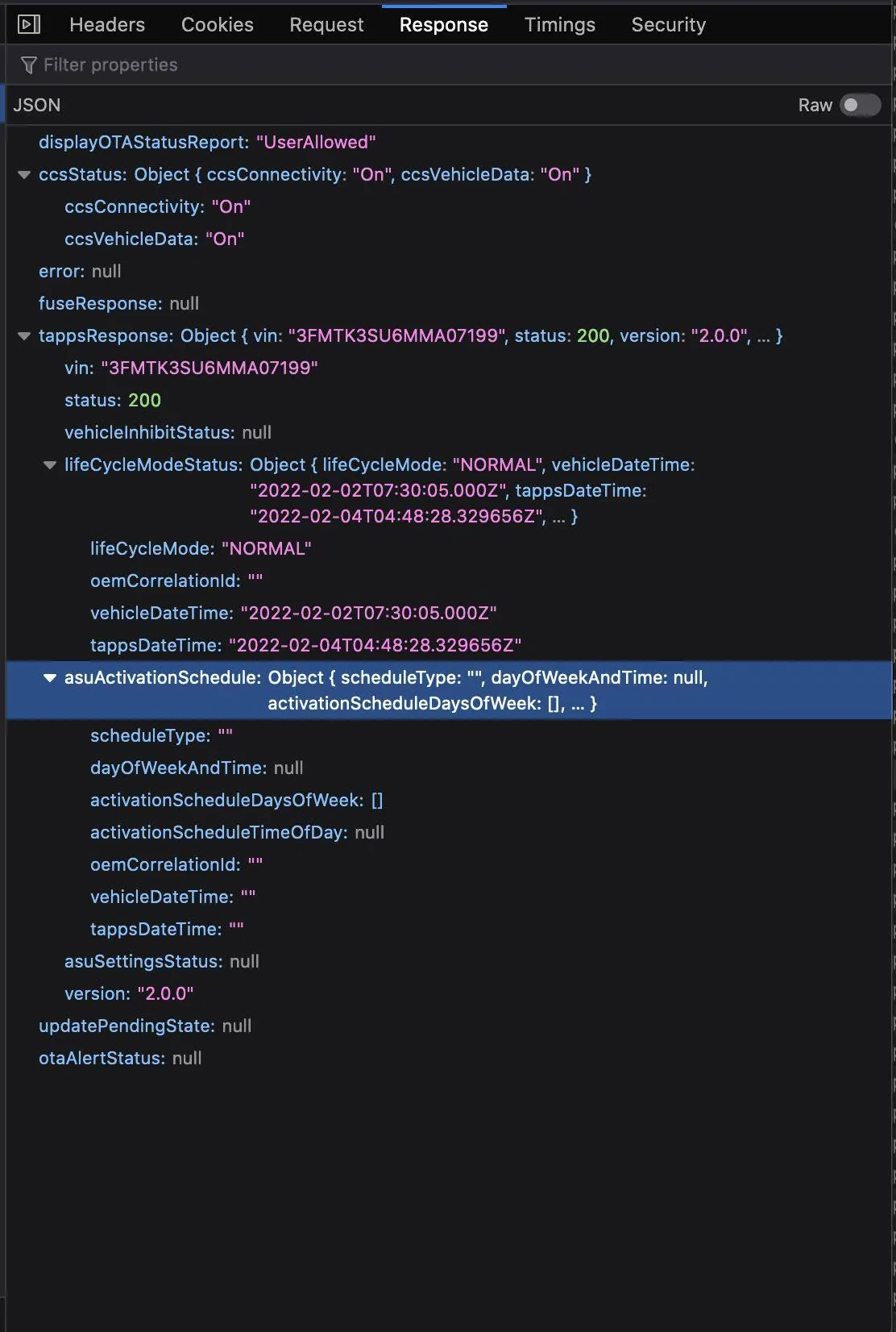

Thank you very much for this in depth tutorial.
I followed every step with mounting excitement.
Alas, another dead end. I'm starting to think this car will force me into every possible dead end before I sell it.
In my case the section that you say is supposed to reveal the latest update status does not exist. The sections around it are null where there should be content. Specifically, the activation schedule (which is impossible to set in my vehicle) is null, the error section is null, and the updatePendingState is also null.
(My Job 1 car won't allow me to turn auto updates on, won't allow me to set an update schedule, and won't show a version number in the vehicle, just says "your system is up to date" with no version number).
I've been to the dealership twice in 3 weeks and in both instances they claim to have updated the car as far as it will go and that all I have to do is connect to wifi with the car plugged in and I will get the OTA's. However, I have lost all hope that Ford can fix my car. Either I try FDRS to manually update it or I sell it at first opportunity.
