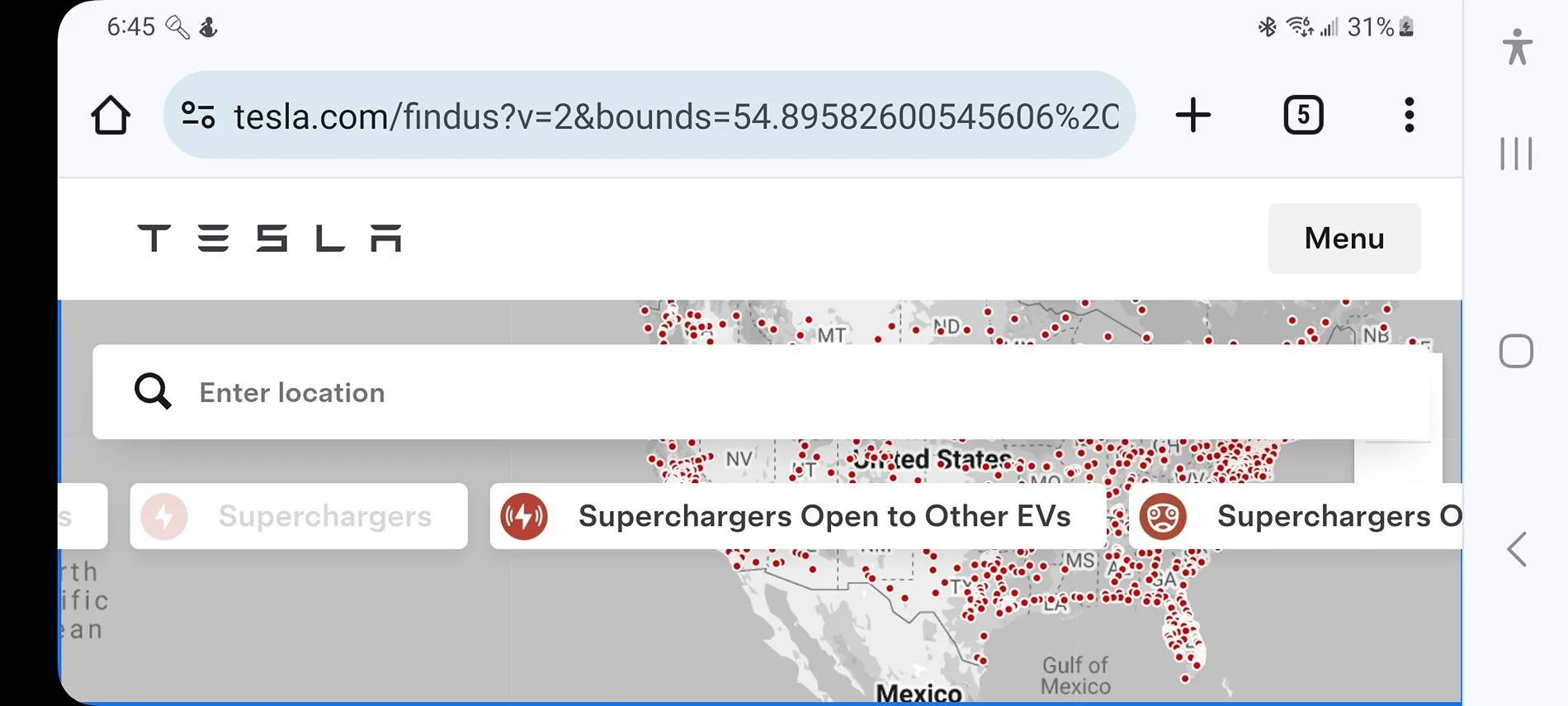

I kind of figured it out what has what but when I click on that link and it brings up just a map of the United States of the world or whatever where do you go to click on filters? I don’t see any menu if I click on the menu there’s nothing under there that says filters that I can tell.?

It's that row of boxes under the location search box. Click those on and off as desired.
On a phone screen, you'll need to drag that list left or right to see all the filter choices.
Ford Mustang Mach-E What did I do wrong on my road trip? Screenshot_20240828_184512_Chrom

Lol I got it. I was scrolling below that and the map was moving so I didn’t see those other categories. Thanks. I was looking for the word filter.

I select "Other EVs" and "NACS" (since I have an adapter) and zoom into my region of the country. Then I save that webpage as an icon on my phone, and drag it next to my Tesla app. Makes for a quick and easy reference for road trip planning.
