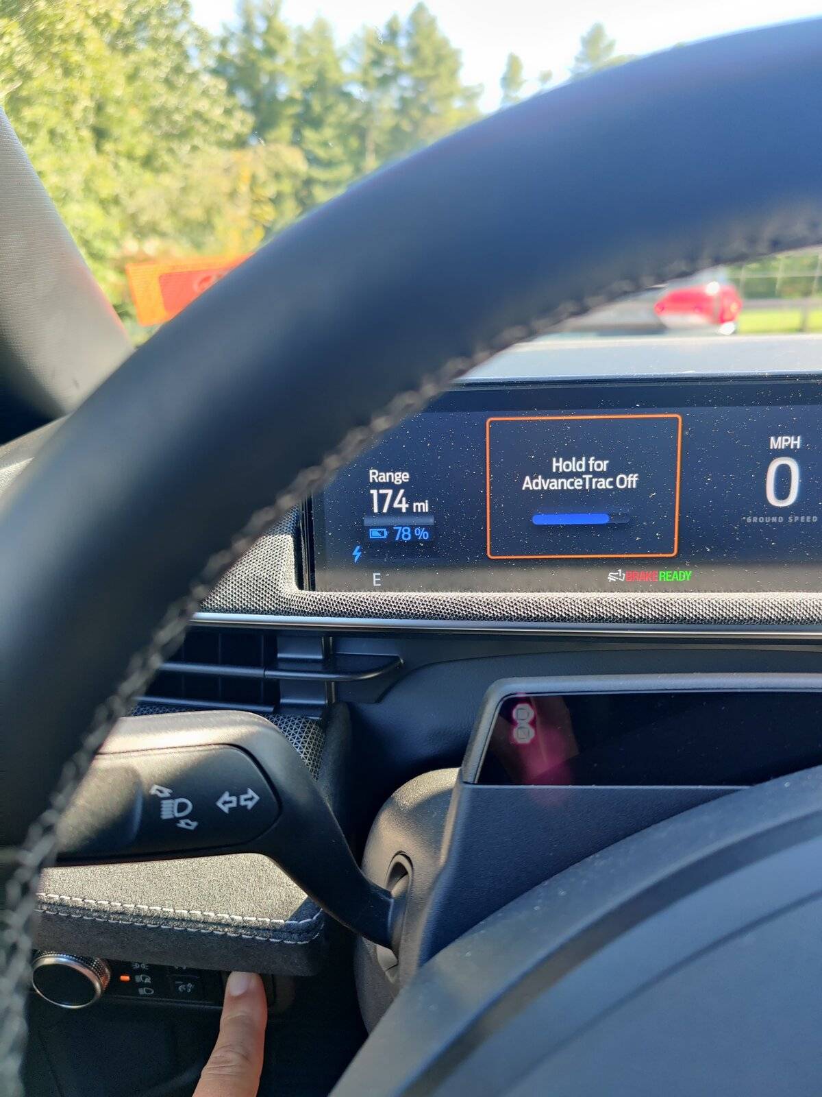

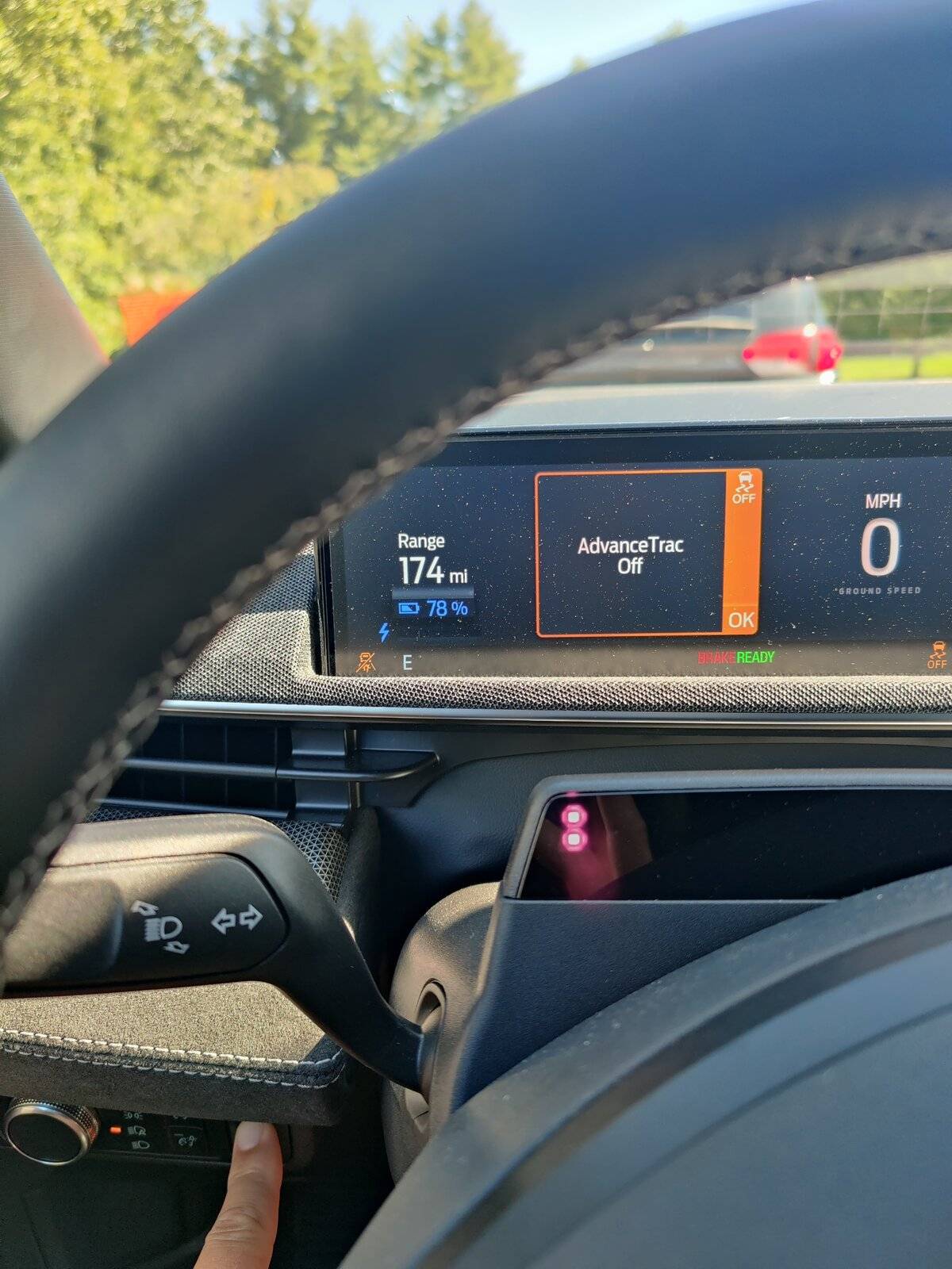

Parked, started vehicle, unbridled mode.
Ford Mustang Mach-E What I want for Mach-E Updates IMG_20210920_113831
Ford Mustang Mach-E What I want for Mach-E Updates IMG_20210920_113833

Page 202 on this owners manual printing it says you can switch off stability control now: https://www.fordservicecontent.com/...s-Manual-Job-2_version-1_om_EN-US_05_2021.pdf
