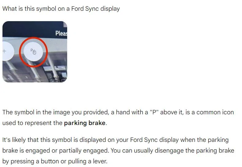

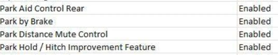

Solved: The mysterious hand went away when I disabled "Park Hold / Hitch Improvement Feature" in the APIM. Thanks all for an entertaining thread.
Original post:
It does not seem to do anything when I tap it, and I can't find any reference to it in the manual. Did I accidentally enable this in Forscan?
