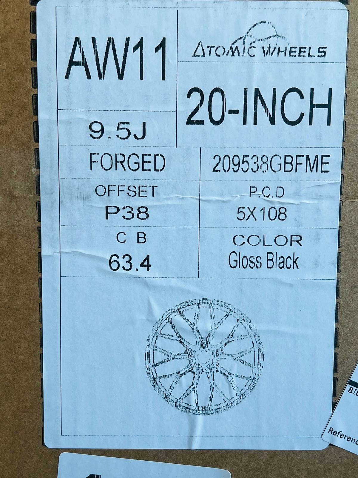

I’m another one using a similar setup to @markboris with 275/40R20 tires on 9.5” rims. I have a bit more than a credit card’s thickness between the tire bulge and the strut. ??
Ford Mustang Mach-E Wheel math IMG_4170
