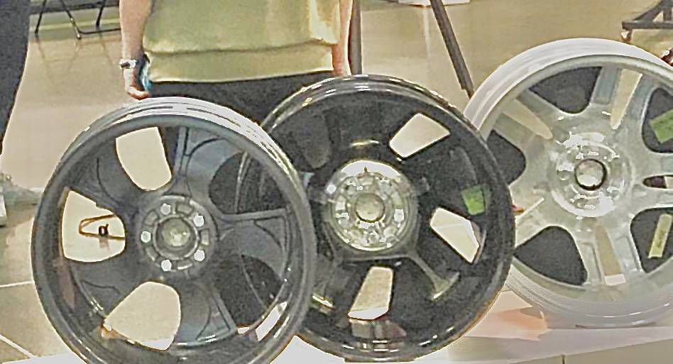

This is the only view I've ever found that gives some hint of what the CA Rt 1 wheel looks like.
Seems to be the second one from our left.
Ford Mustang Mach-E Wheel Sizes EnEWDz_XYAAJhNK
REALLY hard to see what's going on in there, but I'm thinking MAYBE it looks like this:
Yes, I've seen that shot from the back but it's really hard to tell the spoke pattern. If you have seen shots from the front side there is definitely a 5 spoke raised design on them, so I don't think the one above is it. Like you said it is really hard to tell. Almost anything has to be an improvement, as long as I can get a center cap for it.

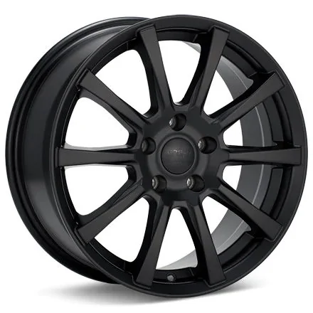

That wheel page shows offset 38-53... I'm wondering where they got those numbers. That's a fairly large range. I wouldn't be too sure yet that everything in that range will fit well. Sure, the wheel might bolt up, but if you put a 38mm offset wheel on a car designed for a 53mm offset you may end up with problems. Plus, you don't know what the load rating of the wheel needs to be. I randomly chose one of the wheels listed on that page and it had a load rating of 1600. No way will that be strong enough for an E. The wheel load is determined by taking 50% of the heaviest axle rating of the vehicle (GAWR – gross axle weight rating). Example; if your heaviest axle weight rating is 3800 lbs then your wheel load requirement would be 1900 lbs. I don't know what the GAWR of the E will be, but I'll bet the rear axle is rated higher than 3200 pounds, probably closer to 3800.
An offset of 15 mm represent 9/16 of an inch. Since Mach E GT will have 20'' x 8'' and Premium have 17'' X 7'', a wheel with 38 mm offset will fit. That will mean the exterior of the wheel will be about at the same location for a 18'' X 7'' than a 20'' X 8''.
This is why there a gap of 15 mm to accomodate the GT whelles.
