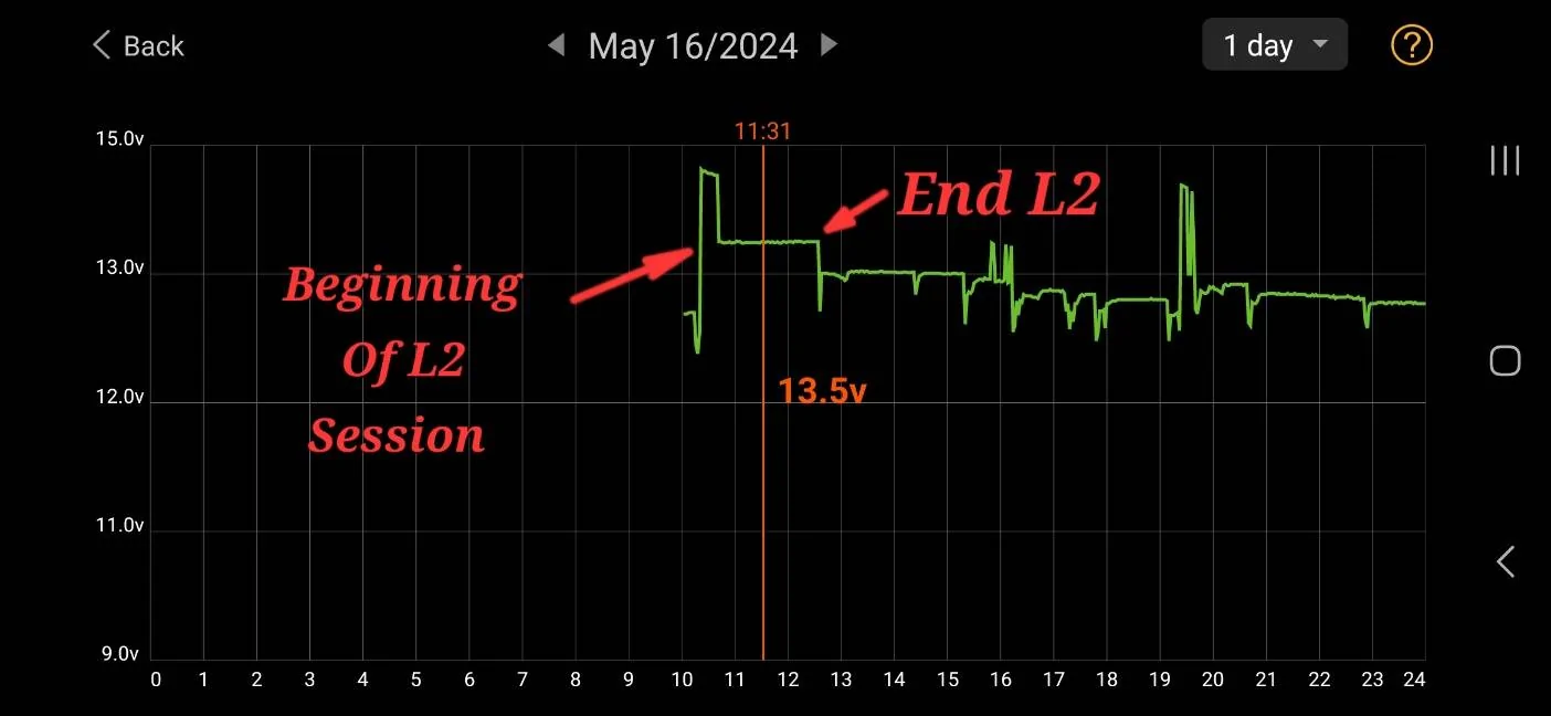

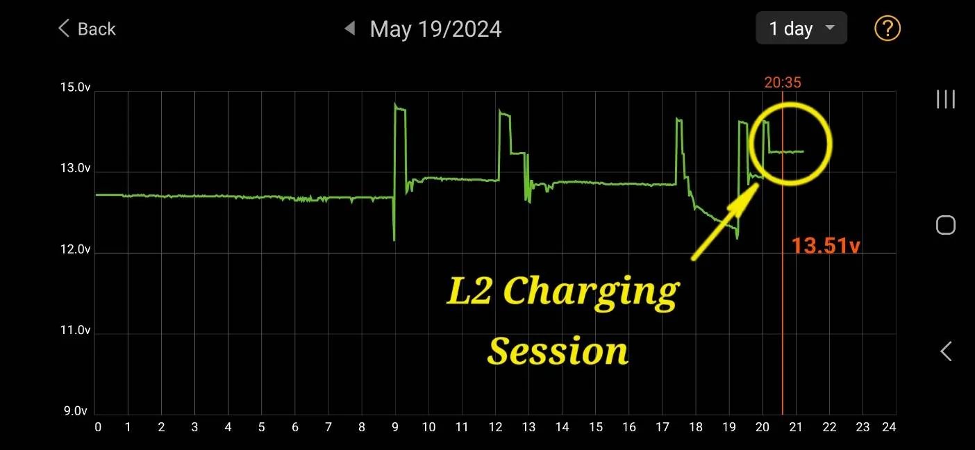

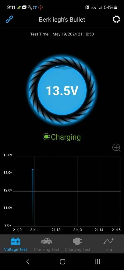

You can watch the 12v battery shoot to receiving 14+v charge as soon as your plug in (L1/L2) and then taper off around 13.5v until the car is fully charged.
Or stay at 13.5v forever if you have a bugged 23.
I kinda like the idea of the charger providing a trickle charge to the 12v…but still going to get the bug fixed.
