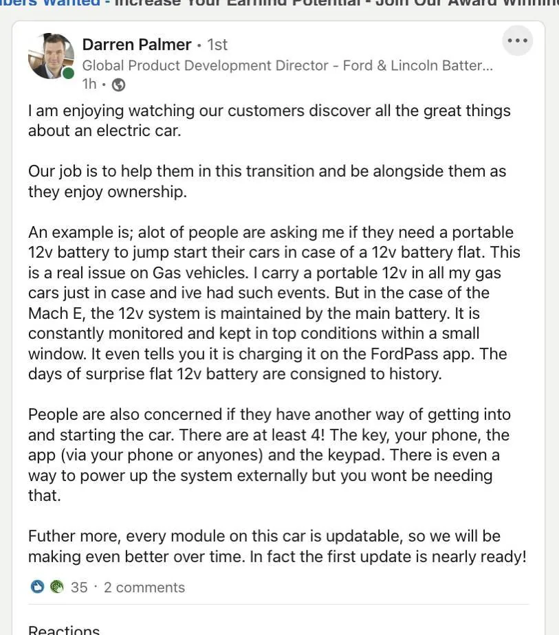

I’m confused. Why is this even necessary? I thought the days of surprise flat 12v battery are consigned to the past! Are you telling me that dead batteries, early and without warning, are a common issue?
Ford Mustang Mach-E Where to Keep Jump Starter? IMG_0048
88
12,941
17,389
I wouldn’t say it’s been common, but it’s becoming a common issue now that the batteries are getting to an age where they’re no longer serviceable for the 2021s. The main issue once the battery no longer holds a charge is that there is no mechanical entry into the car - it’s all electrical/electronic. That leaves us locked out unless we can power the electric frunk release and then power the 12V system *or* break a window to get in. ??
